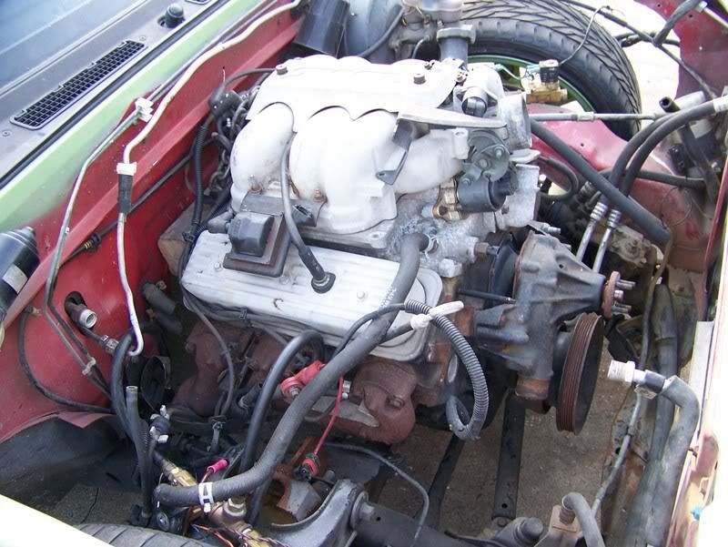

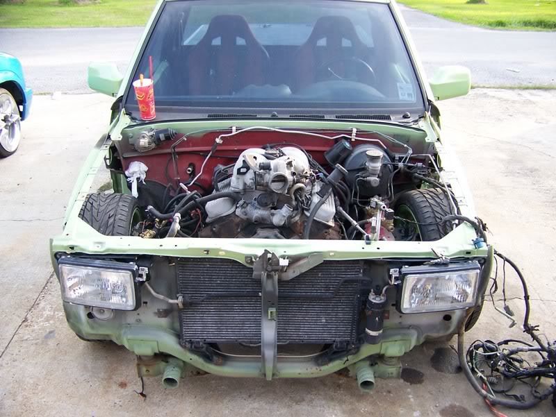

it fits really well and is actually an easier install than putting a 350 in a 82-93 s10 if you have minimal fabricating skills.

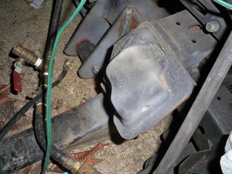

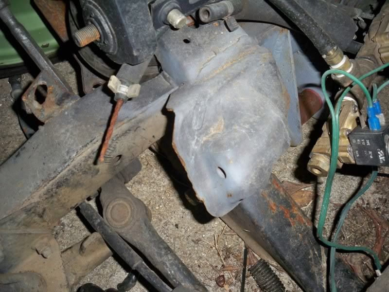

can you get better pics of what the mounts look like
eatinpavement
eatinpavement
heres another with inner fenders and accessories attached
