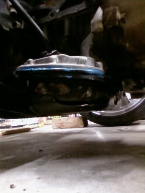

yeh i shortened mine bout an inch or more but if i was to do it all again id probably suggest a z notch in the front because then it will cut out the shortening of the sump engine x member and notching the lower arm if u run bigger then 19" wheels to lay frame.
but heres a pic of my sump shortened
