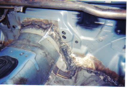

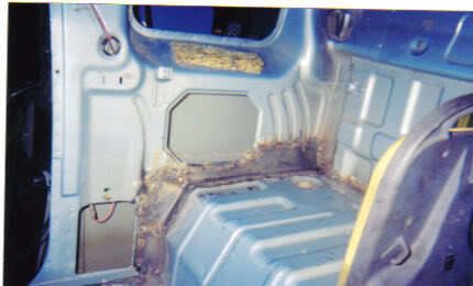

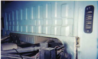

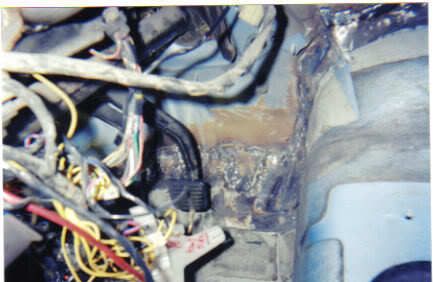

I hope some of this helps. Any questions just ask.
