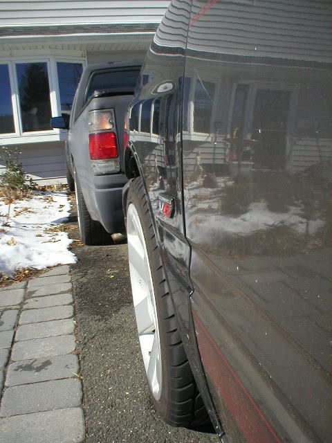

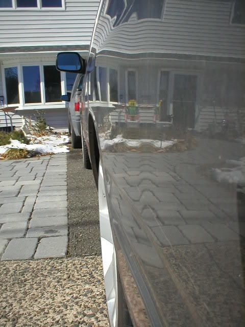

ive tucked 18x8s with 5" backspacing. used Nissan Titan 18"s with the 25mm offset (4" would be 0 offset, add 25mm offset (almost 1" more) gets you 5" bs) they BARELY tuck on the fronts, but the rears tuck nicely due to the rear track being narrowoer by 1/2" each side.

the reason behind the different tracks is that when in mud and snow the front and rear wheels cut their own track widths to prevent the rear axle from tracking in the fronts track. you can see in the pics i provided that the rears are much further in (it looks more extreme then it really is, its only 1/2" roughly) then the fronts...
