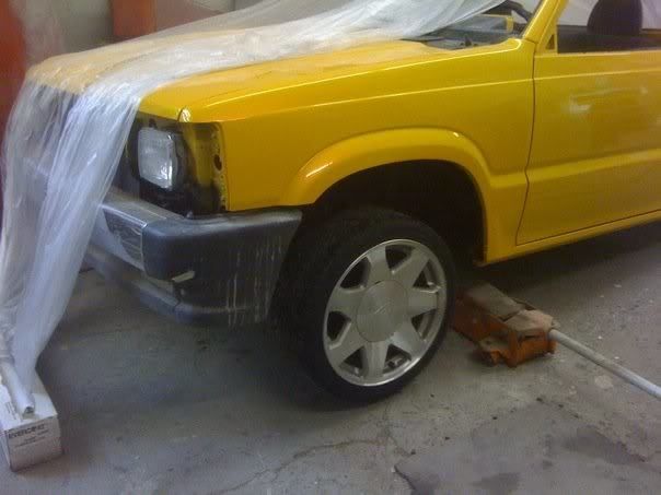

how do i get the escalade wheels or tahoe wheels on my truck will they just bolt right up??
90-b22dawg [andrew] avatar
90-b22dawg [andrew]
they will bolt up but the center hub on the truck is large in diameter then the hub hole in the rims. theres two ways to address that problem and you will quickly find out that some people will argue the fact of one way or the other to be the best way to do it, but in my personal experience the cheapest and easiest way to install escalade rims is to grind the hub tabs on the truck, only need a grinder, eye protection and a few extra lug nuts to protect the lug studs while your grinding the tabs
oldschool87 avatar
oldschool87
so what about the rear?? just grind the whole thing down? thanks, rob
90-b22dawg [andrew]
yep

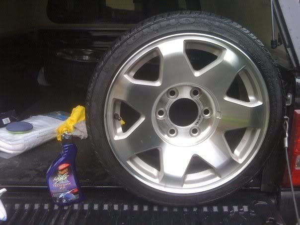

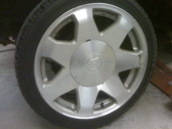

for my Tahoe and the new escalade rims i got i just had the centers machined larger to fit my hubs
most guys grind the little tabs on there hubs but i wouldn't roll with anything on my truck that wasnt meant to fit properly.
just back from the machine shop, gave them a fast polish
