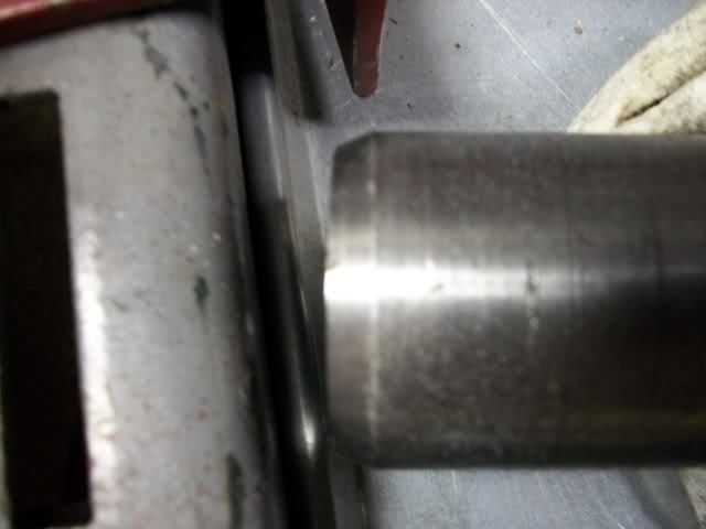

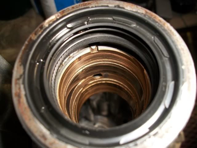

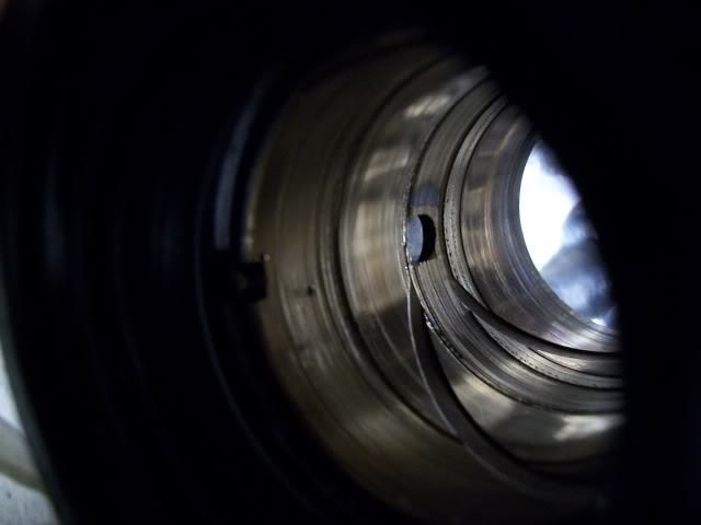

I figured I'd give somebody a lil heads up on some not so goodness. This could apply to all who have done motor swaps, plan onswaping or have had custom drivelines made. Make sure you look over your parts before you end up rebuilding a transmission or buying a new one.
I have a 87 b2200 with a 87 rx7 tII swap and here are the results of some semi crap machined parts. I plan on throwing this yoke in my lathe an rounding the front edge.
v tailshaft housing slip yoke float

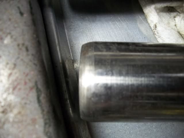

v conversion slip yoke
v orignal mazda slip yoke
