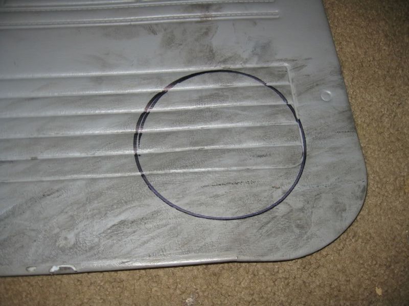

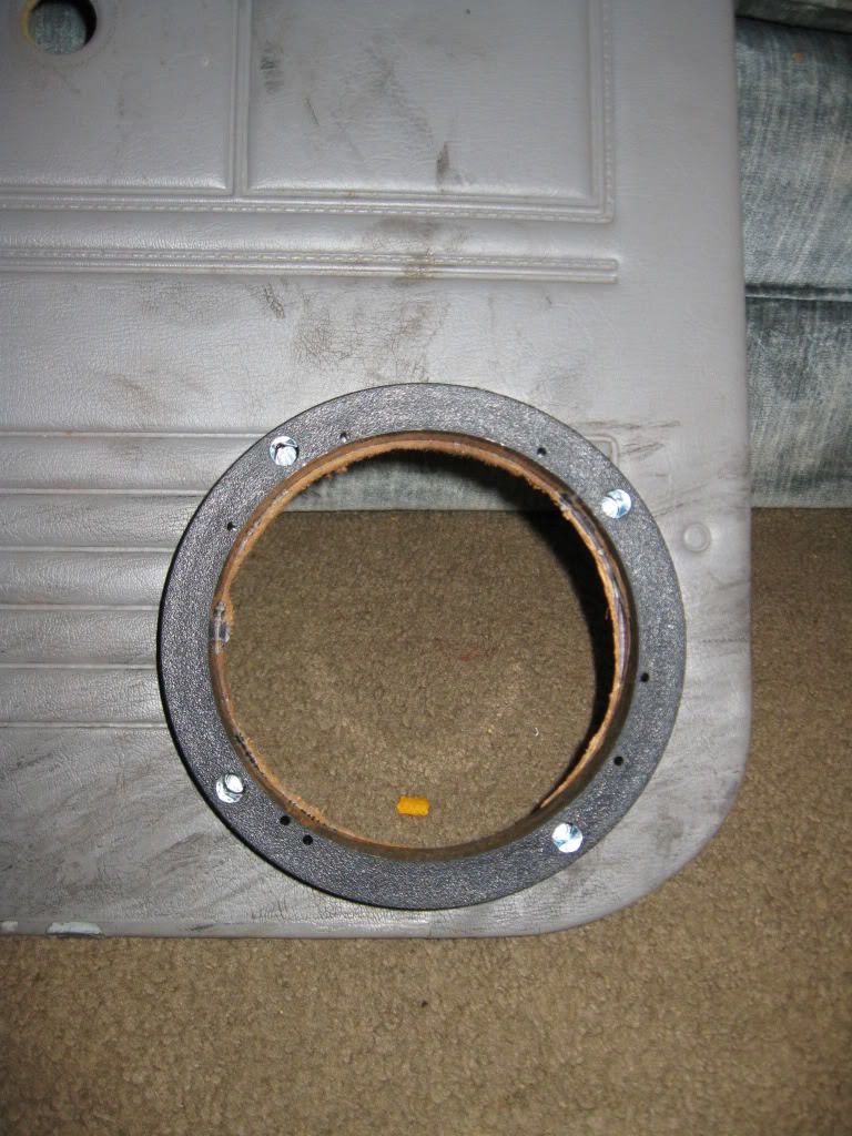

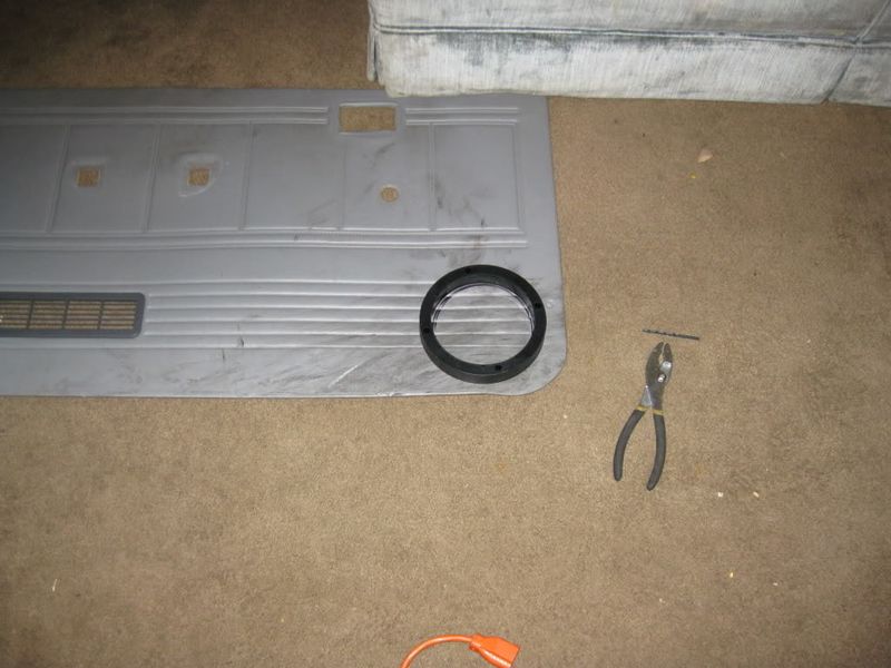

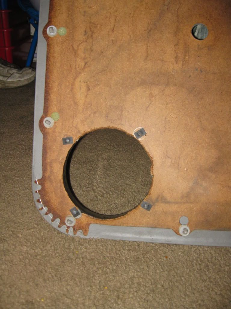

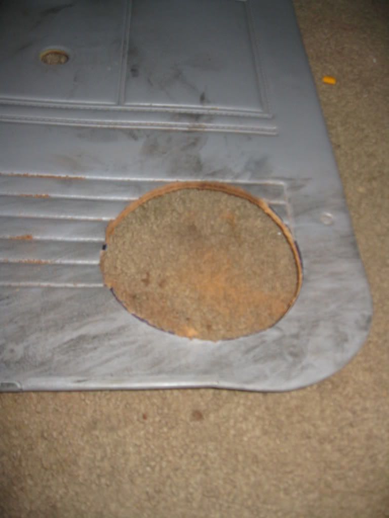

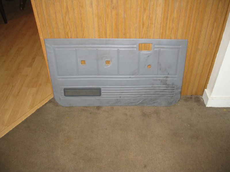

Well. i went out to best buy and scored a set of 6.5" mount's Figure i would do some audio upgrading. Here are some photo's i figure also the photo include give a good basic how to.. all you need is a Dermal or Lexan scissors
and some screws
Nice Chips huh? 2yr loves to eat his chips around the house.

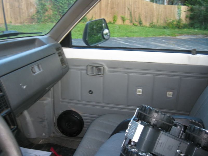

Forgot to add.
sosatheshark's avatar
sosatheshark

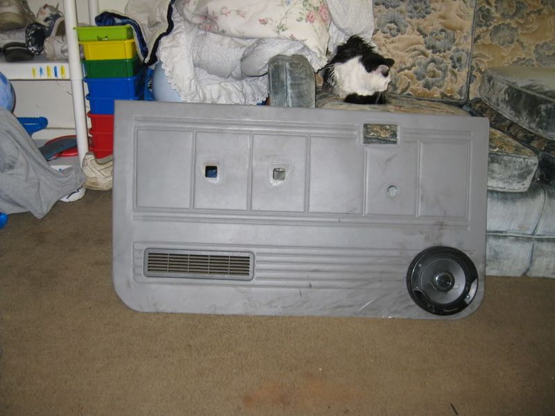

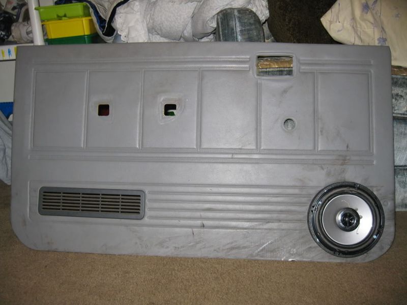

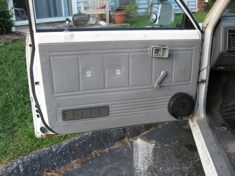

do you have the panels mounted yet?
farfegnugen's avatar
farfegnugen
Well they still hit the door metal. so i have to trim a little. so Technically no... you got any good ideas?
sosatheshark
well the metal hitting isnt a big concern ,its the magnet hitting the window ,most 6.5 are 2"-3"deep and on mazda panels ,its only like 1.5 -2 till the window ,so id double check that right after bro
farfegnugen
Thanks for the help i will look into that. the magnets seem to be small i hope i can clear it..
sosatheshark
hope it works out for you,that the reason why i have to angle most of the door panels i do ,or make some type of build out
farfegnugen
It turned out great. window goes up and down no problem.. im thinking of redoing it i don't like the bulkiness of it. but good enough for today.
