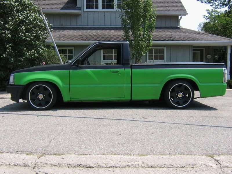

got my isuzu pup shocks in front, cut down my sway bar links, lowered the front down some more, monoleafed the rear. right now its just torsioned down front with monoleaf and 3 inch blocks in rear... i think i wanna get 4 inch blocks. i am gonna reindex my torsion bars tomorrow night my drivers side scrapes pulling up and down my driveway. love the look, back just needs to come lower

truck looks really good bro but I would just take my leaf pack in de-arch it and stay with the 3 inch block. running a truck with only a single leaf is not safe. the whole pack is made for the weight of the truck a single leaf can and will break.

yeah if you take the overload leaf (the thick one that was on the bottom of the leaf pack) and put it on top of your leaf you have now, it will be stronger and will give you the few extra inches you need. then your next purchase should be some air shocks to help the ride quality and give you some adjustability.

oh and by the way, truck looks good man. i really like red and those wheels are a great size on that truck. really fills the wheel wells up nicely. the smoked lights looks cool too.

so i put the helper above the leaf? i thought i kept it under it? i guess i will be switching that tonight... and will be re indexing the torsions tonight hopefully if all goes well... back comes first, i have only scraped once out on the roads with my drivers side.. i just cant see myself bringing it back up any, looks to damn good.. haha...

Looks really good man. Sits alot like mine did.

Sweet. I think your good as is, unless your notched. Is the axel on the frame now? I doubt a 4" block will get you any lower.
