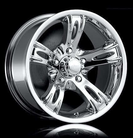

Here's the wheels I'm planning on getting, and putting some 225/55/16 rubber on them. I'm not into the huge oversized wheels, especially since my car already has 17"s and last time I bought tires it was almost $800. Don't get me wrong, I like the look of them, but they're just not for me. Besides, I'd rather get the extra inch or two in static drop without having to notch anything.

hey love the ideas but those wheels wont work unless they are available in a six lug pattern. or you can swap the rearend and front hubs out of a toyota. whatever you decide have fun with it remember its your truck right.

The wheels are available in 6x5.5, but they're 16x8, and i'm still worried about them tucking. The backspacing is 4 7/8 with +10 offset. Lowzone explained alot to me, but I cant wrap my head around it to understand it. I guess when it comes to it, I'll have to order the wheels from somewhere with a nice return policy.
