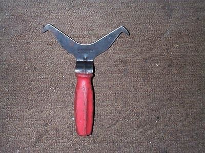

idminitrucker (jason)
they make a special tool for it. I have one and it works great. they make a couple differnt ones. but what you do is stick one of the points under the moulding and slide it till you hit the clip then hook the clip with the point and lightly pry it out and it will relase the moulding from the clip. the mouldings around the doors you have to start by the mirrors and pry it up from the bottom kinda rolling it off of the pinch weld and work you way to the top. where it is rolled by the roof it is a little harder to get off. and the part around the ext cab windows is bolted on you have to pull the interior out to get to the nuts. and there is a plastic clip at the very bottom by the door.

baddawg253
go to shucks and get a pry tool its a red handle one same kind youd use for door pannels just pry strait up ull probly need some uriethane to hole the chromes down (im a auto glass installer) and useuall ill put the clips on the chromes and dab a lil thane in the clip nubs on the body and then tape the moulding down over night .
