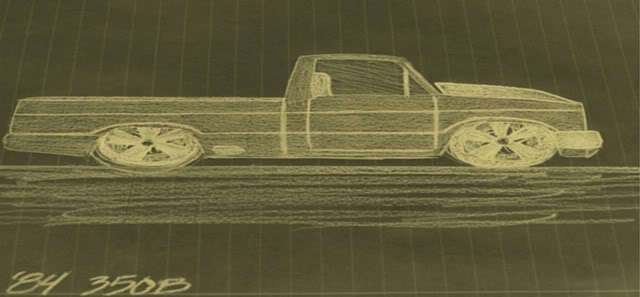

i want to build a pre-2000 road racer, either a 302 for easier fit, but i'd rather have a 350 to go along with the name(350B)
still figuring the specs, for the front and rear susp. i want it low but not layin and tuckin 17"-18" with low pros and still be able to turn lock to lock
i want to try and set up a totally custom front frame to optimize the geometry, with coilovers and adj. control arms.
this truck could hawl balls, so small and light
heres my close sketch, cowl'd, and exhaust pours out the bed

you'd need to raise your fender openings to get any sort of low like i'm imagining your talking about. and remember just cuz it's light with a big motor doesn't mean it'll be fast. its going to be a burn out machine, and likely oversteer because of the added weight up front. you could move the firewall back and set the motor way back to help balance out the chassis. adjustable coils are a good idea on all 4 corners, with an adjustable 4link in the rear. could be a cool project tho.

totally, if i got that into it i'd definitly balance the weight. put as much as i could into the bed(battery, fuel cell, and yadda yadda yadda) i just need to find a pre!

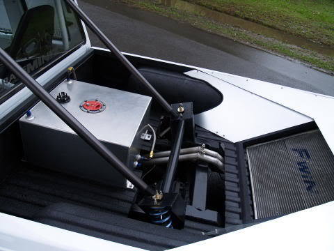

looks like theres planny room to move a motor back with a shelf like this...

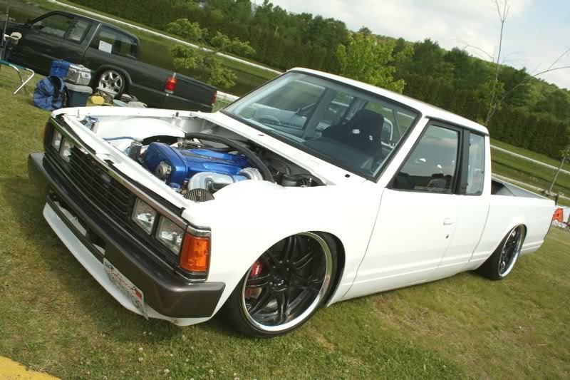

thats definitely not a mazda truck... im guessing nissan with either a rb25 or rb26 in it... very clean. i know that thing is fast...would just hook up like crazy if it was AWD too...
