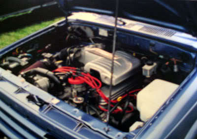

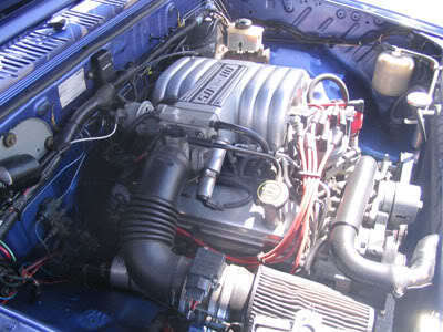

here is my truck build i have a 302 with a c4 auto tranny 8 inch rear.
