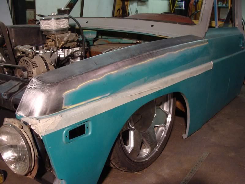

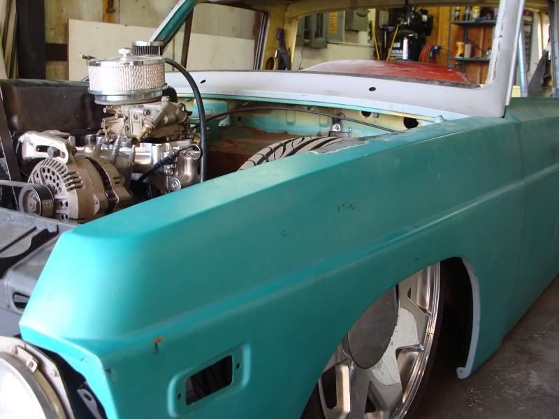

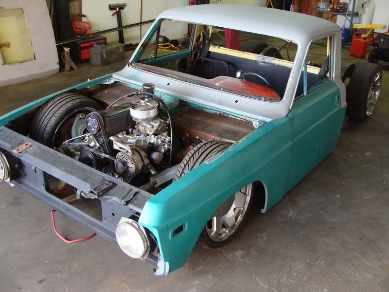

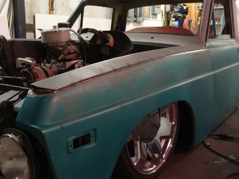

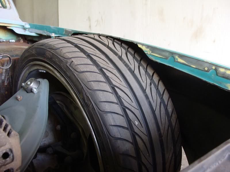

Kenny needs the fenders and hood raised just enough to not rub the tires.
Im raising them 1/2'' so as not to throw off the looks of the frontend too much.
Started with making a panel and shrinking the inside edge to get the curvature right.
Welded.
Still got a lil work to do on the front corner. The hood will be raised 1/2'' and slid back about 3/8'' then ill have to extend the nose down and redo the hood hinges. After thats all done ill have to figure out how to shape the cowl to look right.
