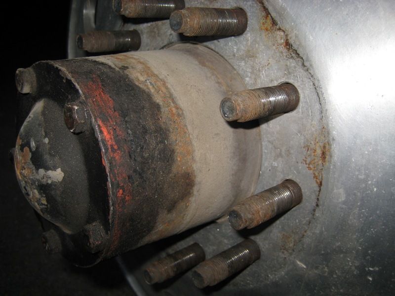

One aluminum installed, takes up the whole hub flange:

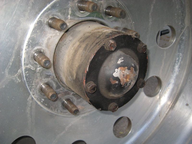

Two aluminums installed, stud holes pretty much line up but I don't trust it:

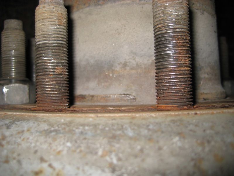

Plenty of stud length though for everything including clamp rings if I run them:

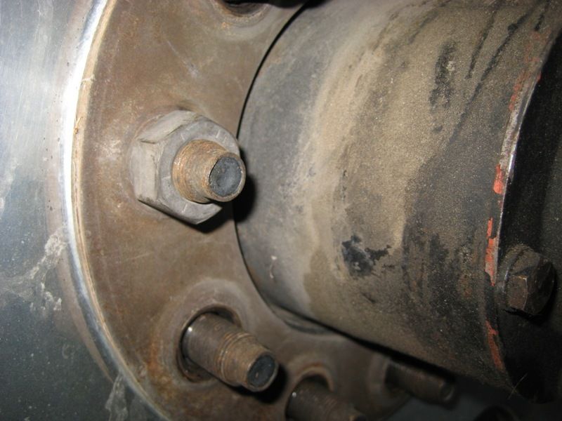

Amount of hub flange left if I run a steel inner:
The more I look at it I guess the older trucks those guys are talking about must have a small bore on the clamp ring because when I look at mine, there's no way it could sandwich in a hubcentric ring because the hole on the clamp ring is large, too; looks like the full 5.25"
