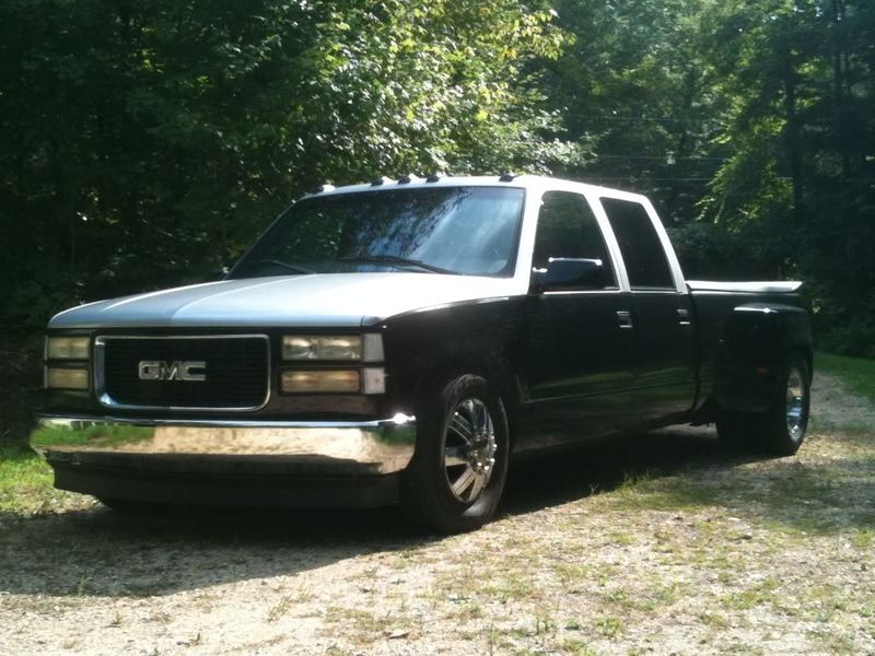

That's what I'm worried about is filling the fender wells. I hate nothing more than to see a truck with BIG gaps between the tires & fenderlips! That's why I was thinking about staying with the 235's instead of the 225's. I know though that the 225's will get it a little lower!
muskratt2's avatar
muskratt2
Check out this website. This is a Ford like mine with 235's on it. I will lower mine the same as this. This one is the reason I was thinking about staying with the 235's.
