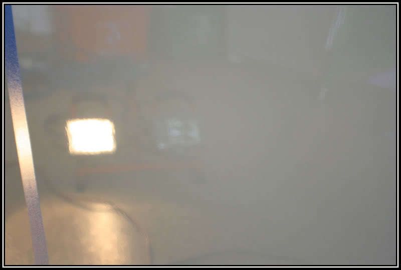

I recently performed a paint correction on this brand new 2009 Audi TTS. Being that it was white, brand new and had less than 800 miles made it a bit tricky to find the defects in the paint. Since the car is pretty much brand new there werent too many surfaces scratches(swirls), but there were some RIDS(Random Isolated Deep Scratches) throughout the vehicle.

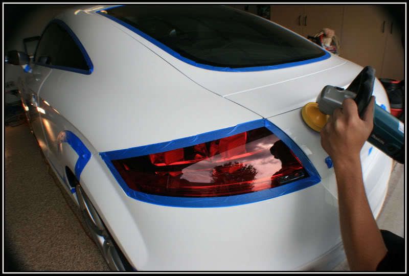

3M Automotive Performance "Green" Tape
M105/PFW via Makita Rotary
M205/Orange via Meguiars G110 DA

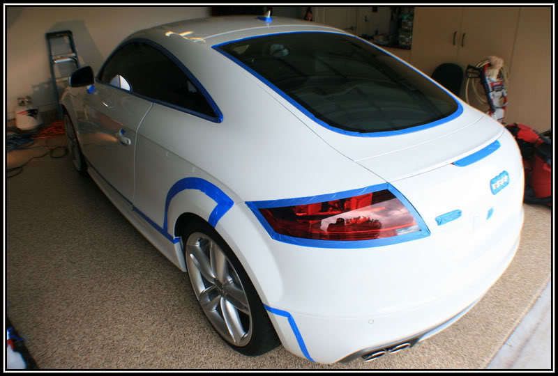

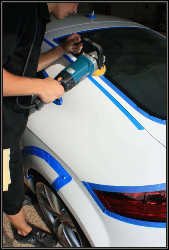

The owner had the car prepped for me before I arrived, so all I had to do was clay, polish, seal the vehicle.

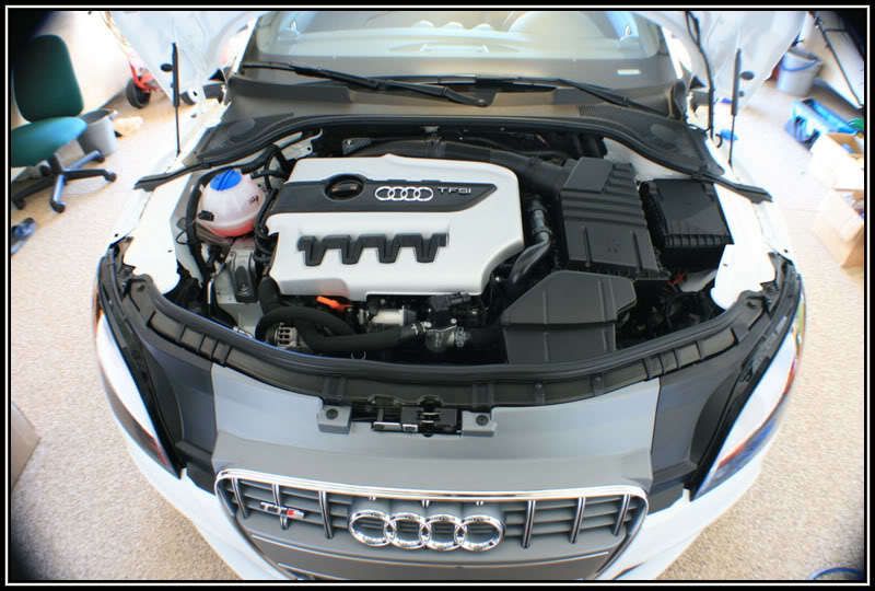

The first thing I did was clay the car and then I taped off any edges and all the clearbra peices(a majority of the car).
I proceeded to wipe down the engine compartment(all that was needed on a car with less than 1k miles) and apply Zaino-AIO to any painted surfaces.

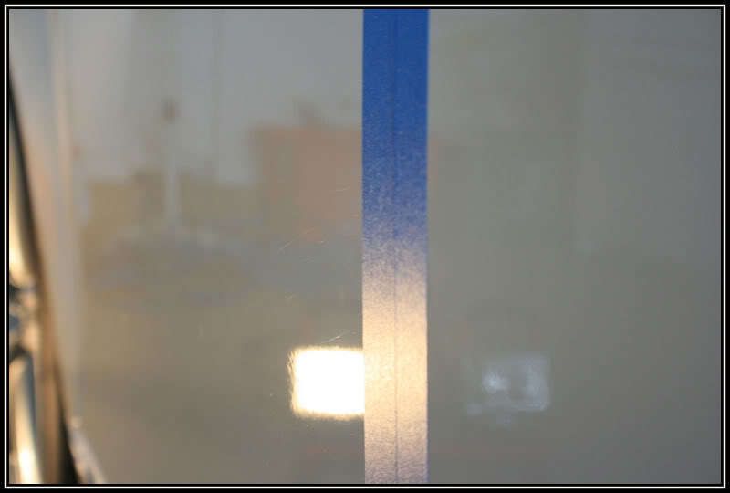

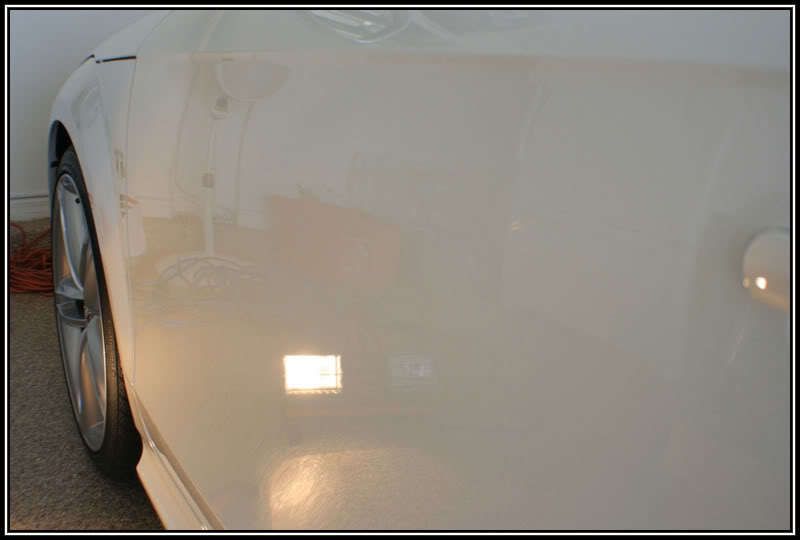

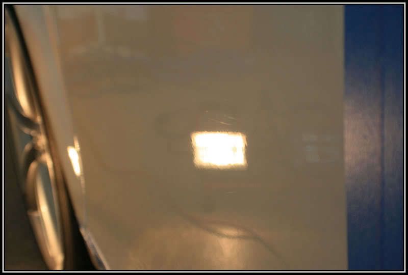

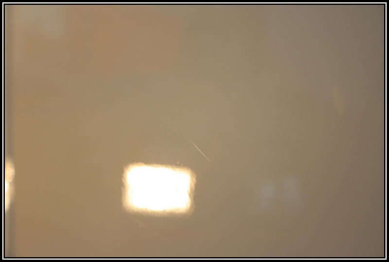

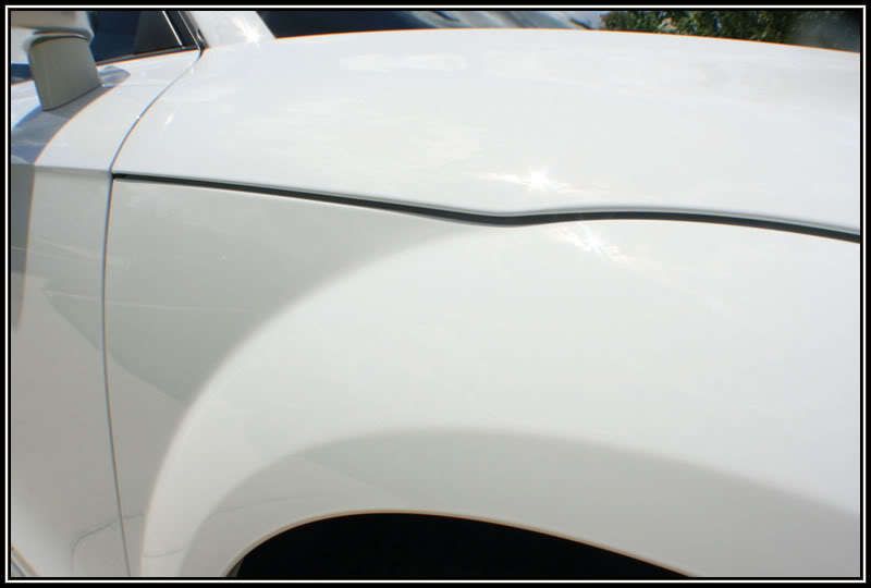

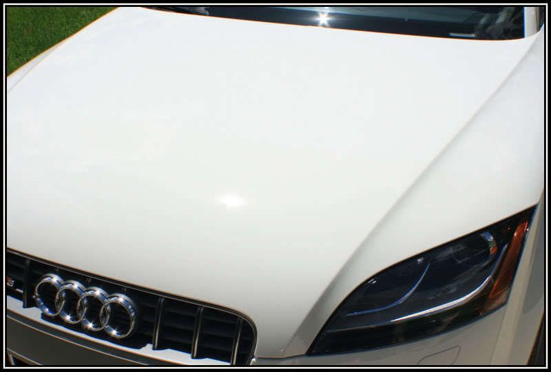

The defects were hard to capture using a camera, let alone my own eyes. So these were the best shots I could manage to capture.
Before.
After.

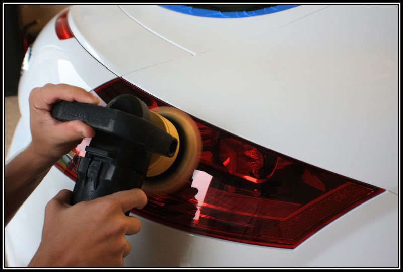

The smaller areas were also corrected using a 4" PFW pad.

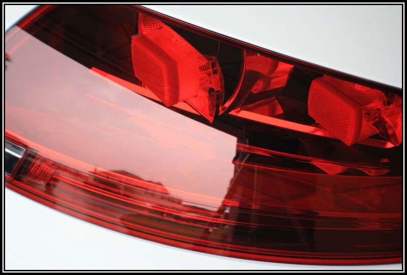

The taillights were also polished with M205/Orange pad.
This produced a very deep and rich reflection in the lights.

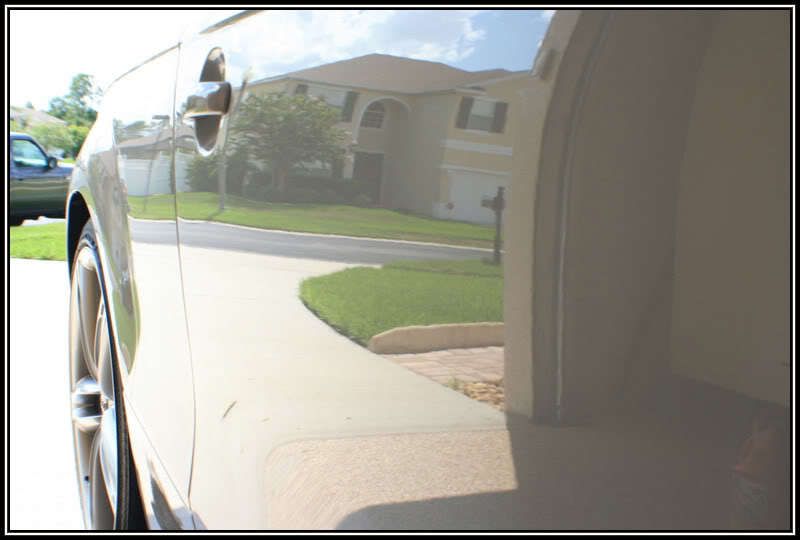

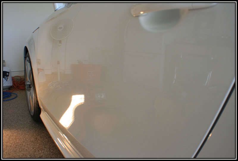

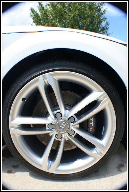

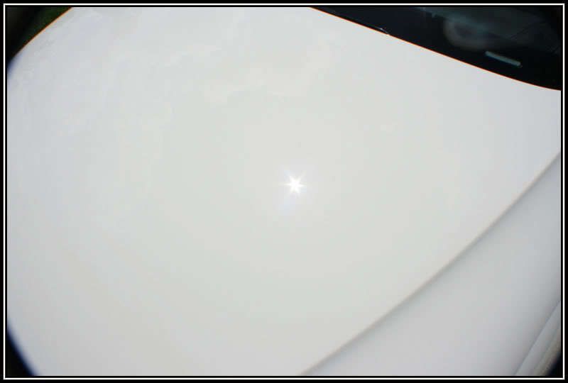

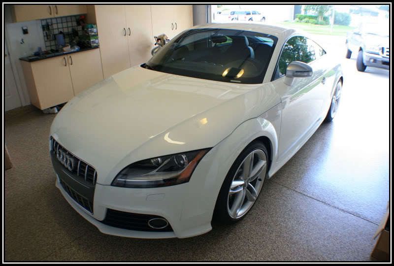

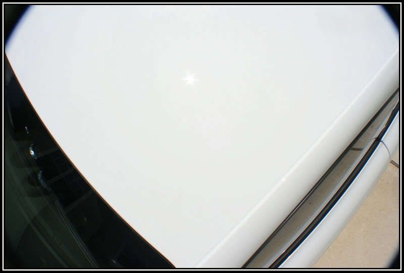

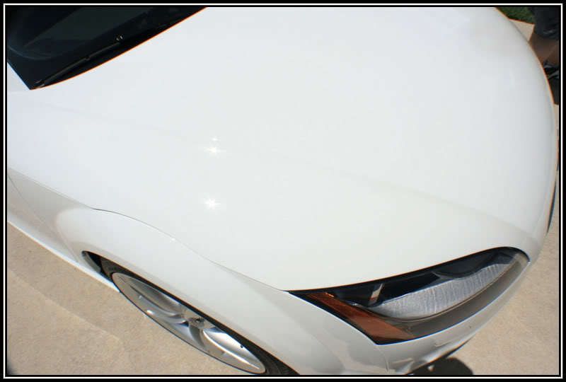

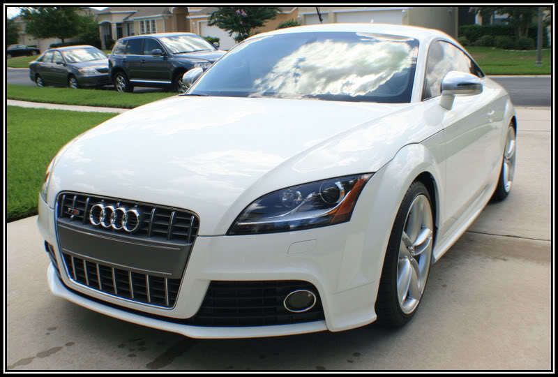

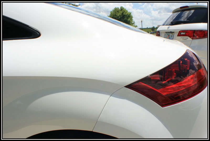

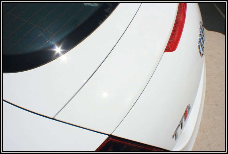

Full Sun Shots!
Final Shots after two coats of Blackfire Sealant and two coats of Dodo Juice Hard Wax.
