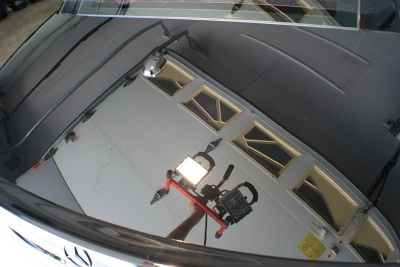

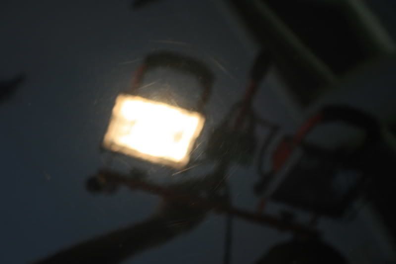

Here, you see some RIDS as well as the very faint haze over the surface.

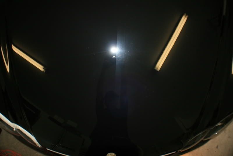

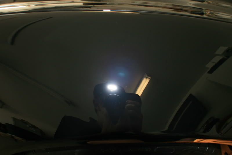

Some special lighting, and it becomes quite evident there was some major improvement to be had! I was excited at this point!

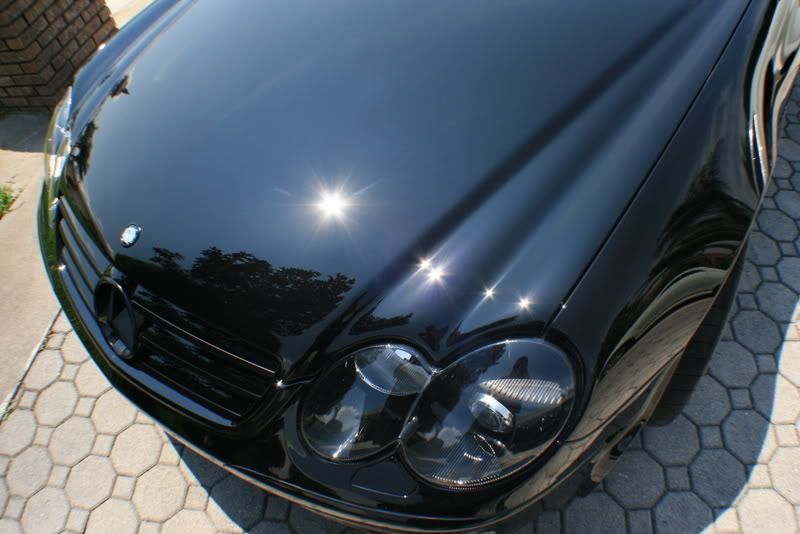

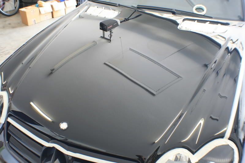

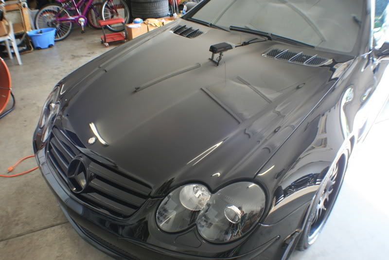

The hood was my test area, so it was completed first. Some final shots after M105/PFW via rotary followed by M205/Orange via G110.

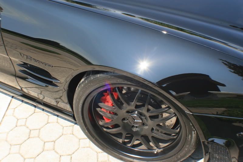

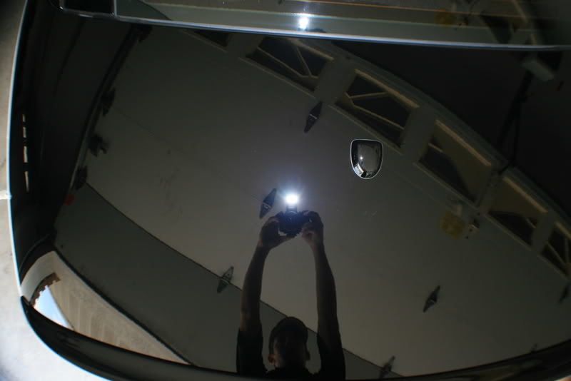

Next, I had a look at the fender..not so perfect.
After a couple passes of polishing, our end result!

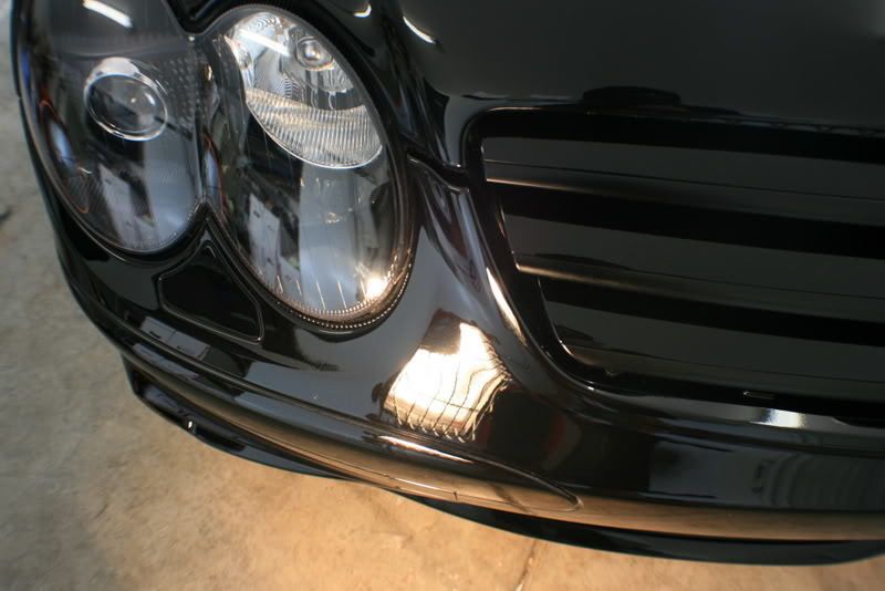

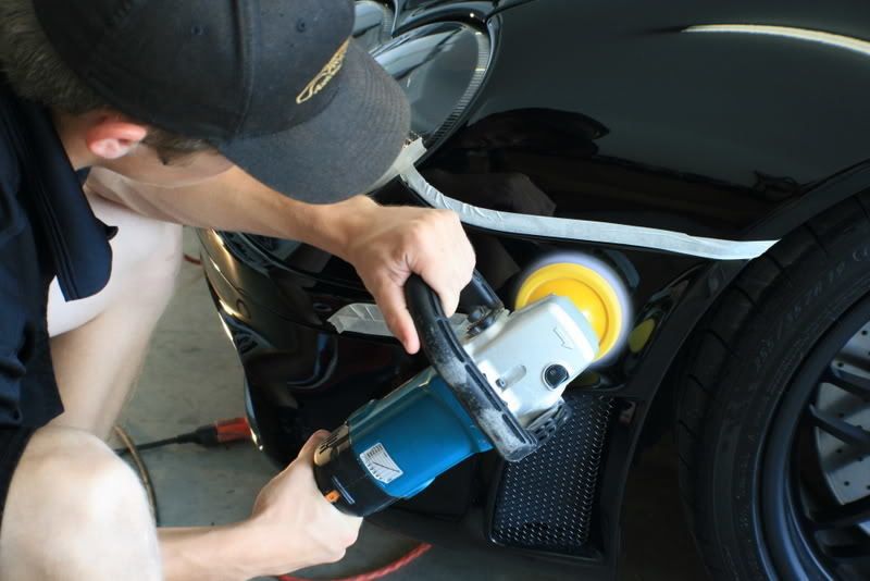

The smaller bits of the intricate bumper were carefully taped off and polished to perfection using a special 3" PFW pad.
The bumper finished.

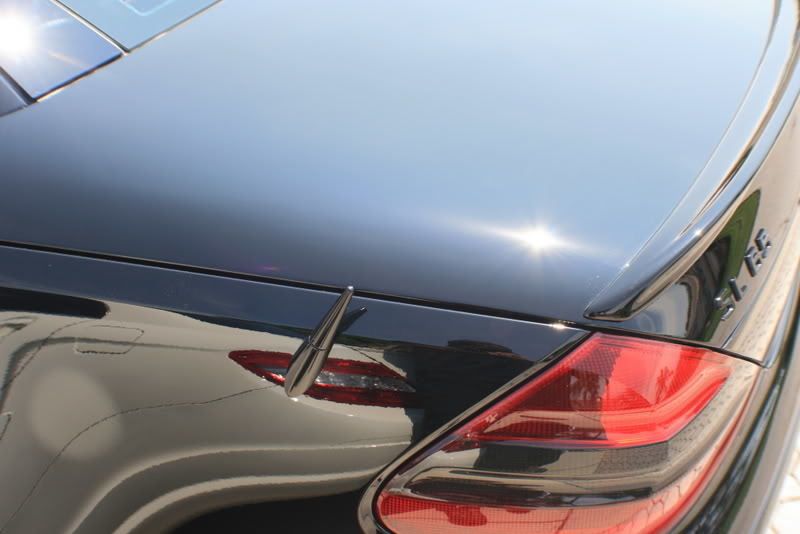

After M105/PFW, no finishing polish.
Just to remind you what the trunk used to look like..
It doesnt get any better than this!
The flash came out funny in this one due to the trunk curvature, its not a hologram I promise!

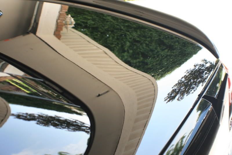

Most of the roof was glass, so I taped off the pillars so they could be corrected as well..

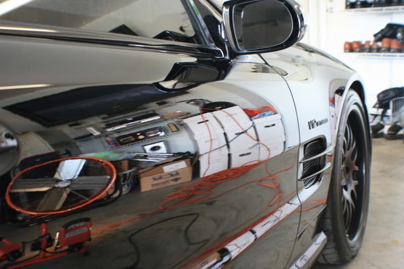

Next up were the doors and rear 1/4 panels. I was running out of time, so I forgot to take some before shots, but its the afters we all want to see anyways right??

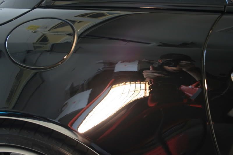

Driver Rear 1/4 Panel.
Passenger Rear 1/4 Panel.

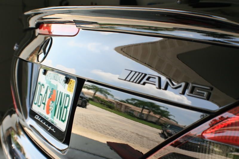

Now I get to grace you guys with some beautiful reflections and some full sun shots to close! Thanks for looking!
