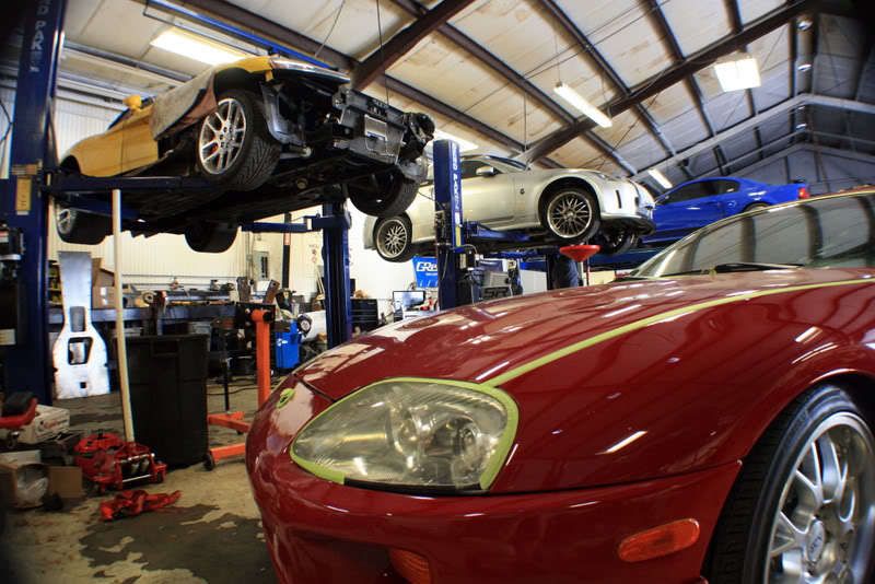

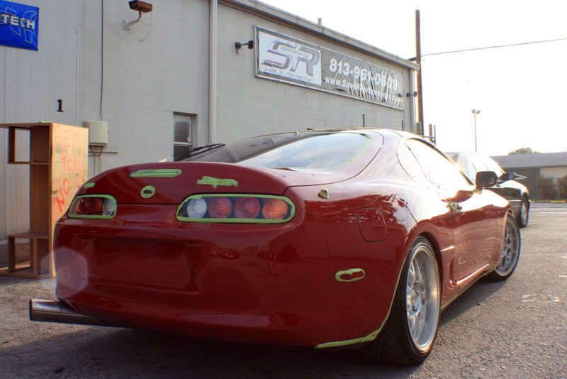

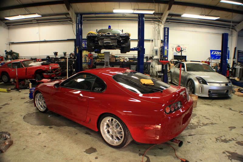

I had a slew of cars thrown at me over the last couple weeks from SR Performance. I do a lot of work for them once they are finished with the mechanical fix ups. This car in particular is their shop car theyve had for a few months now. This car has a GIANT single turbo setup with a built auto tranny(not familar with the exact model-maybe turbo 400??) and also is equipped with a full COBRA IRS rearend. Doesnt hurt to make 600+WHP and never fall out of boost with the auto!! Its like a rocket when you peg it! There is no doubt it is definitely a fast car, but it definitely needed some exterior loving!!!!

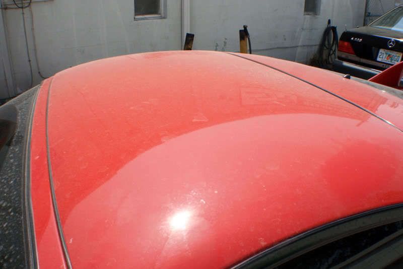

When I first started, it was covered in dust and sand so I had to be very careful washing it.

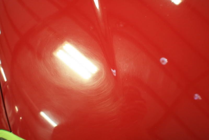

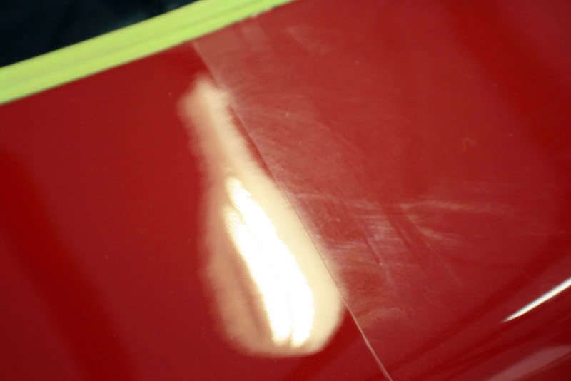

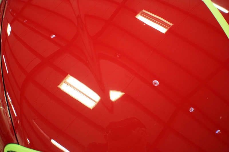

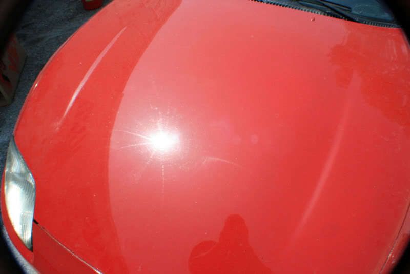

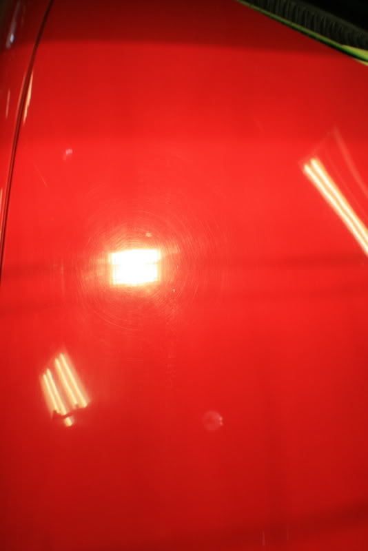

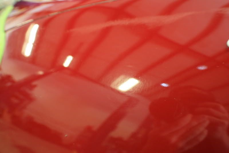

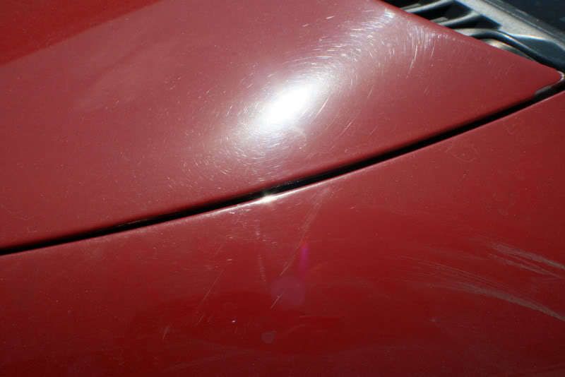

I started with the hood to see where I was going to stand, it had a fairly hard clear and I ended up having to use a Burgandy wool with M105 using the KBRM to remove the defects. This was not a factory paint, nor a good quality one, but I was able to clean it up pretty decent for what it was.
BEFORE
Can you say Brillo pad??

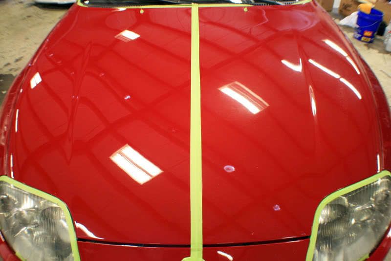

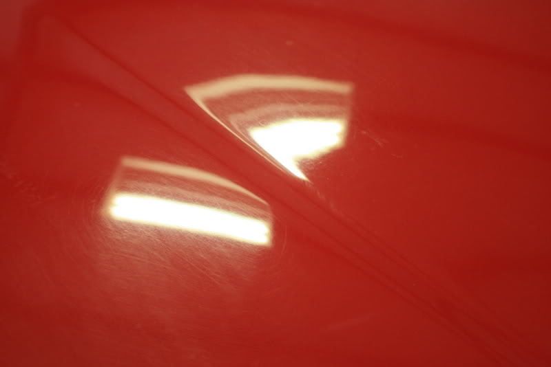

Now can you say VOILA!!
And finally, the entire hood finished.

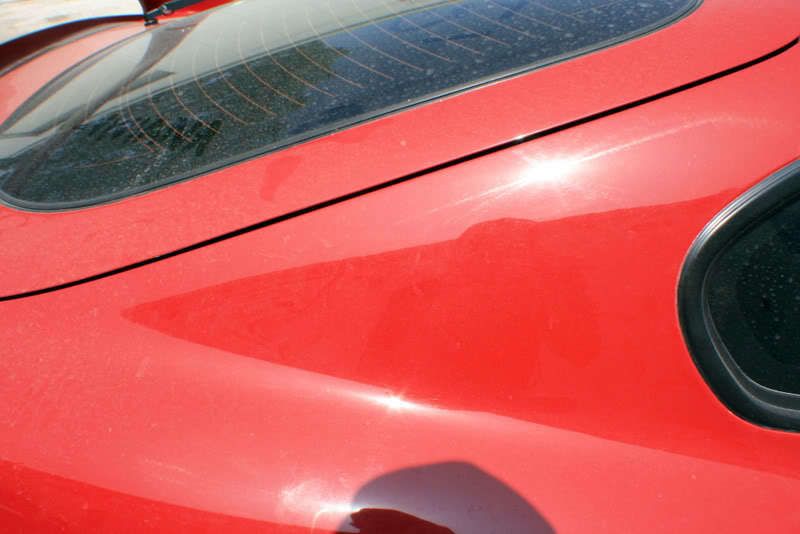

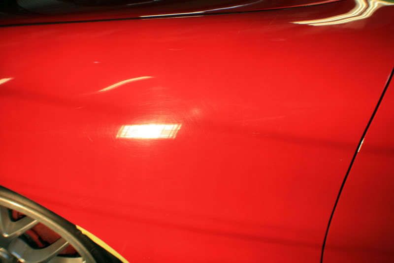

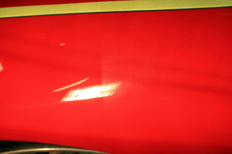

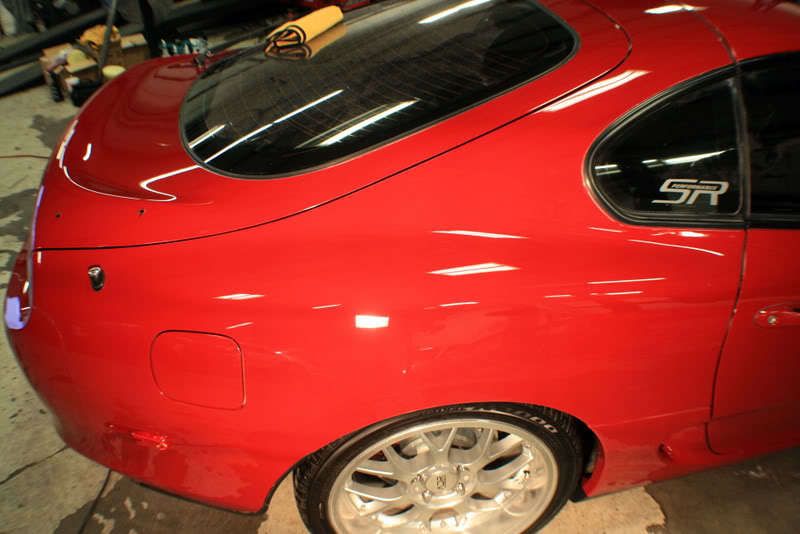

I then moved onto the rest of the car using M105/Burgandy, M105/Polishing Pad, and M205/Finishing Pad.
After compounding only..

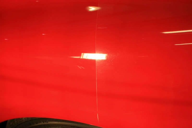

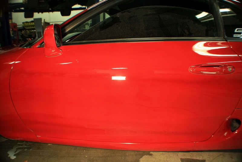

Fender Corrected/Door Uncorrected.

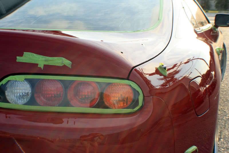

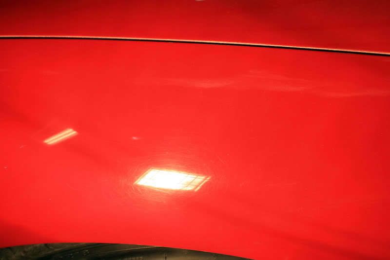

Before..
After Compounding Only..

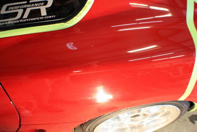

Before.
50/50.

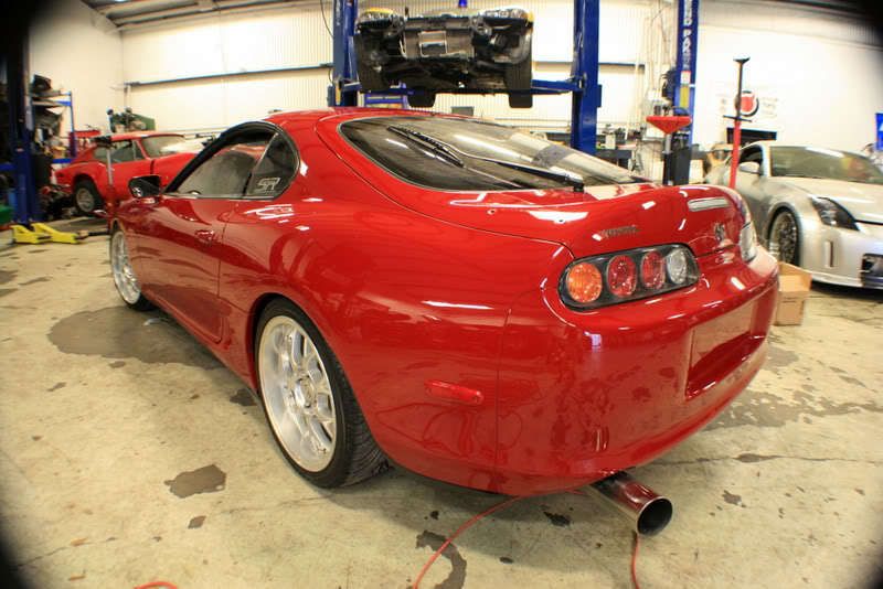

A few more pics in the halogens after compounding.

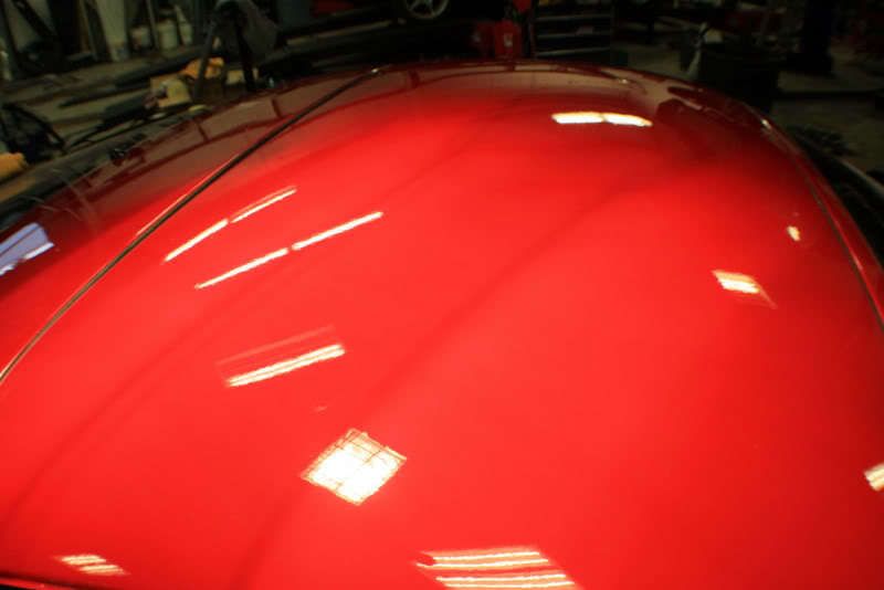

Roof.

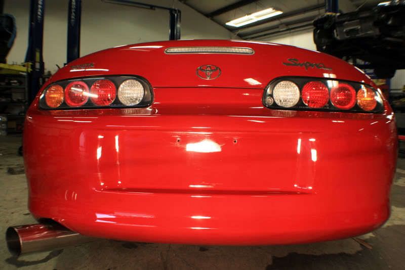

And yes, that is a 4" straight through exhaust NO MUFFLER, it sounds incredible!

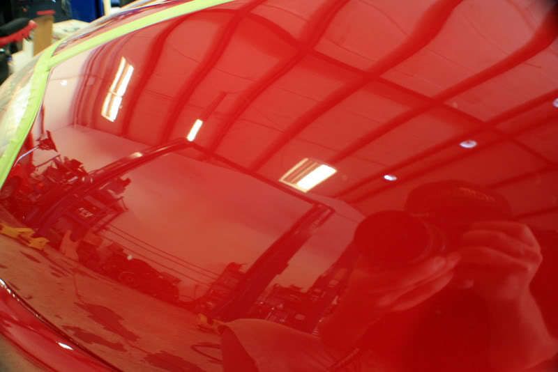

These were the best sun shots I could get..
And a few final reflection shots..
