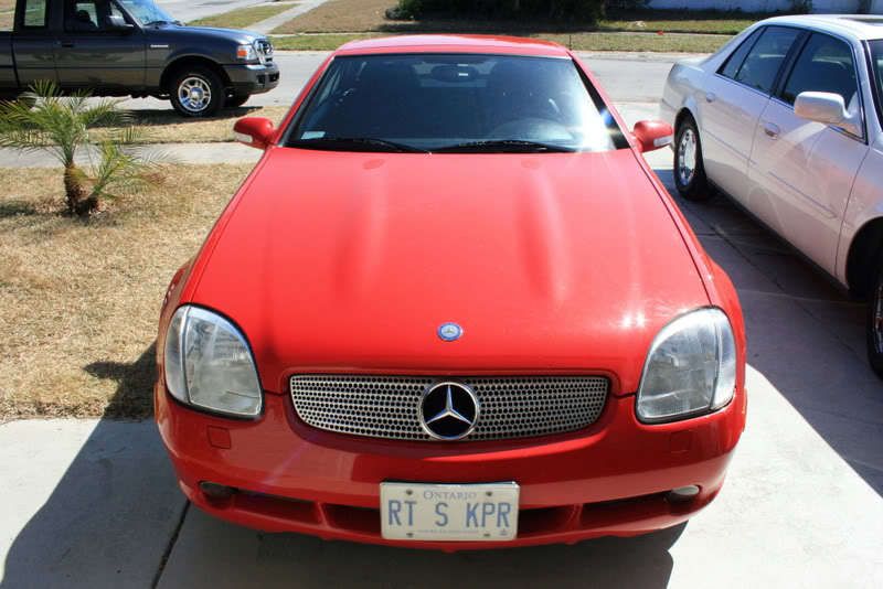

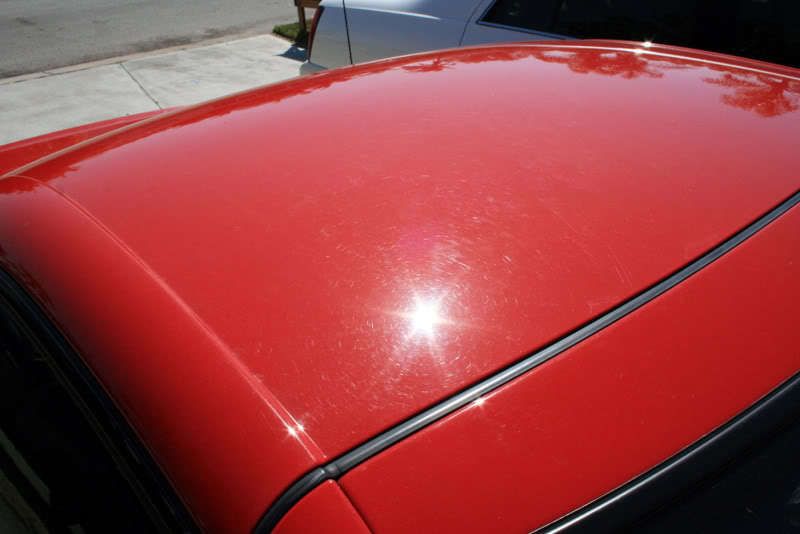

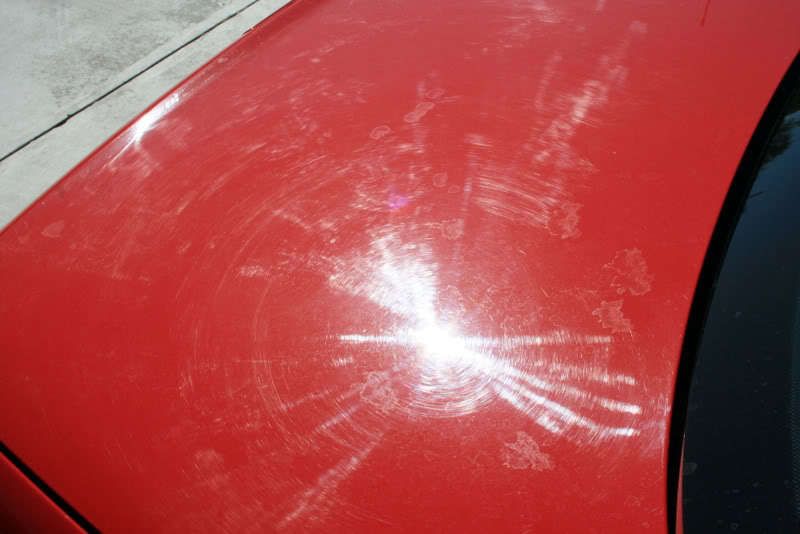

This is how the car looked when it arrived..I got this 2001 Mercedes SLK230 two days ago, and we'll just say it wasn't in great shape...AT ALL! In fact, the paint(specifically the trunk)was in probably the worse shape I had seen. I was only hoping and praying M105 would be able to tackle it even using the KB method.

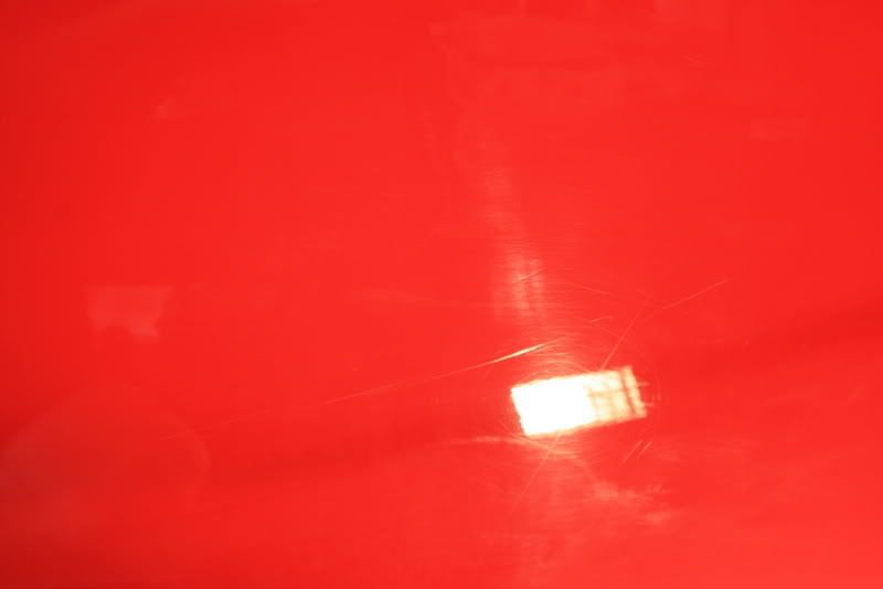

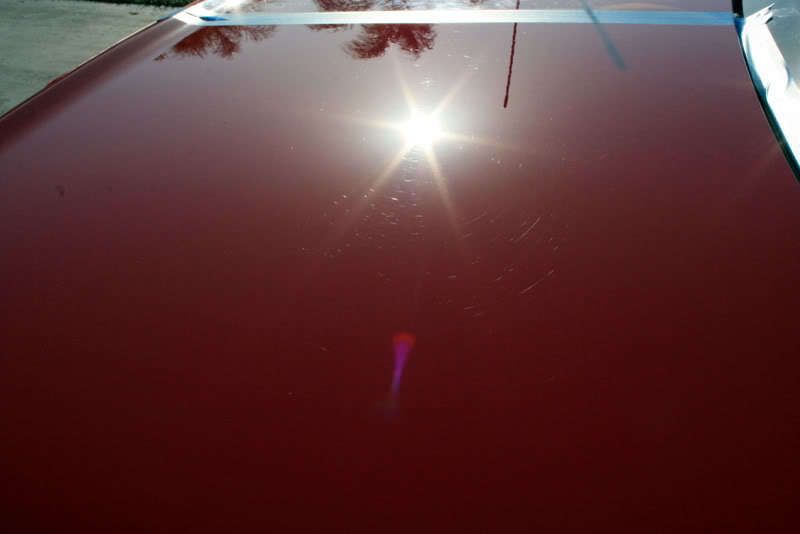

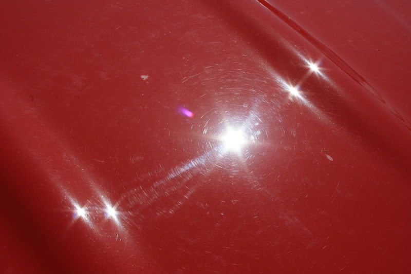

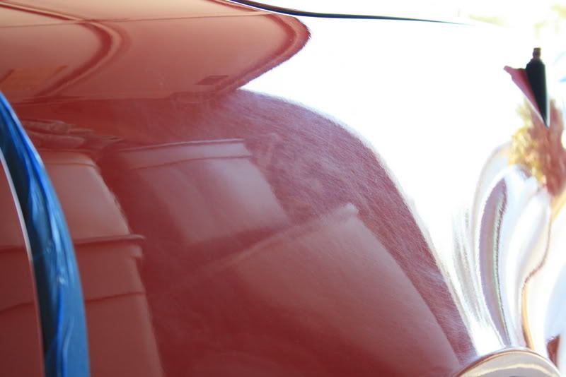

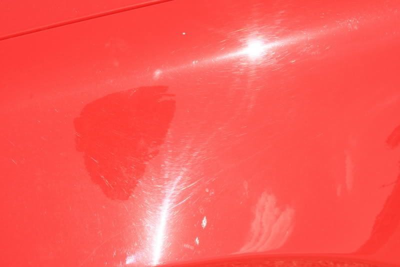

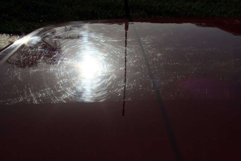

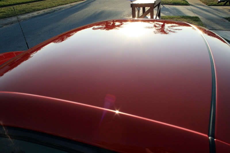

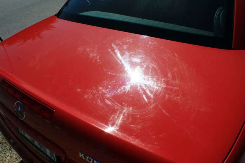

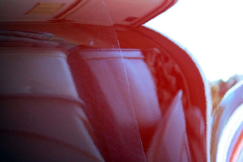

This is what I was working with on the trunk. Apparently the owner took some sort of "rocks in a bottle" compound by hand on a rag to try and remove some swirls, only putting some more MASSIVE swirls into the paint.
I never thought I was going to be able to correct this, and if I did I thought for sure there would be a significant amount of RIDS left over..WRONG.

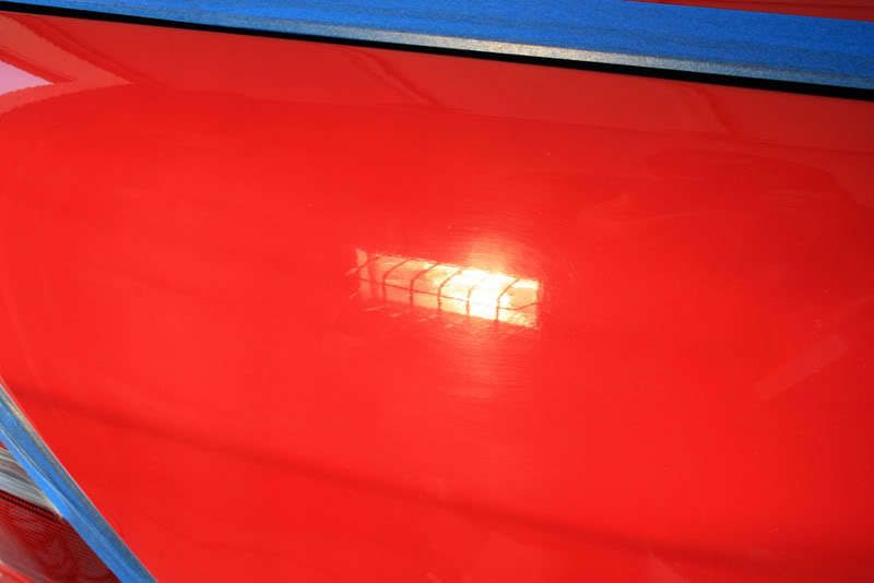

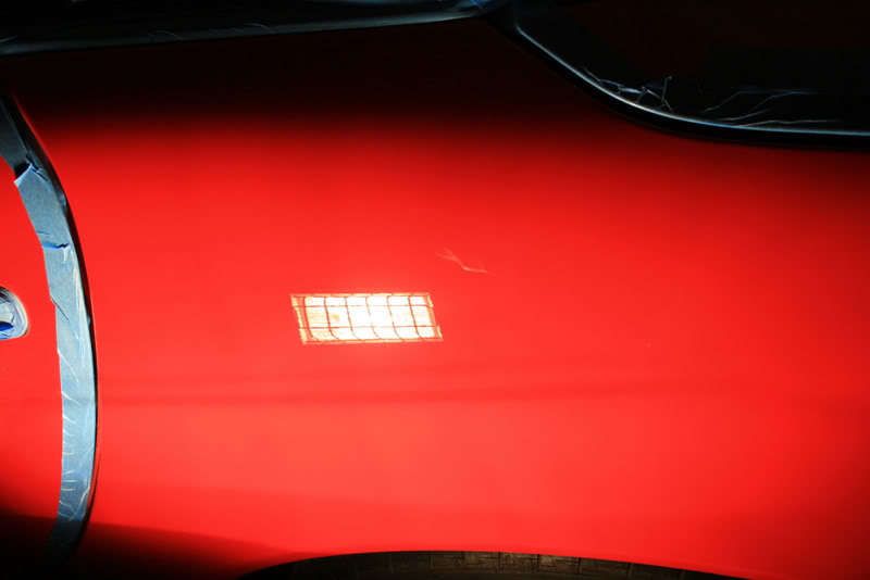

The first combination I tried was M105 on a Megs Solo Yellow Wool using the instructions given to me by Kevin months ago. Just to avoid the confusion:

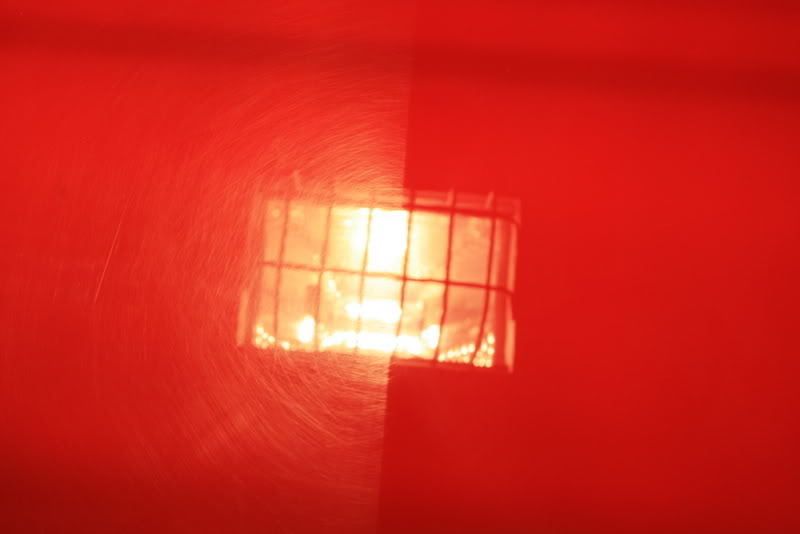

Even in my first pass, I removed MOST of the heavy swirling but there were some RIDS still visible.

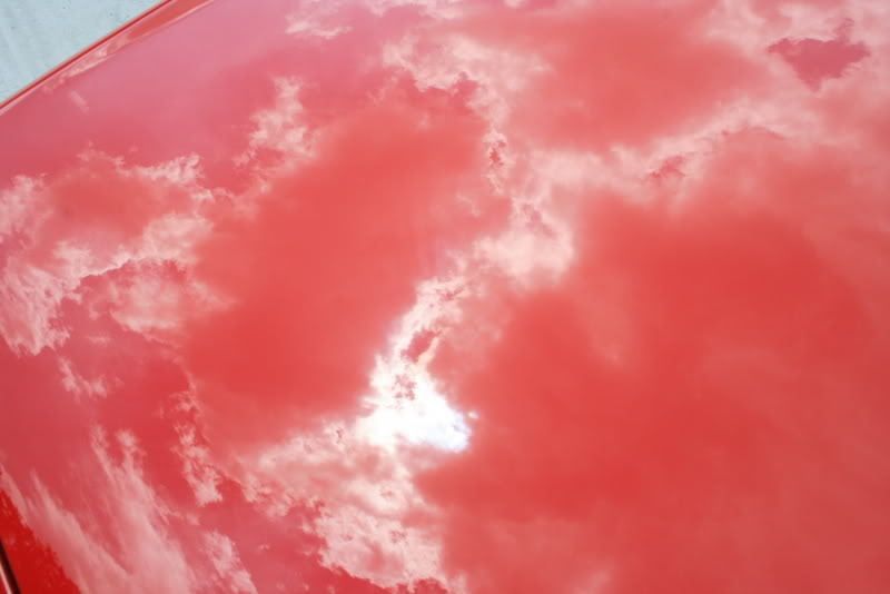

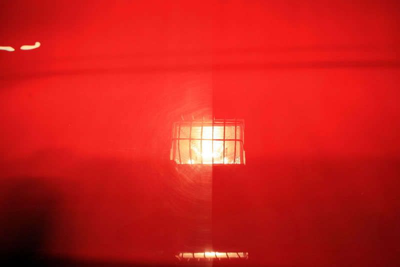

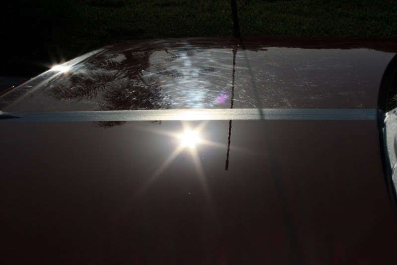

I then decided to step it up to the Megs Solo Burgandy Wool just to see if the left over swirls were worth the chase. To my surprise, they were nearly COMPLETELY removed. After TWO passes with this combination, I got what I was looking for. PERFECTION!
These pictures were taken directly after M105/Burgandy Wool. There was no middle or finishing steps taken.

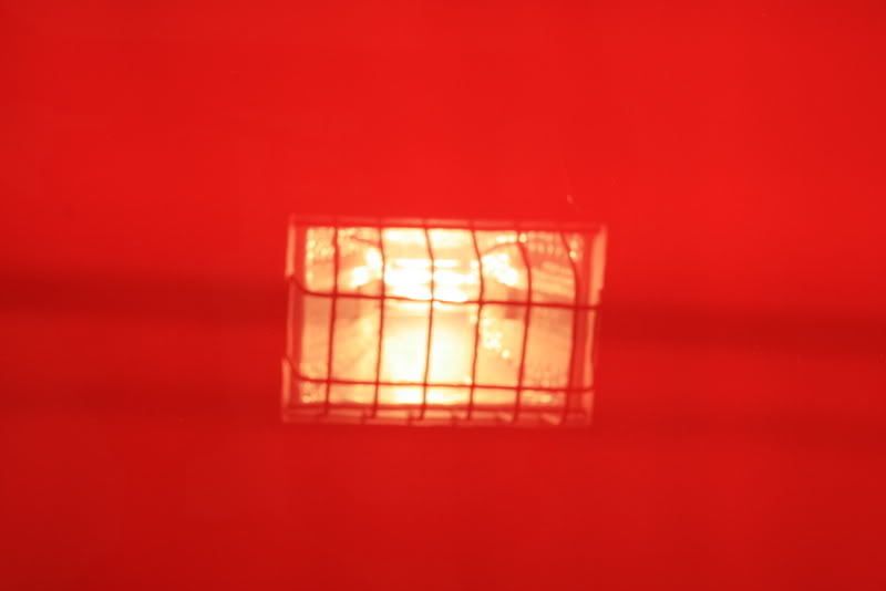

The same panel under the halogens..

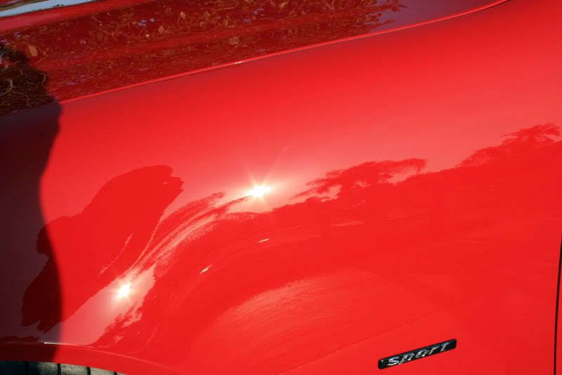

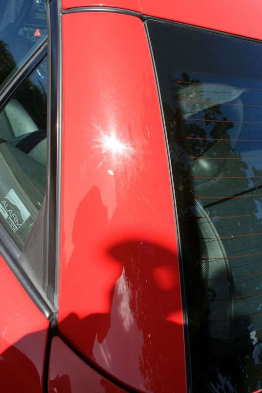

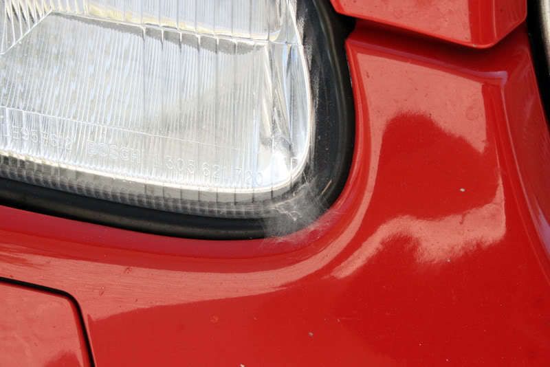

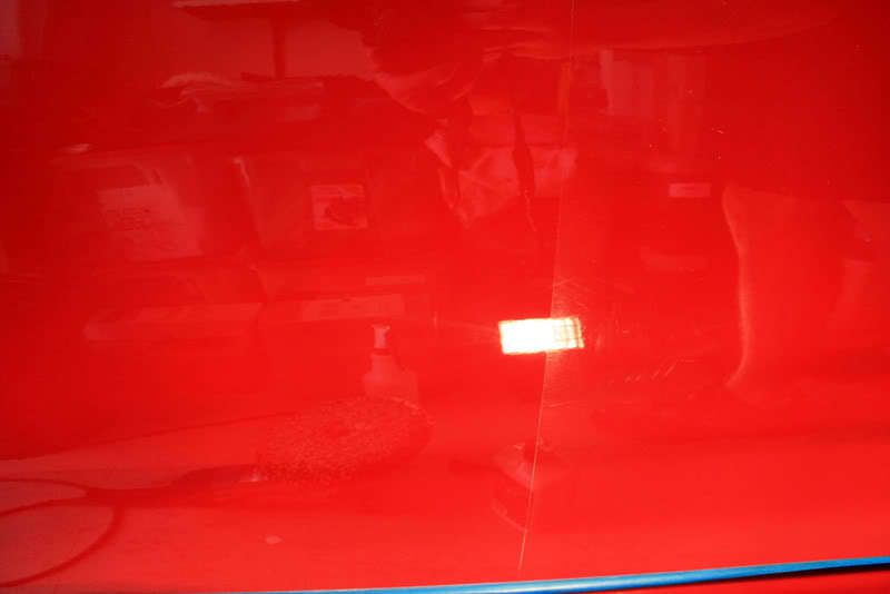

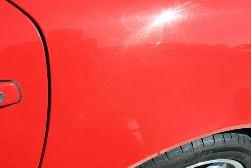

I then moved on to the rest of the car, the other panels weren't nearly as bad as the trunk, but there were still some pretty deep defects throughout requiring two passes still.
Note. These pictures were all taken directly after M105/Wool, no finishing steps taken.
Passenger Rear 1/4 Panel.

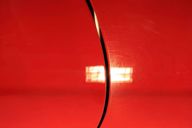

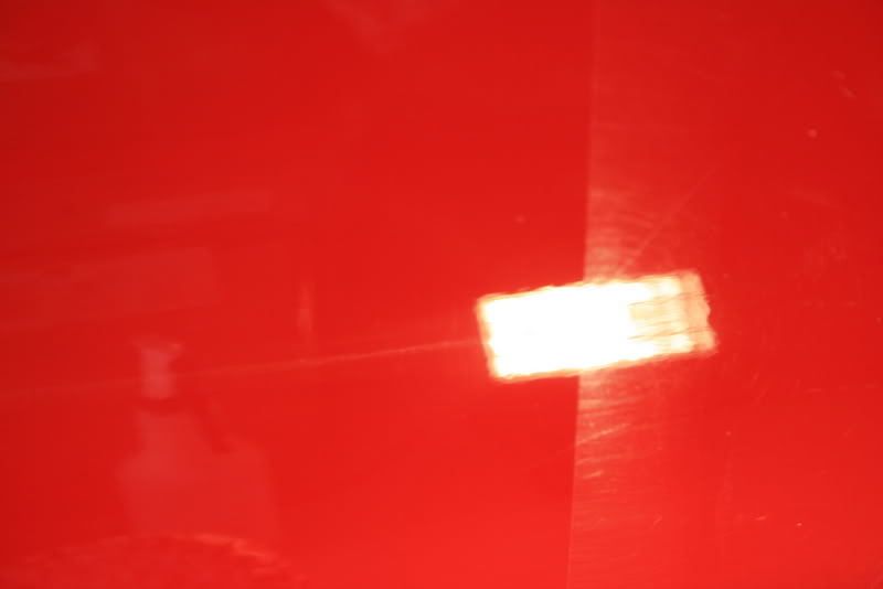

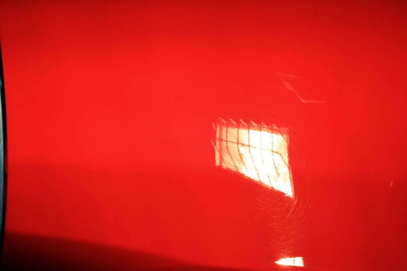

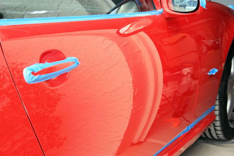

Some very deep defects on the passenger door.
50/50 after M105/Wool. Here, you can notice a very faint hologram, but still not bad for how aggressive this product works!

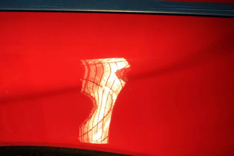

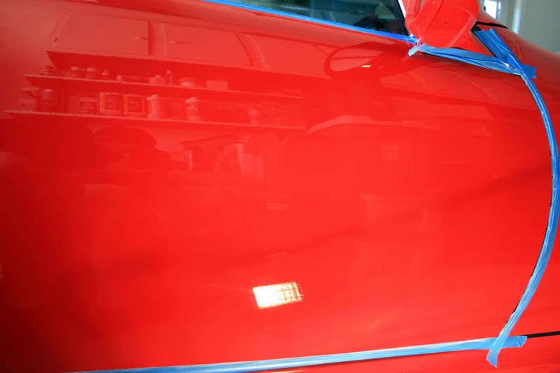

Same Door.
Door Corrected. Fender Not.

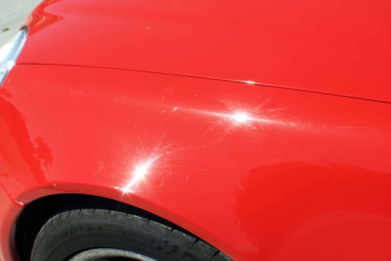

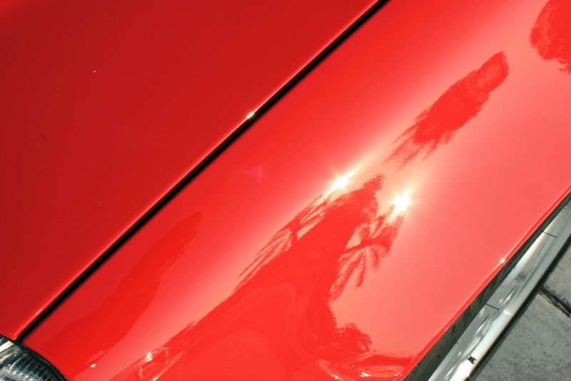

Front Passenger Fender Uncorrected.
50/50.
Fully Corrected.

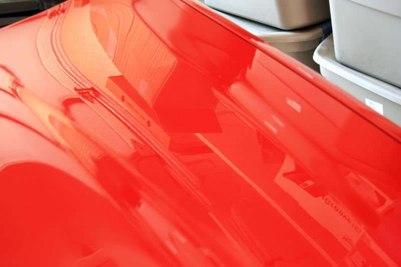

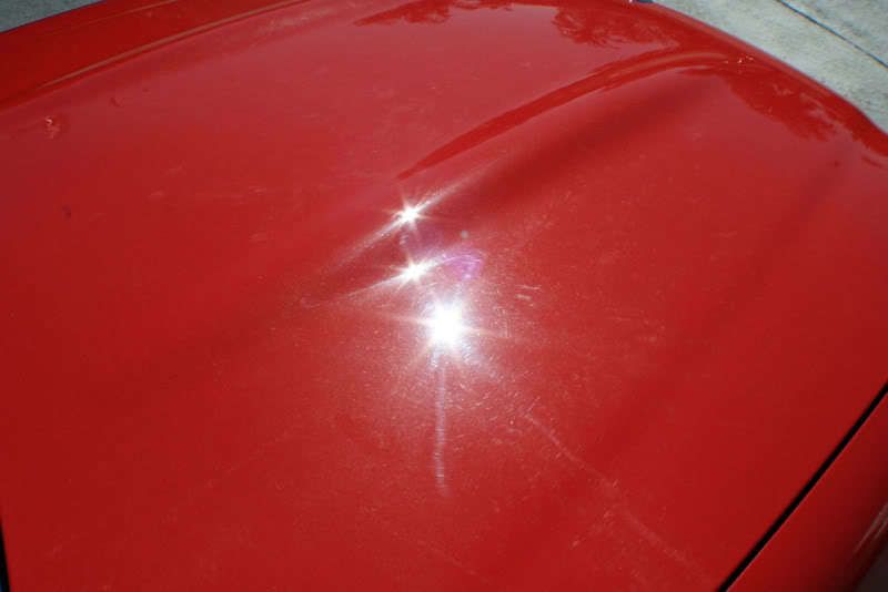

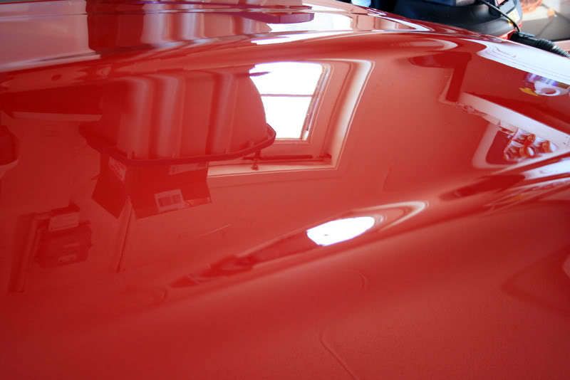

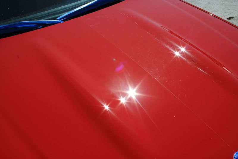

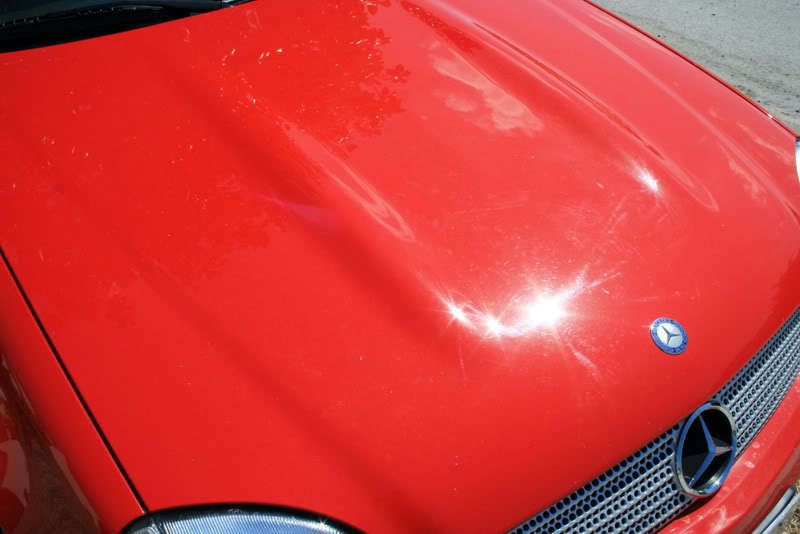

I then moved onto the hood, which wasnt in the best of shape either.
50/50.
Corrected.

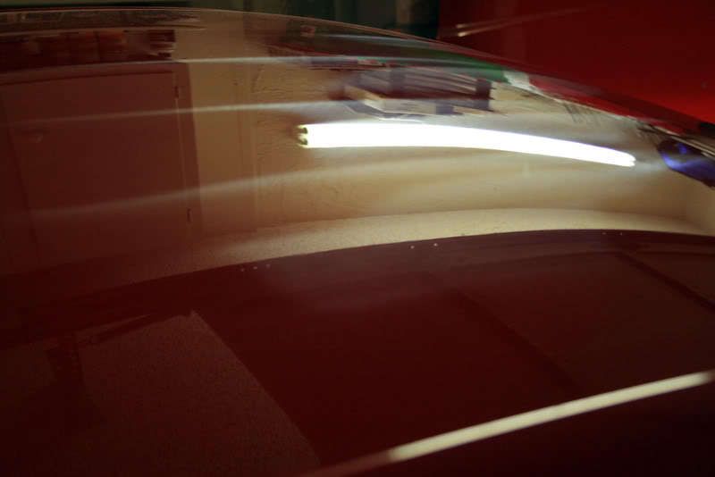

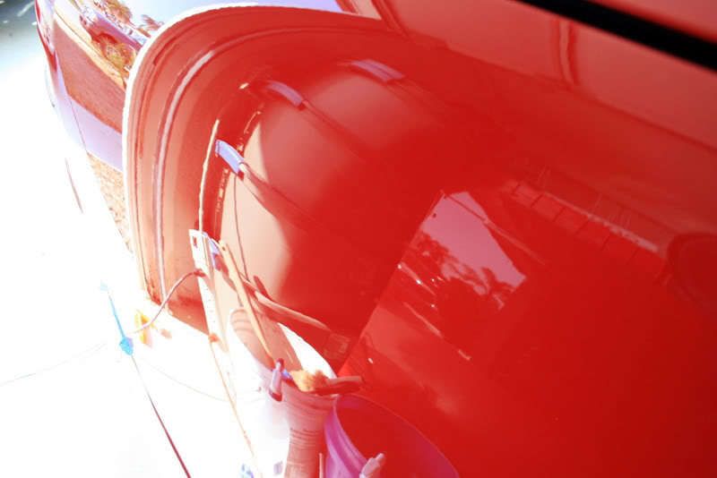

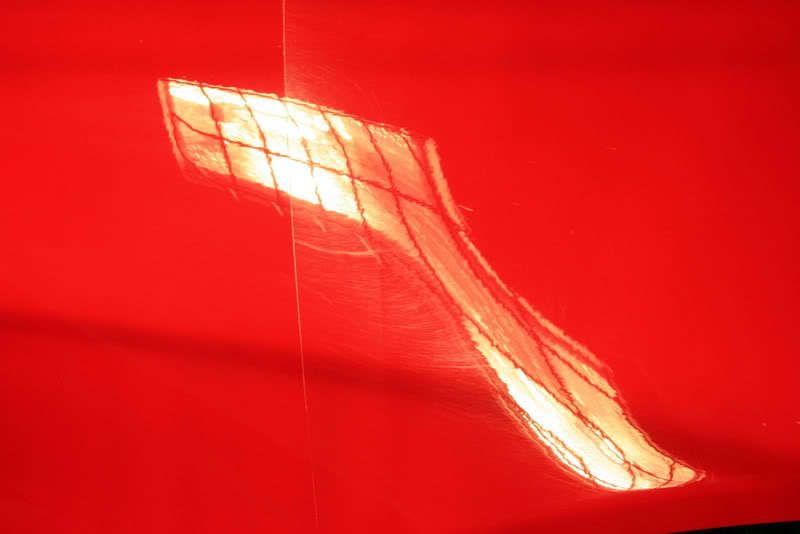

Besides the trunk, the next worst panel was the Drivers Rear 1/4 Panel. You can see even without any lighting just how swirled and hazy it is.
A little closer inspection.
After ONE pass with Burgandy Wool/M105. You can still see some deeper RIDS left over.
50/50.
Now after TWO passes. Fully Corrected. Sorry about the fiber on the lense.

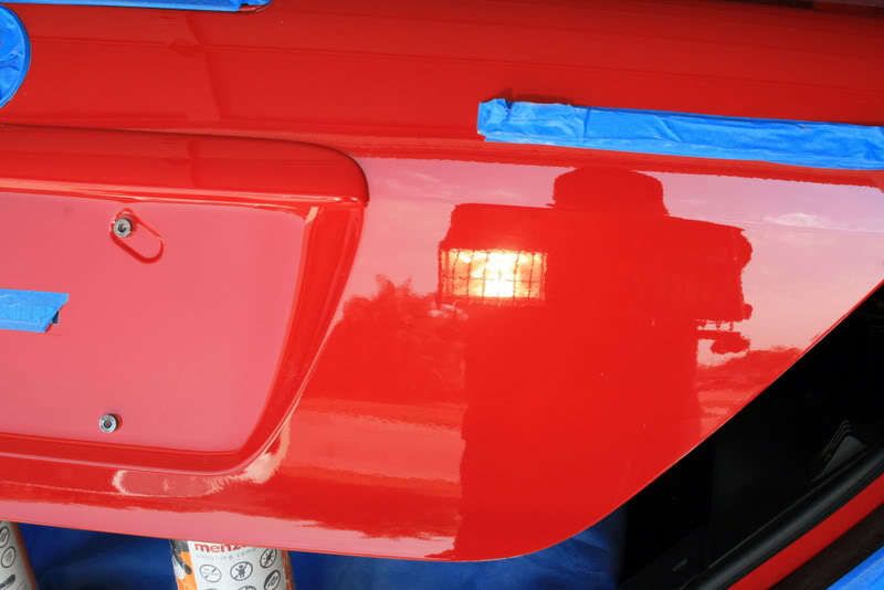

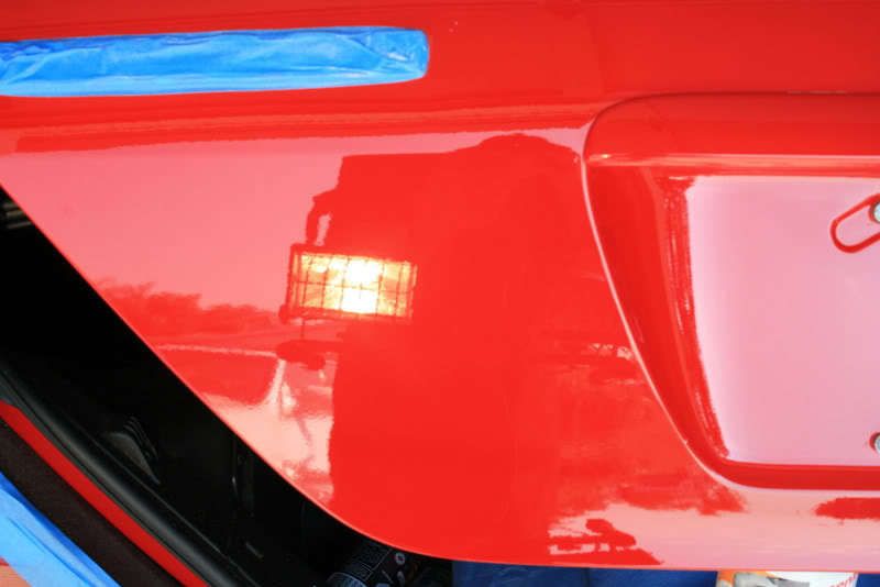

I removed the license plate so I could fully polish the entire trunk. Of course I cleaned up the mess from under the plates before polishing! :nana:

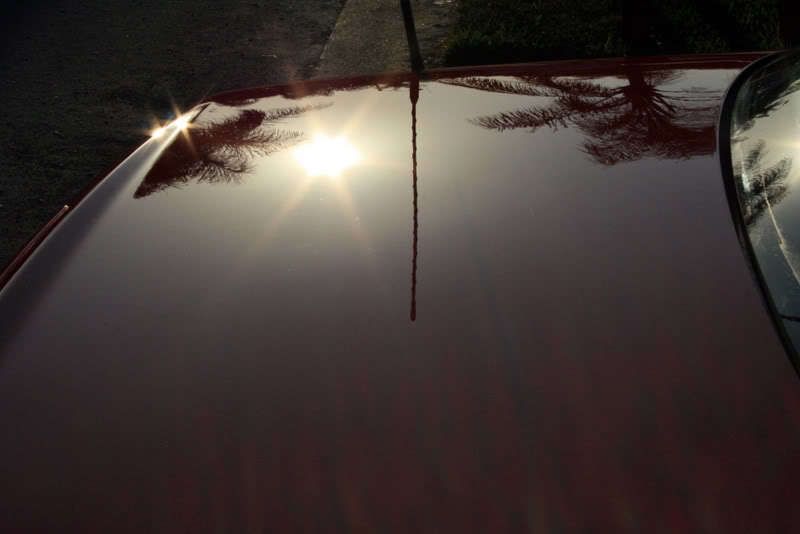

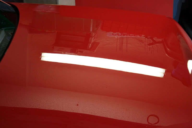

Uncorrected.
The trunk only required 1 pass be made with the burgandy wool/105.

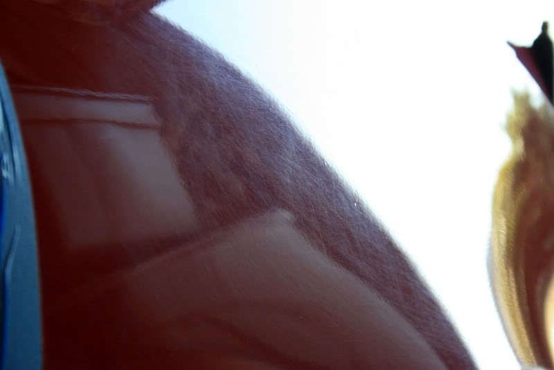

A shot of M105 after polishing, ready for wipe-off.

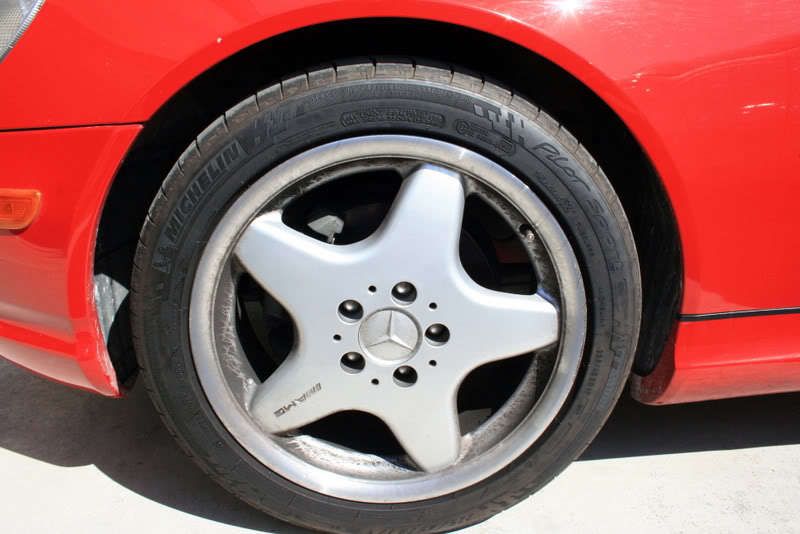

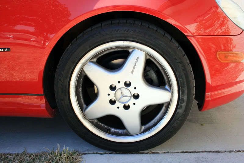

I forgot to add befores of the wheels, so Ill throw them in here before the final shots! :heelclick

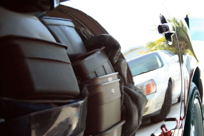

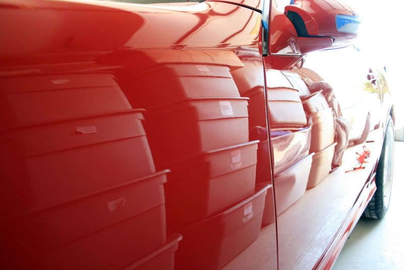

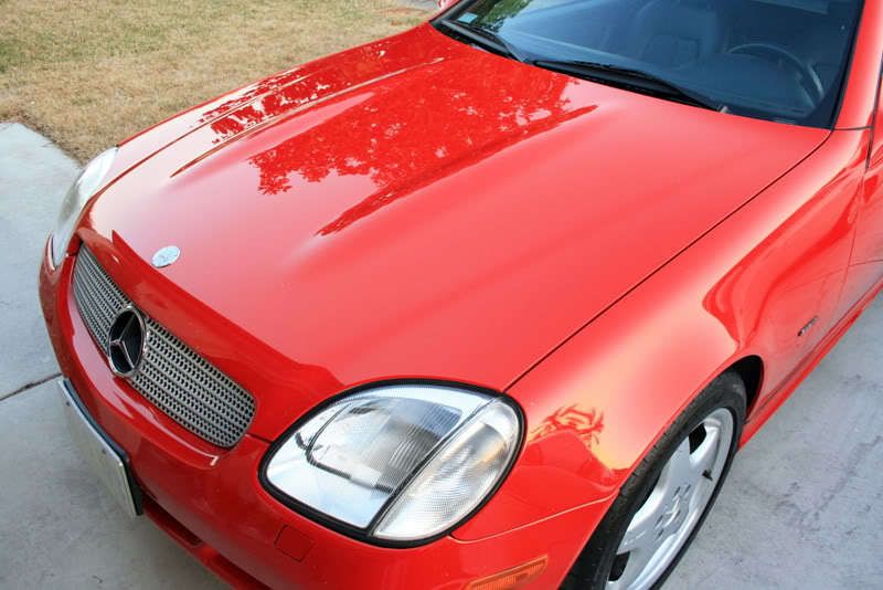

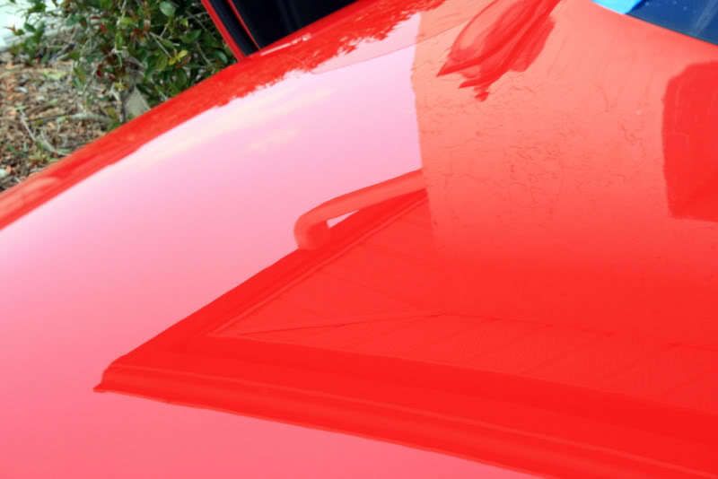

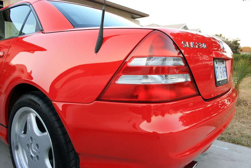

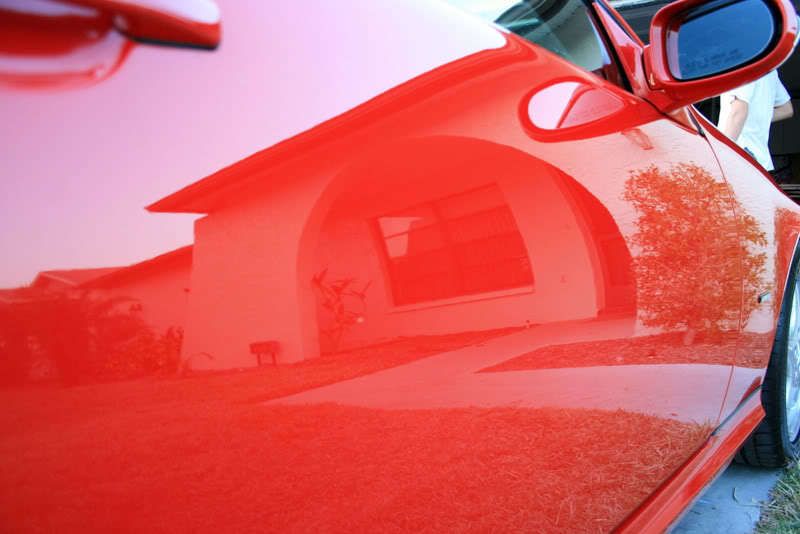

Now for some reflection shots! My favorite part, this is where I can get creative with the SLR :grinno:
the twanksta's avatar
the twanksta

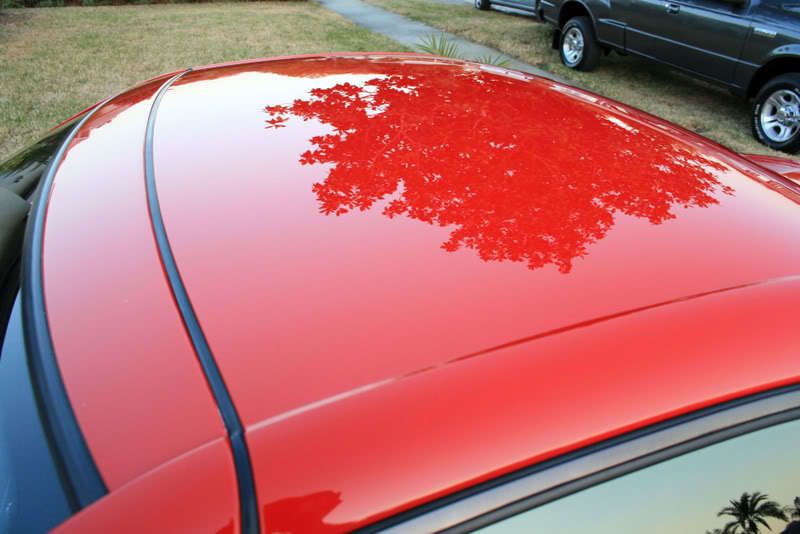

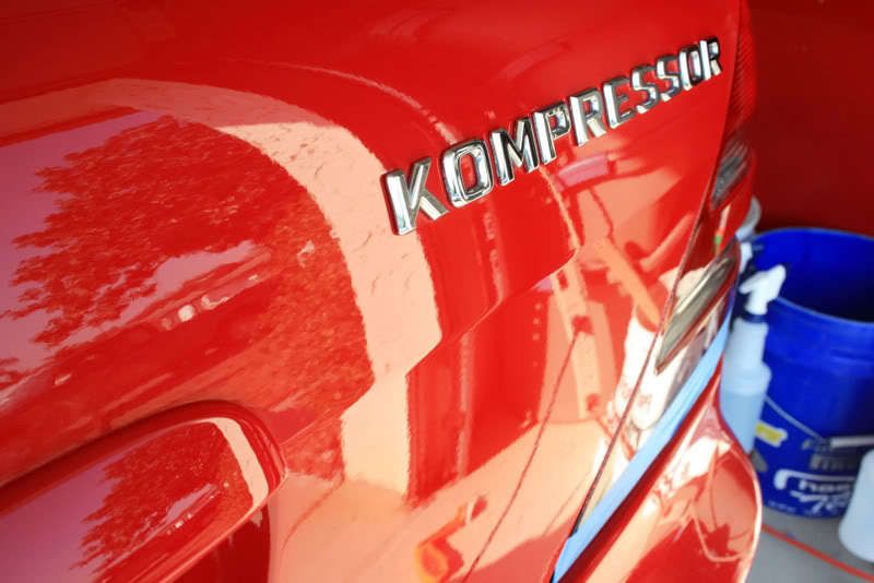

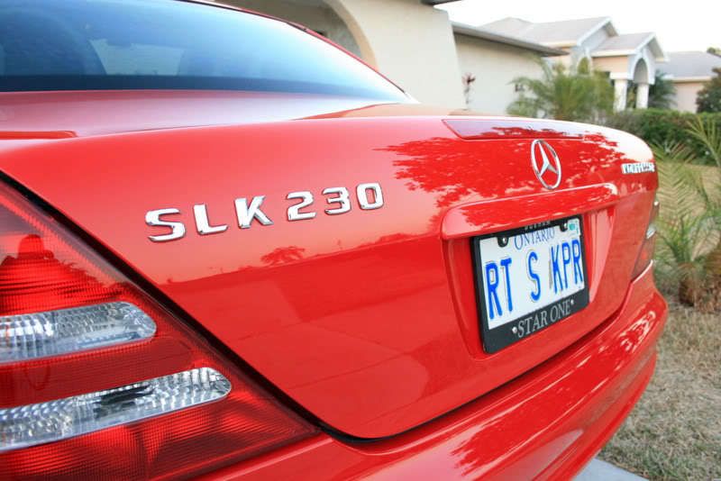

Here are some overall car shots. The car was sealed with Opti-Seal and two coats of P21S 100% Paste Wax.
