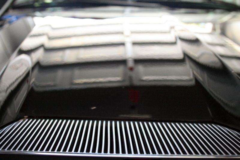

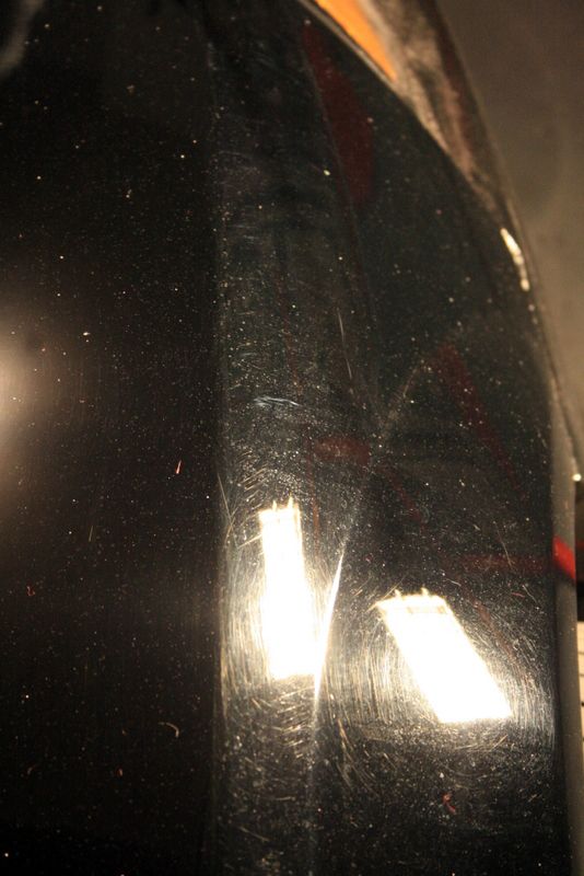

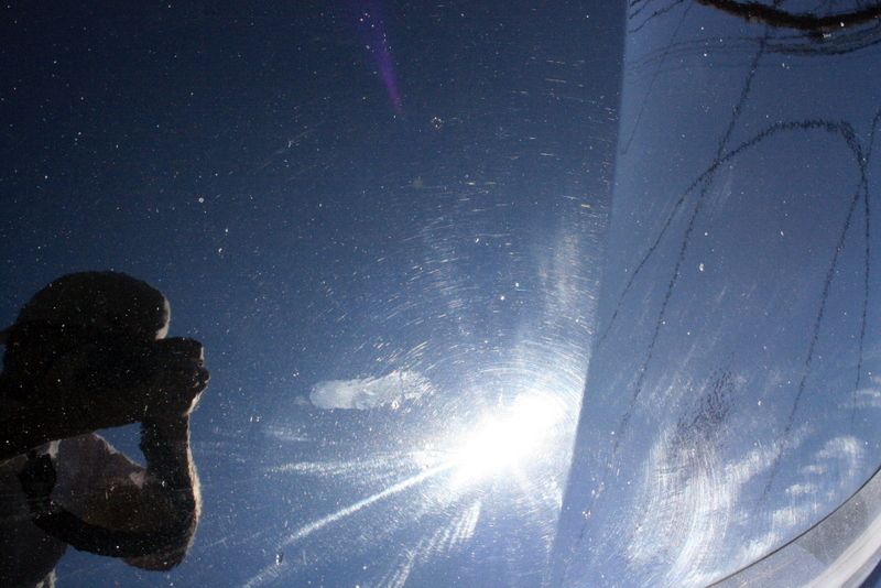

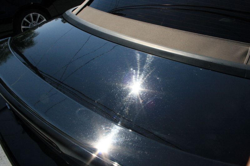

BEFORE:

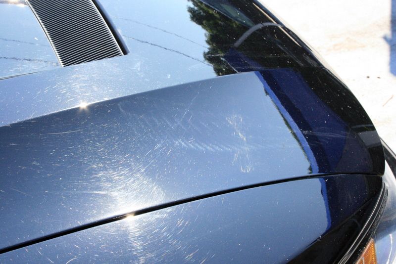

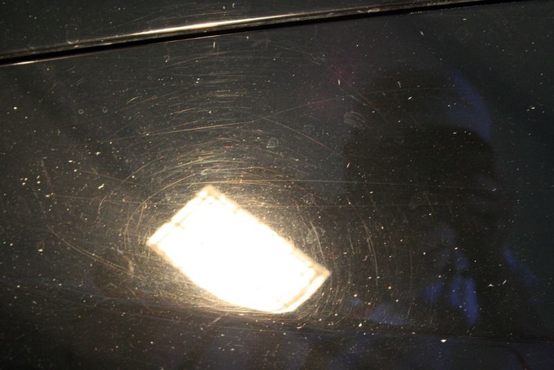

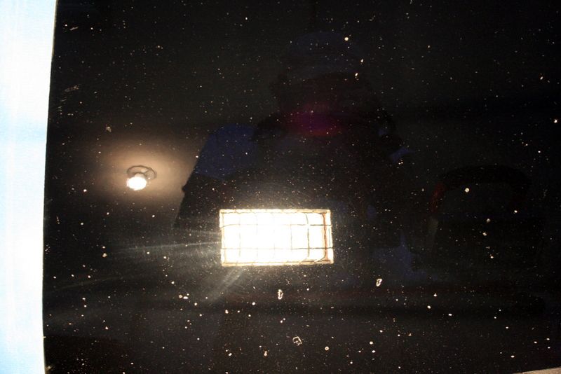

The hood was horrendous looking with deep swirling and holograms galore! the entire hood was like this...
[IMG]
/2003%20Mustang%20Cobra/IMG_4388.jpg[/IMG]
/2003%20Mustang%20Cobra/IMG_4395.jpg
/2003%20Mustang%20Cobra/IMG_4392.jpg
/2003%20Mustang%20Cobra/IMG_4393.jpg
/2003%20Mustang%20Cobra/IMG_4394.jpg
/2003%20Mustang%20Cobra/IMG_4396.jpg

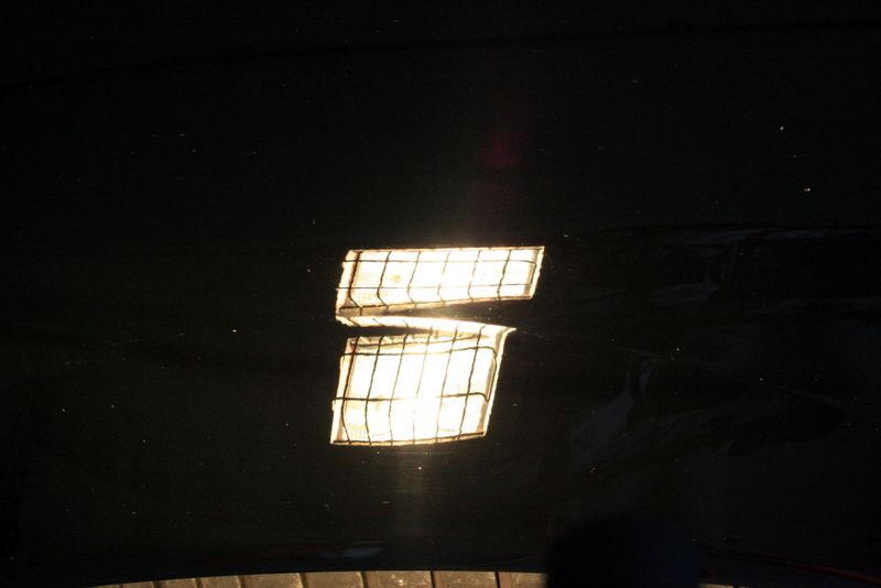

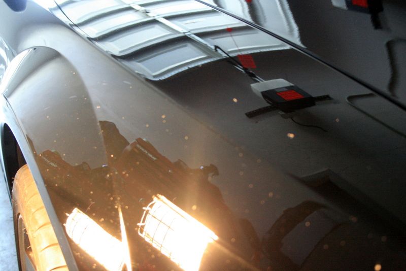

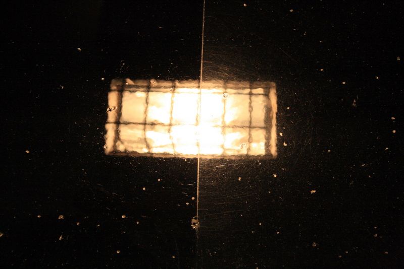

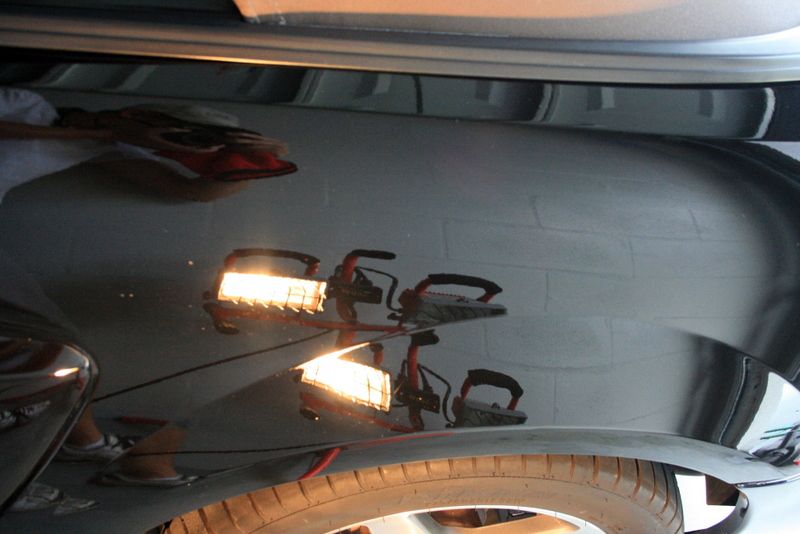

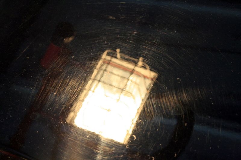

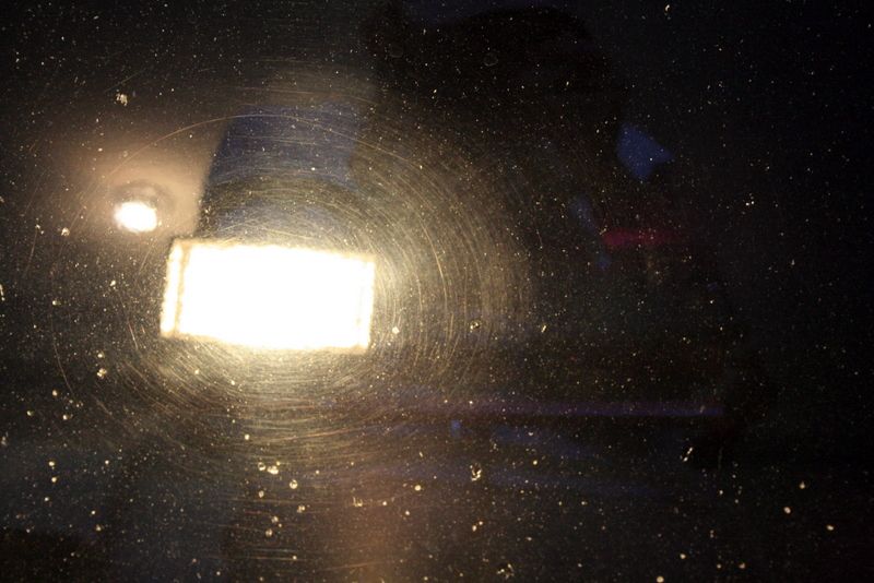

Now in the halogens.. :ignore:

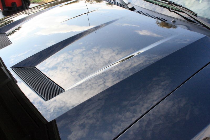

Hood..
Front Fender..
Front Fender..

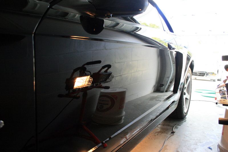

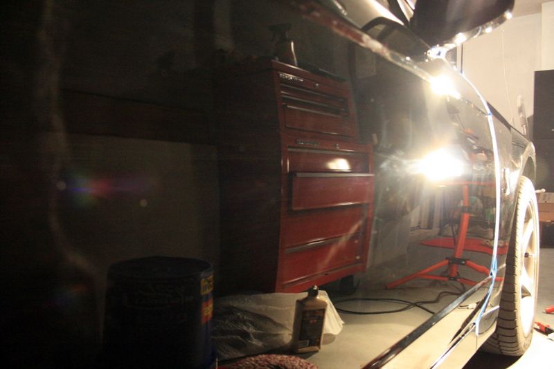

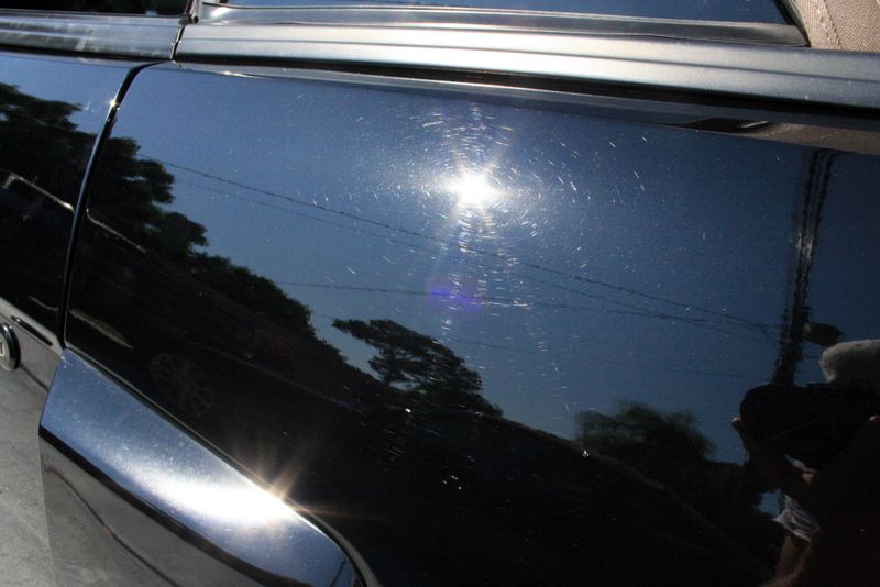

Door..
Rear Fender..

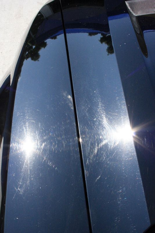

50/50 with SIP/PFW..not quite enough but almost.
This side with M105/Burgandy Wool. It left its own marring but it removed all defects very weel and in VERY LITTLE time. Was almost effortless!
This side with SIP/PFW. I got a pretty good finish with this combo, however there were still traces of defects throughout the panel and took considerably more time to remove less defects. So I chose to do the car with M105.
SIP LEFT/BEFORE/M105 RIGHT
I did a small section over my M105 panel with 106FF/LC FLAT WHITE and found no holograms just as TSC17 said! Saved me ALOT of time!

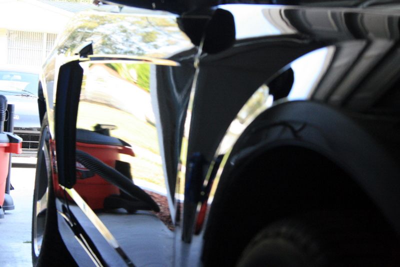

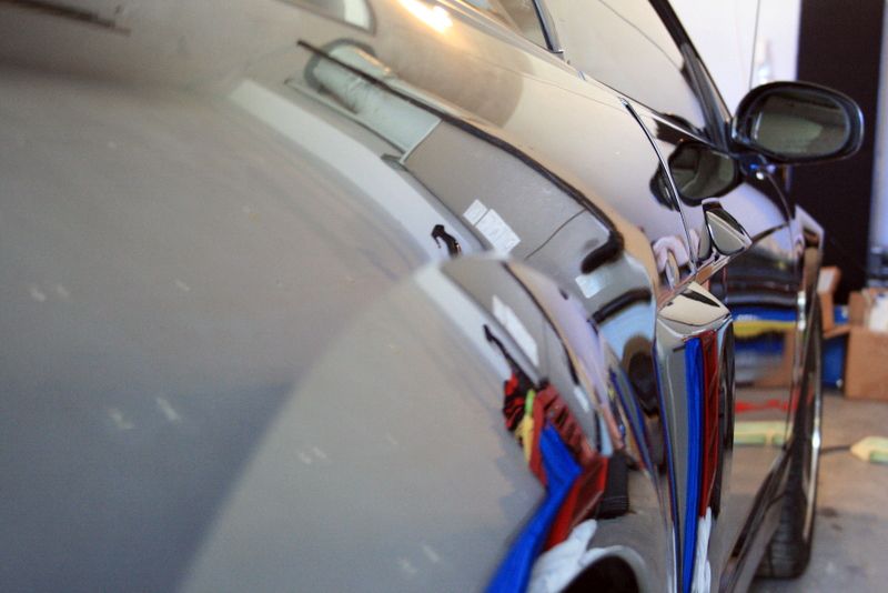

Driver/Passenger door after M105/Wool x2

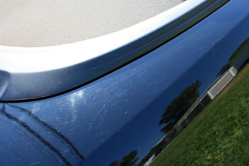

Fender Before:
Fender After M105/Wool x2

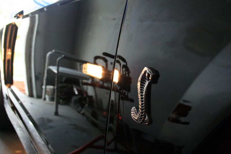

the twanksta's avatar
the twanksta

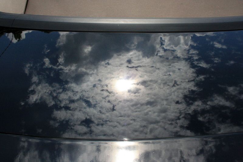

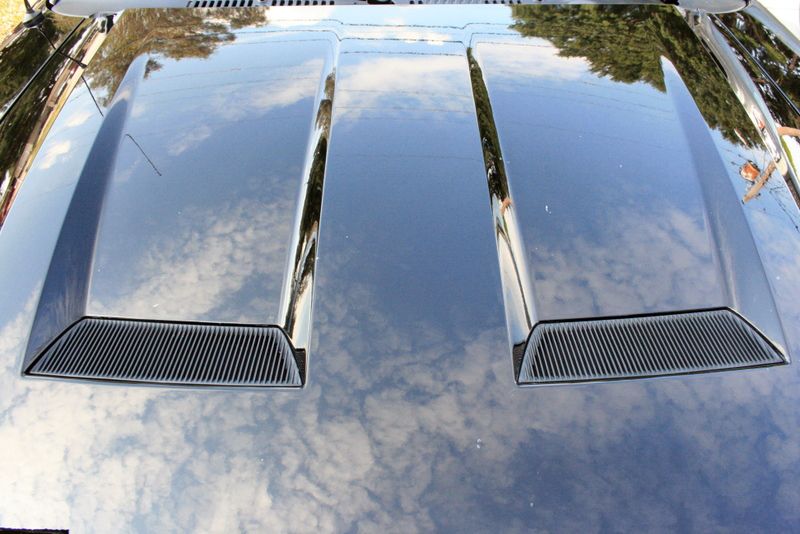

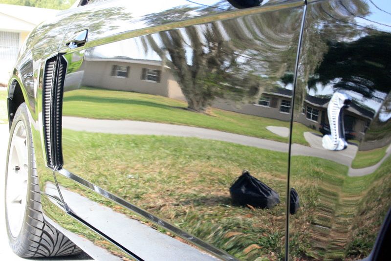

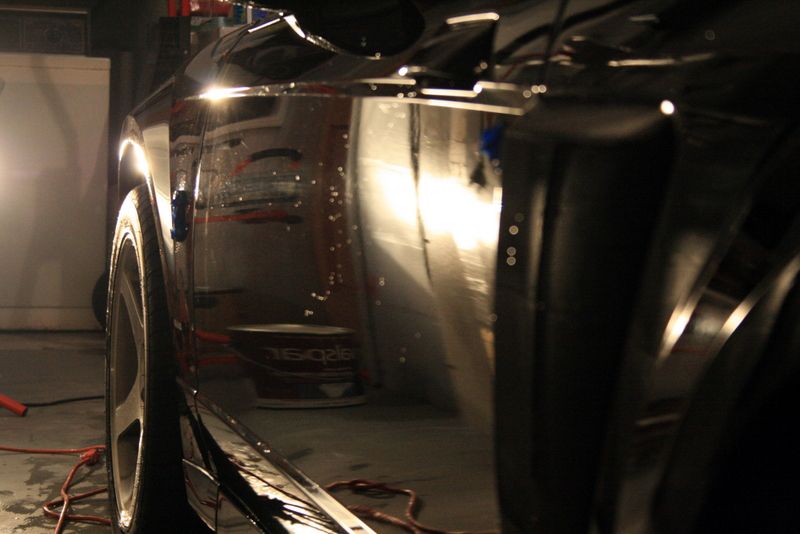

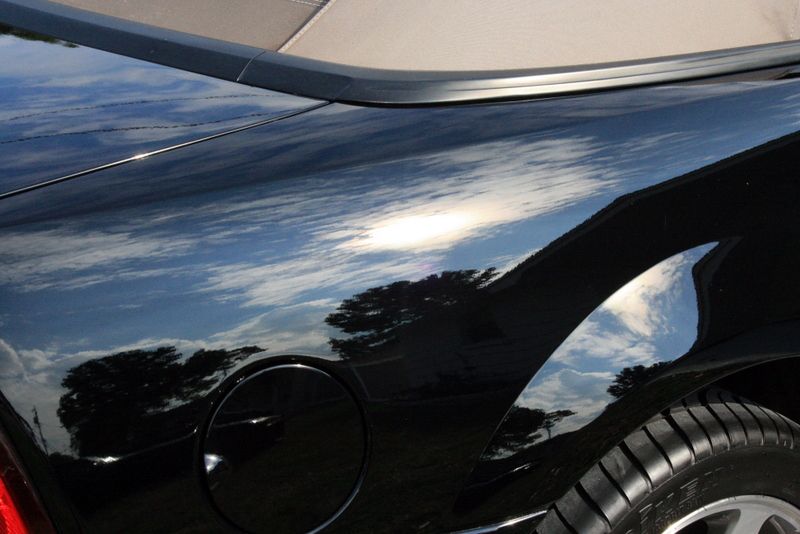

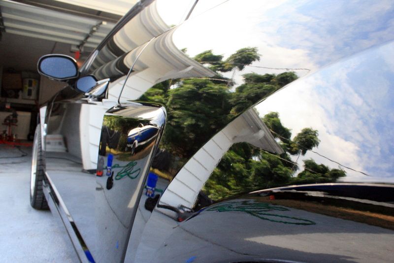

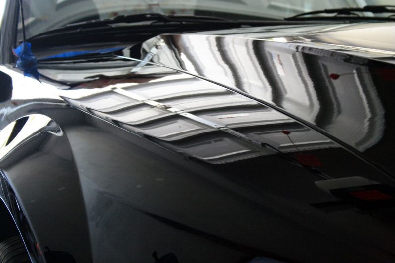

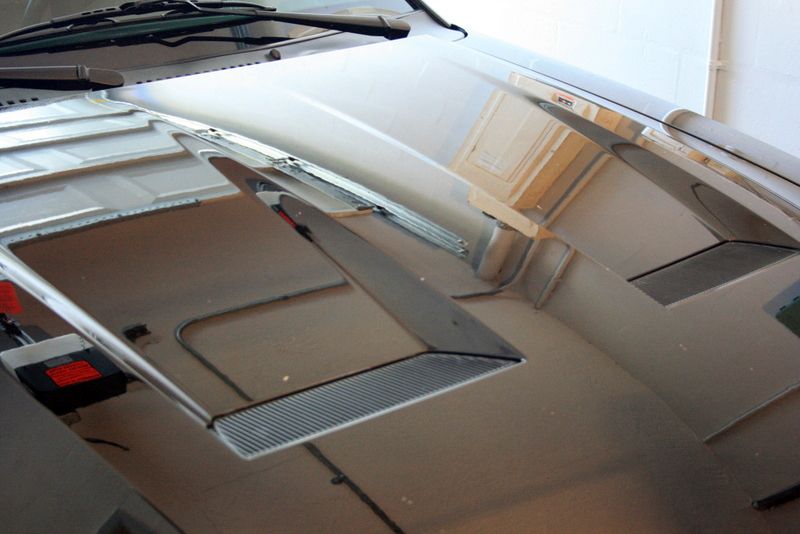

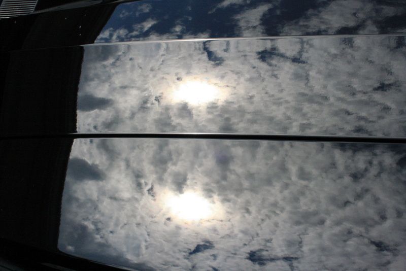

After M105 x2/106FF..
One of my favorite pictures I took..

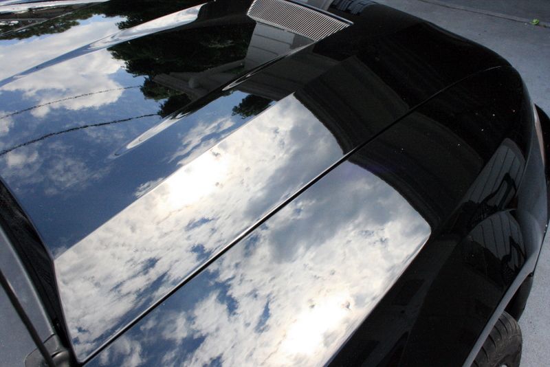

the twanksta

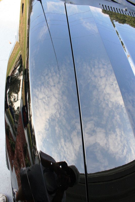

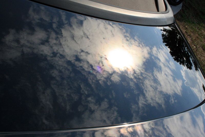

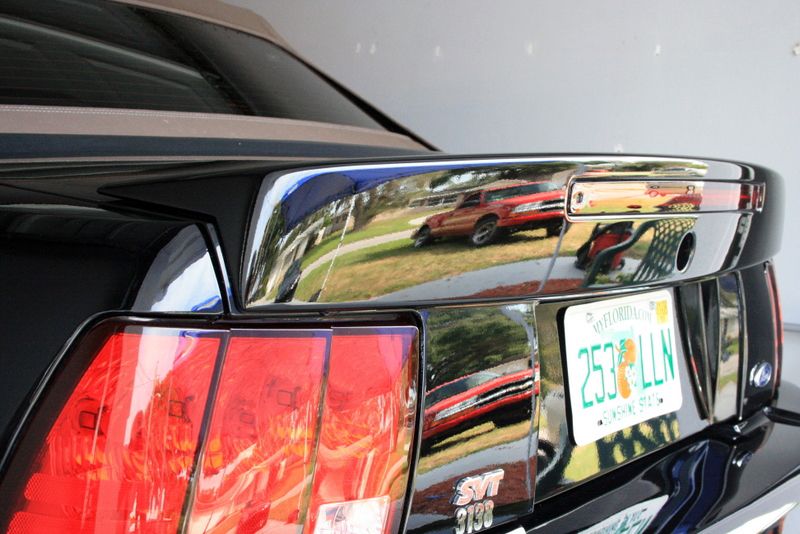

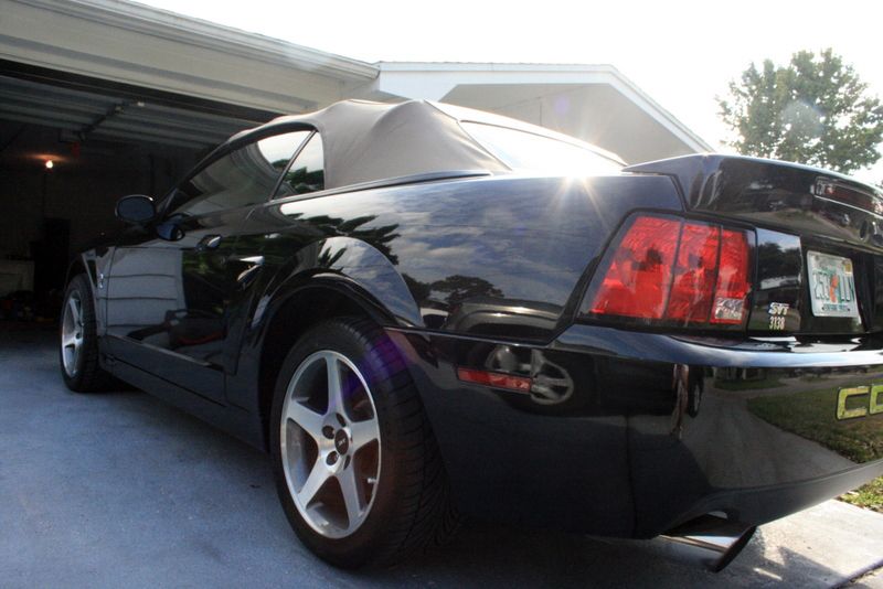

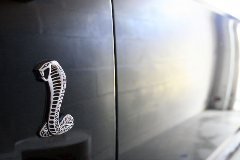

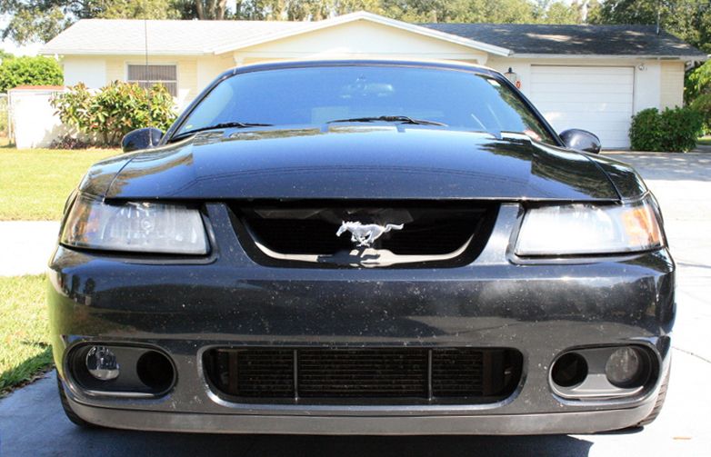

SUN SHOTS!! Kinda..there was a little overcast.
