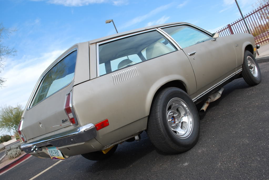

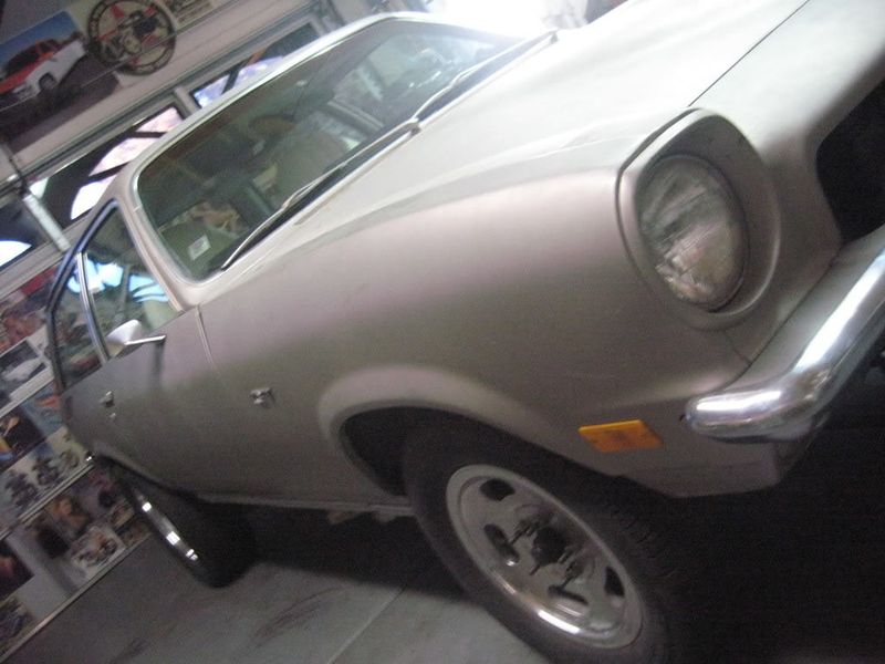

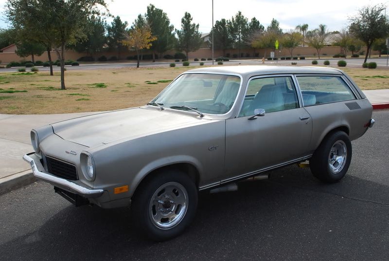

Took it around the block yesterday. Had a water and oil leaks. Fixed those, changed my water pump pulley. Put most of the interior back in. Cleaned up a bit and rolled around today. No leaks no issues.
Exept. My rear axle is not located right. The drivers side wheel base is an inch and a quarter shorter than the passenger side. My own screw up. The car was repaired and I second guessed the mounting holes. Anyway I will relocate it and put in my new adjustable lowers, drag bags, and slapper bars today. Might be a little over kill but...oh well.
Need a better exhaust. The pipe from the collector to the muffler is too short and mufflers are hitting the floor.
I wanna put a tilt column in. I have two, just seems like alot of work that something I wanna sell. Again, if I were keeping it, I would cutt the seat posts down. The seats are high from when I put in subframe connectors.
ugghhh its hard to build something that your not gunna keep
Oh its got old sonic turbos... crazy huh?

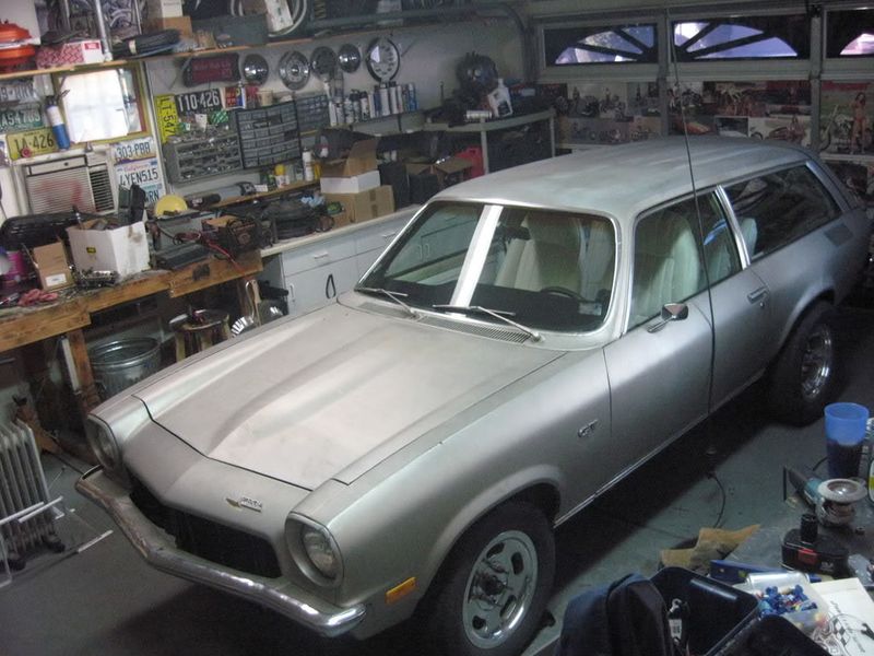

Put on the slapper bars, relocated the rear. Still feel like I am getting wheel hop. Also, Im gunna have to do something with the linkage on the shifter arms. Keep loosen 1st. Need to retune, falling over at 4500 rpm. Need to redo the exhaust. Plates expired in 05.lol Its been on the back burner for awhile.
This fnnn thing is endless...damn!

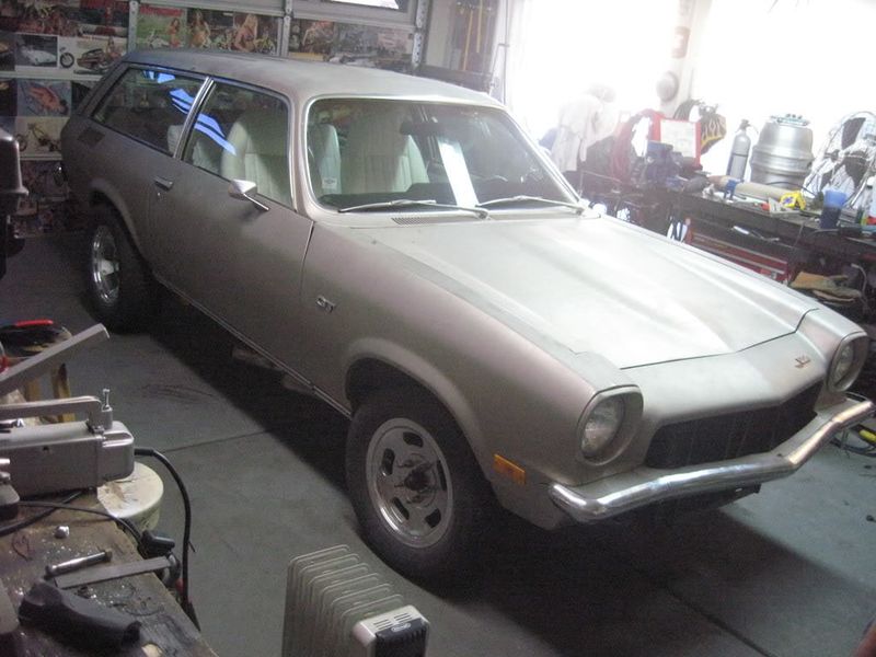

Did ya all notice in the last pic the big poster of my duece above the garage door?
