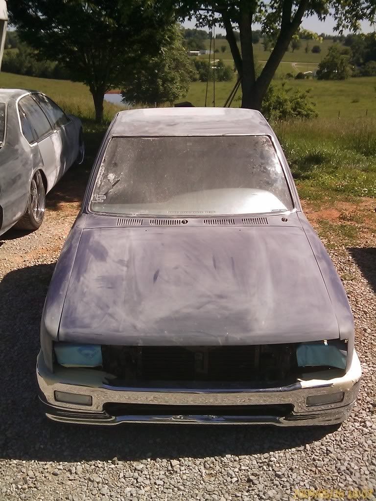

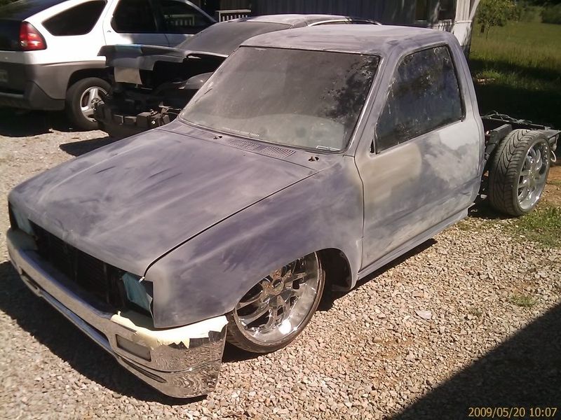

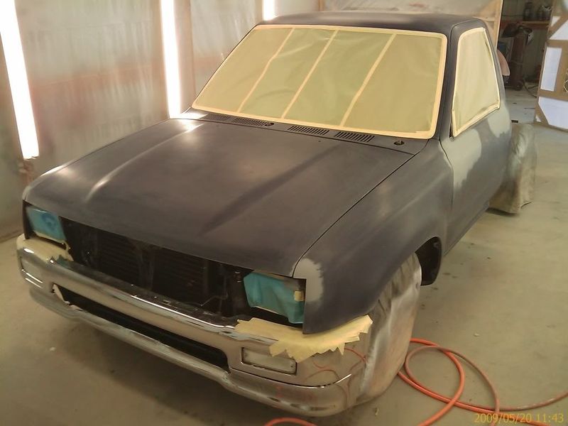

First came the most painful part.. Takin off the nice shiney stuff
Most of you that seen this truck up close knew I had some filler cracks in places.. So those needed to be ground down to fresh metal and filled

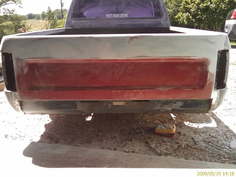

And the worst of it all.. THE BED
Next is the roof where I shaved the brake light.. .The roof about as stright as two boys blowing eachother
next was figuring out why the roll pan was cracking up behind it.... The guys that did the body work prior left no where for the water to drain and kept the factory roll pan in place... therefore water built up behind it causing it to rust
slammedtoys's avatar
slammedtoys
Some cleaning and shaving and bringing back that nice yota dimple

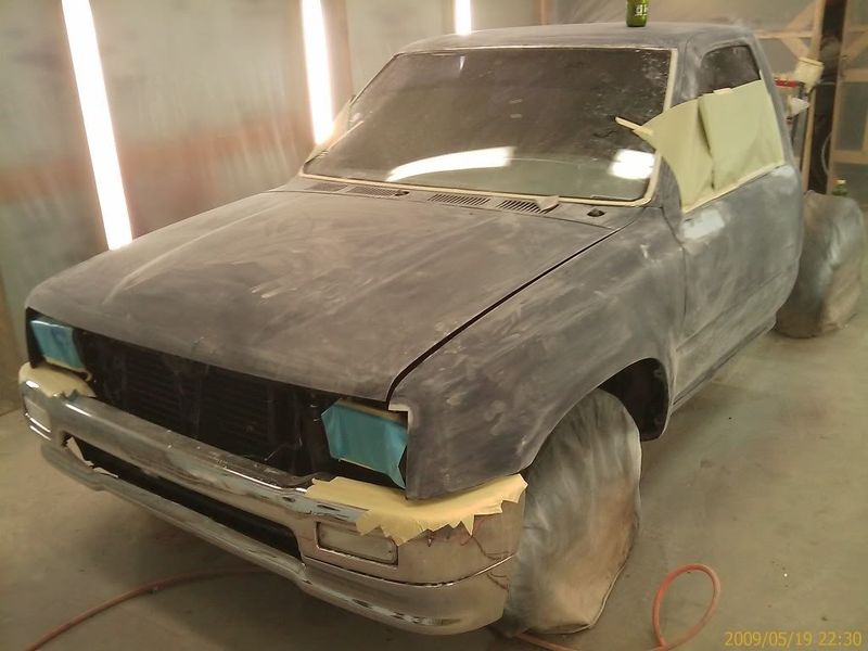

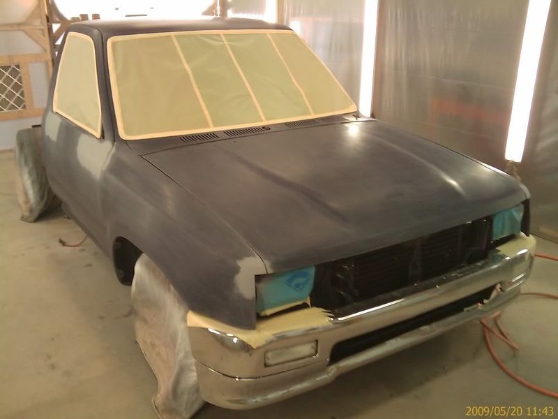

spraying the body work so it can be blocked to prefection
Razor sharp roof line

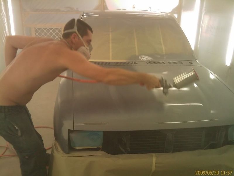

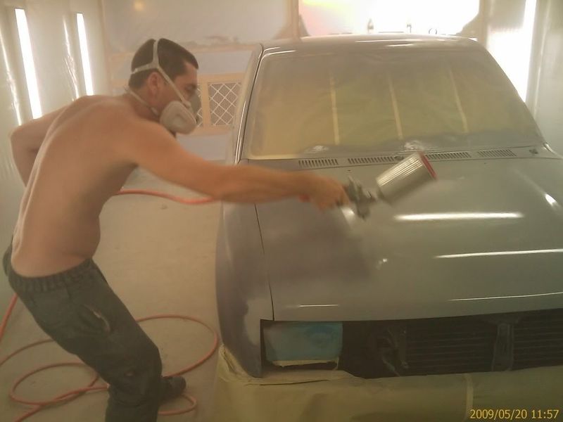

In the booth getting ready for the sealer

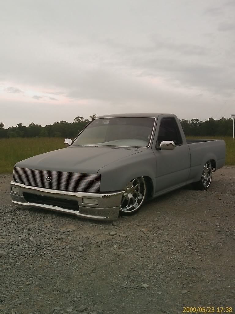

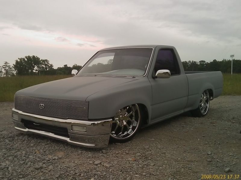

That Lost Cause love
Special thanks to Lost Cause for all the late nights we spent preppin this piece of shit... Marla and the kids for thier patience and little homie Trey Stack for his bad ass body work! Thanks guys!! This fucker is gonna be sic... watch out now!
