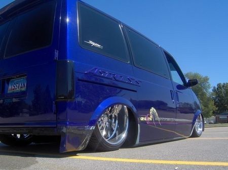

DAMNNNNNNNNNNNNNNNNNNNNNNNNNNN   Sick van!! Marcus........... Thanx for the little info.
