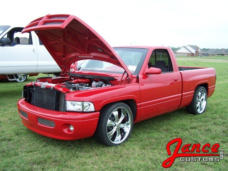

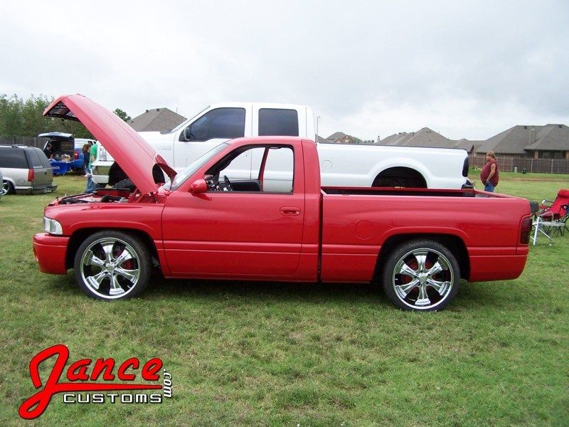

You can get 22's to fit without having to do body work as long as your width and offset is correct. I would try to get 22x8.5 in front if you can. I have 22x9.5 with a 4/6 drop on my 2000 Ram and I can't go any lower because of the width and offset. I think mine is 15mm offset. If I had a little more room, it would be lower but right now I would be hitting my fenders.   Yes that is a 4/6
