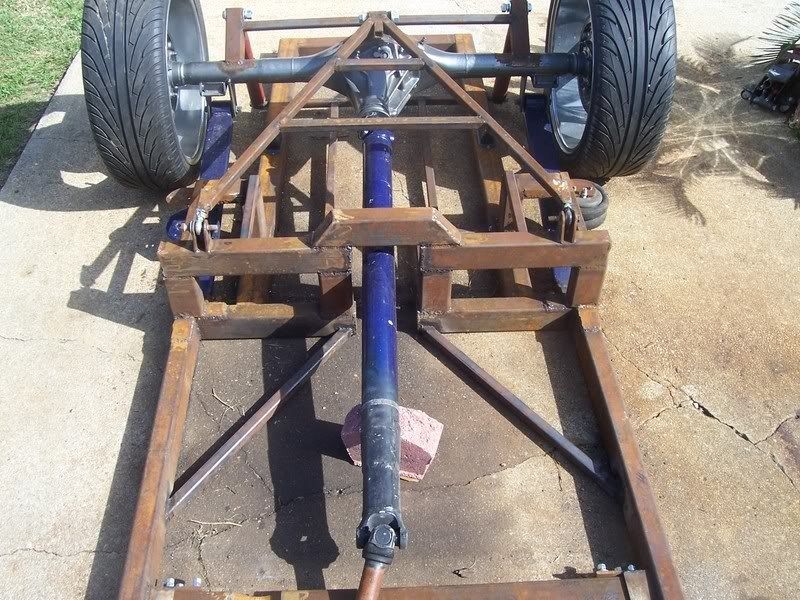

i ilke them have not many cons other then its a lil more challenging then a regular over the axle setup this is my 2runners and is the 4th one ive done

the lift is a key downer to most, i understand that..... i have the kp 6 link and its bitchen as hell, nice lift but ive noticed other than lifting to detail the 18"s, i rarely raise it past the rims lip.

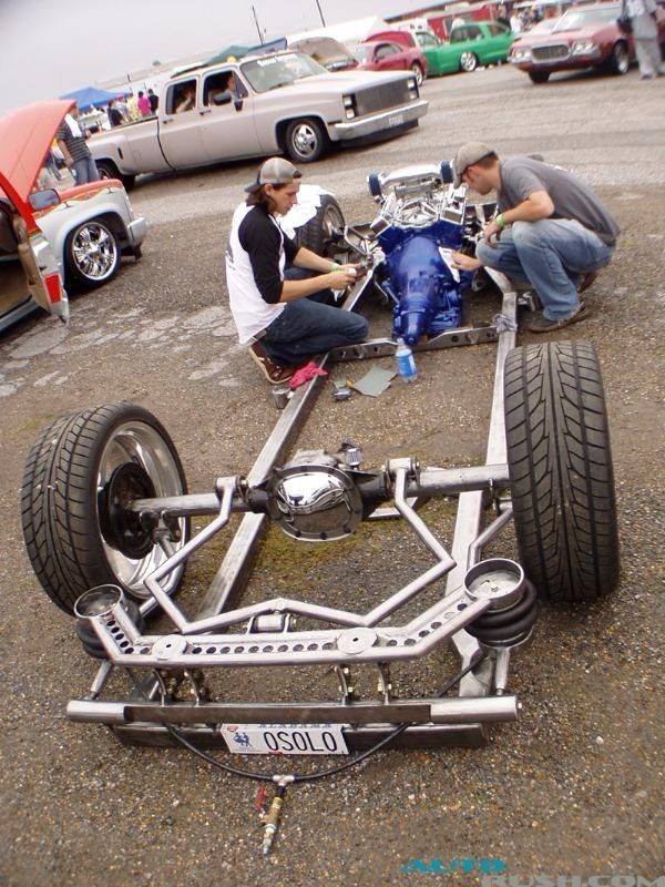

talk to mike littleshoplackey, his blazer has an underslung frame. sickest one i have ever seen. such detail. L.S.O.H.

before the haters start in on that pic of the blazer chassis, the link setup is muchos muchos beefier since that pic was taken (which was when we were debuting the chassis/engine at showfest 04). Links were re-built and gussets added out the buttocks. okay, now bash away

Man, those links need to be rebuilt and you need more gussets..... oh wait NM. Seriously though, I love that blazer!!!!!
