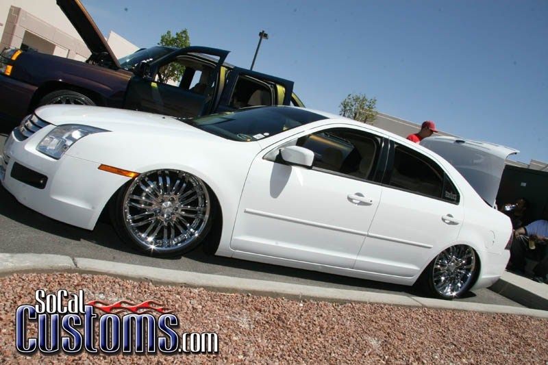

What up fellas, Look i put 22's w/ a 245/30/R22"s on my fusion & when i turn they rub the plastic inner fender wells! Okay... if i remove them or cut them out to fix that problem, will water get inside the car to where my carpet & shit is wet! Thanks...

No it won't - mine rubbed so much on my car they almost fell out so had to pull them all the way out. that plastic isn't what is keeping the water out

You can also heat the plastic up with a heat gun and push it back away from the tire. Use a hammer or something, it might need a little coaxing. Also it is a good idea to have a fire extinguisher nearby or a big cup of water, trust me....lol

You'll be fine, there is also an extra inch or more space between the plastic and the steel inner fender below.

You'll be fine youre just gonna have to clean the engine compartment more. all the inned fenders do is pretty much keep dirt and water out of th eengine compartment but you wont have any issues TEAR THEM OUT. Car looks sick by the way.

I took mine completely out (I have a 500.) You are fine, you can also run a smaller tire.. width wise.. a 235/30/22 (I have them) that would probably help your situation out more.. but yes, you can pull the fenders out.
