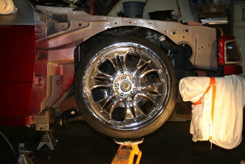

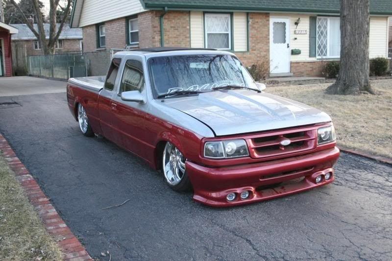

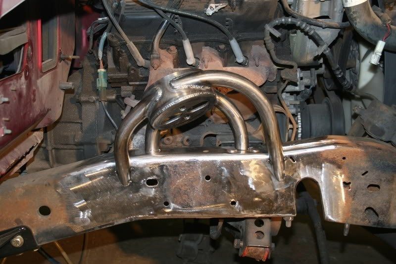

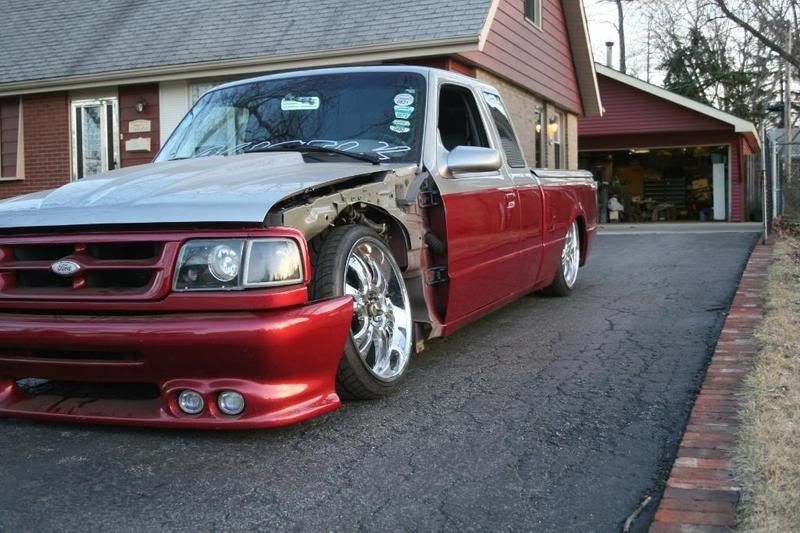

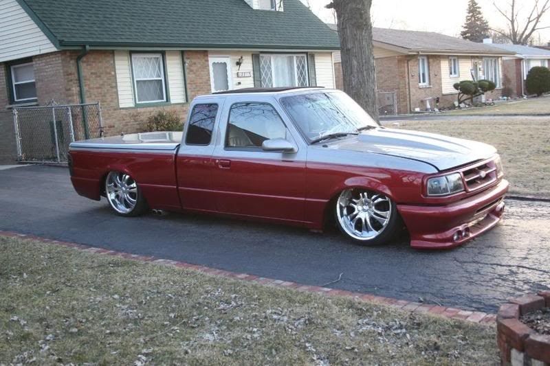

My buddy Ed is redoing my front to lay out on 20's. It was originally done to lay out on 18's but I finally grew up a little. JIMMY
Before:
The little trianlge piece was supposed to be steering stop but the shop before must not have realized that the piece was pushing my calipers in when I turned lock to lock, that piece is no more
some other before pics

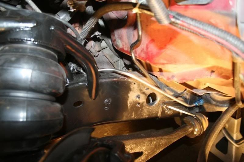

bad bag geometry due to the fact that no radius relocators were installed plus the abag mount angles were off
Everything went bye bye
correctly done to start with the radius mounts
crappy welds IMO

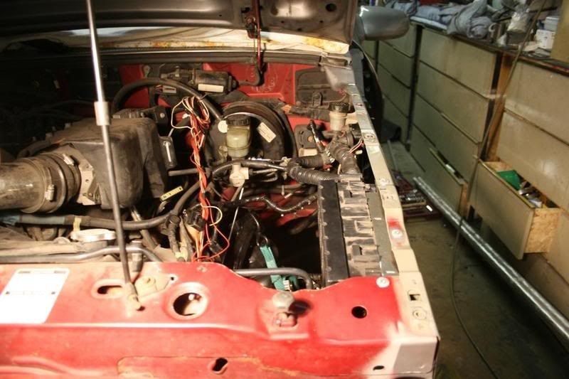

out with the old

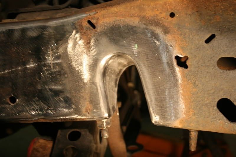

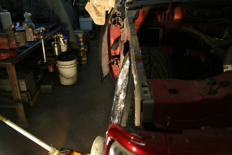

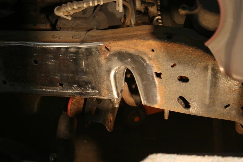

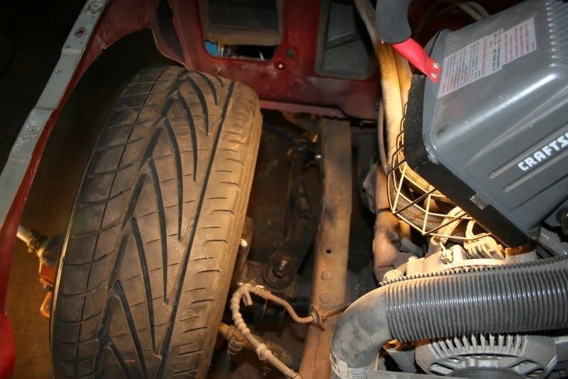

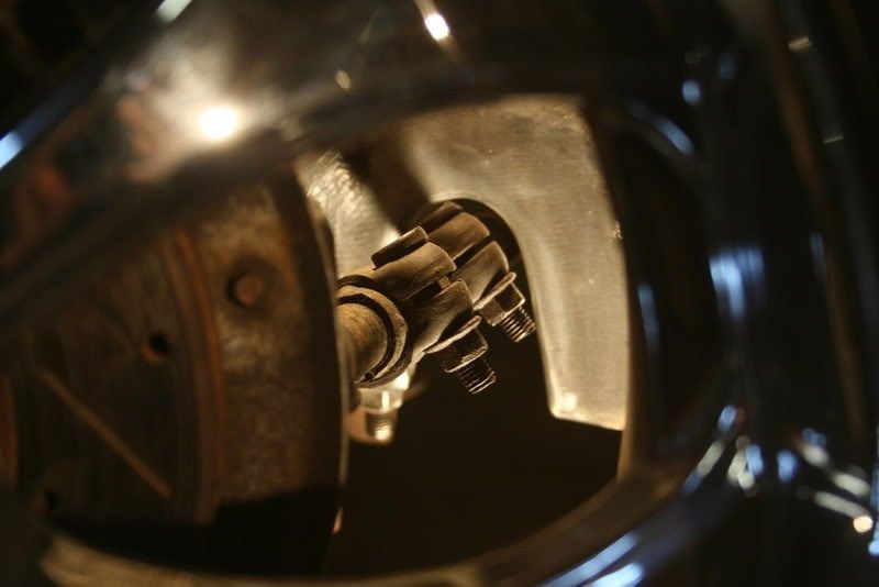

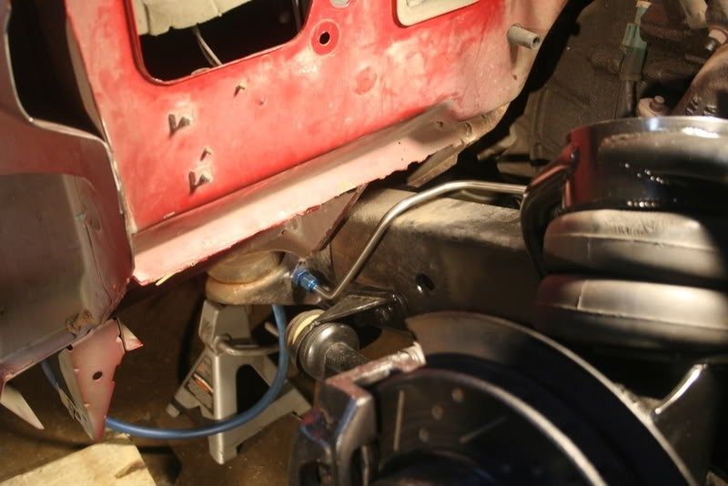

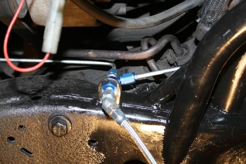

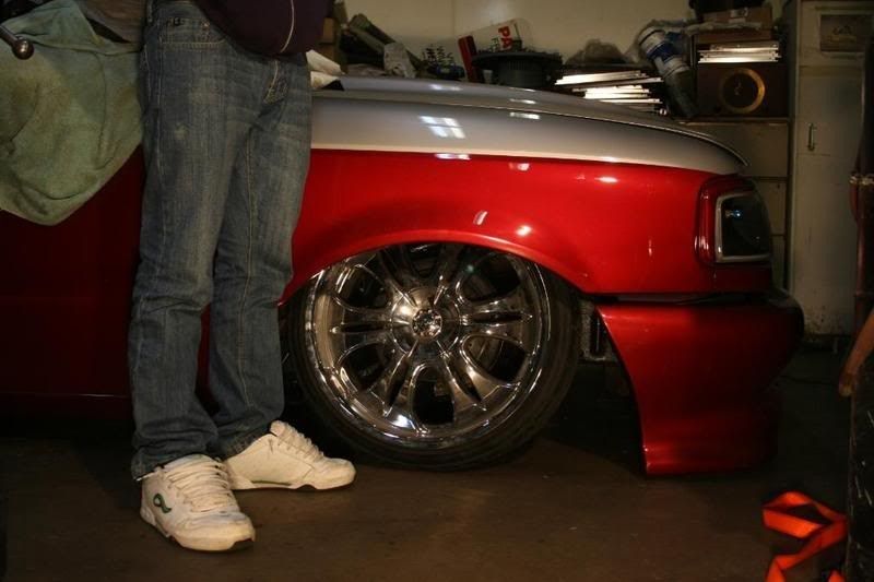

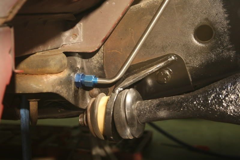

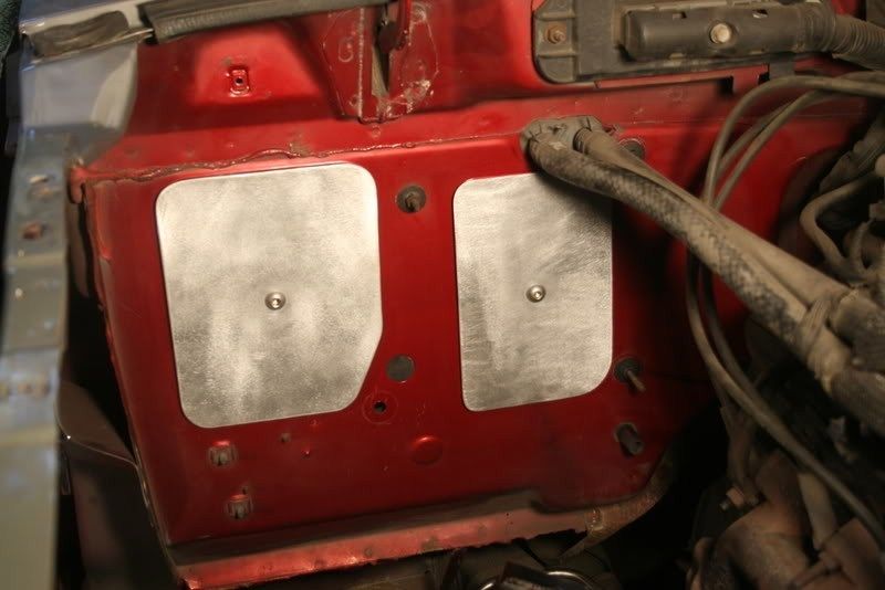

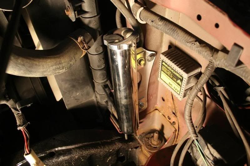

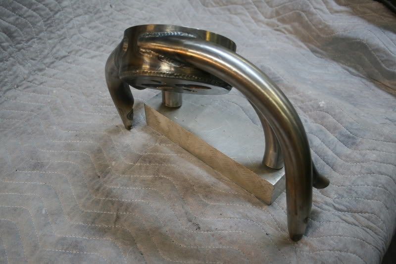

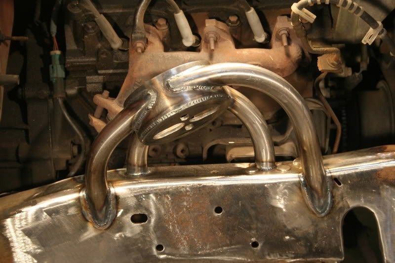

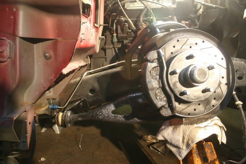

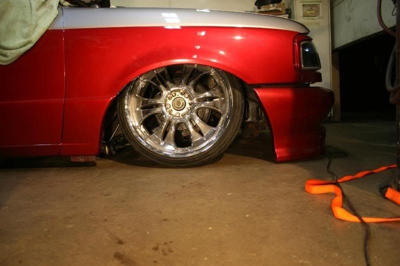

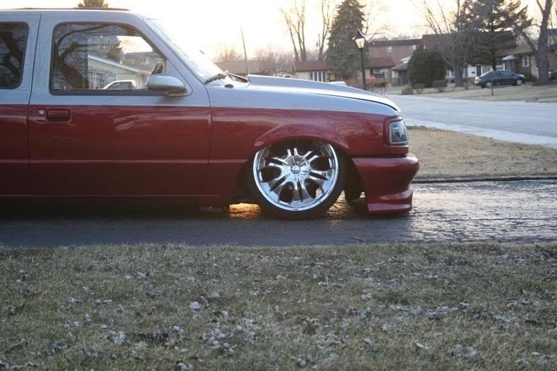

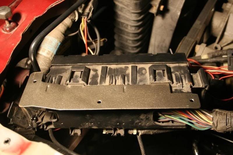

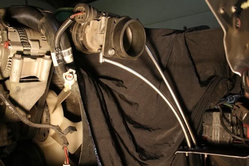

Updates as of 2/20/2007tie rad notch on pass side doneplenty of room to move around, also more room for the EDCfender wells cutnice camberpic of tie rod in notch thru the spokes of the rim, kinda a cool pic
Drivers side is being done as we speak.

The new work looks really professional. Nice work.
the new work def looks good

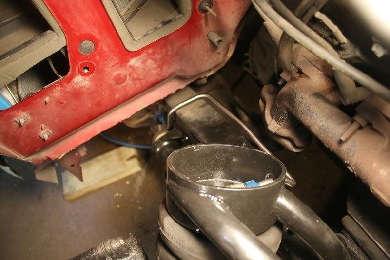

grillift

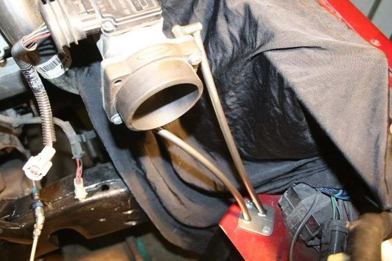

hey jimmy can you take a pick of the radious arm relocator from under the truck. I have the same one as everyone elss but mine exhaust is right in the way.Thanks
grillift
total dick move on my part. the work looks really nice. I'm looking to do this to mine after the FF show.

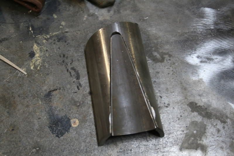

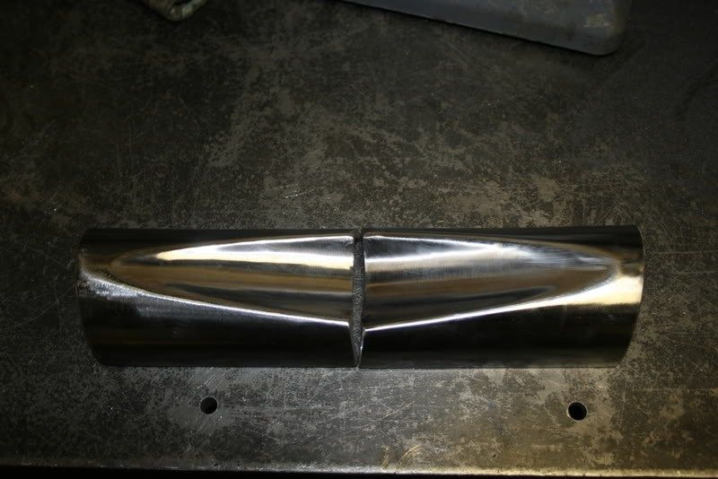

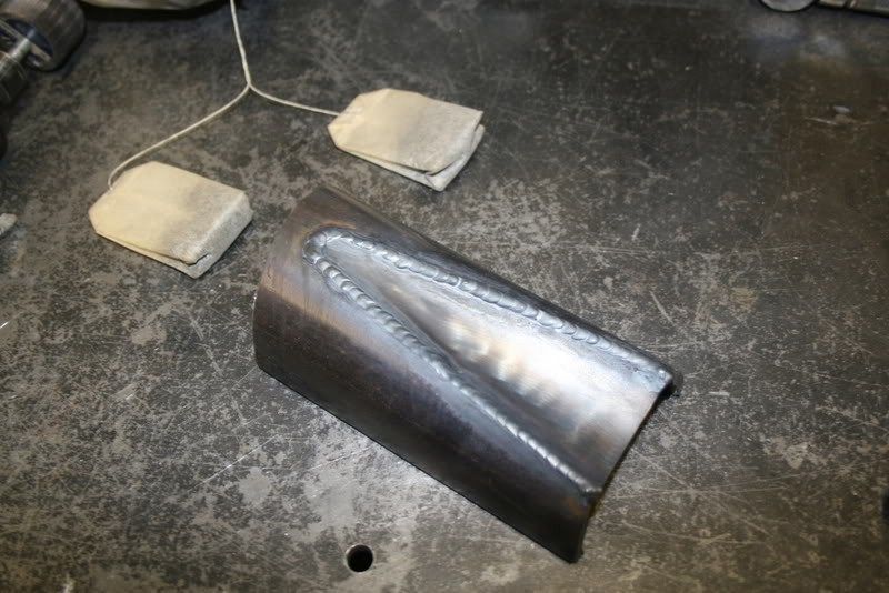

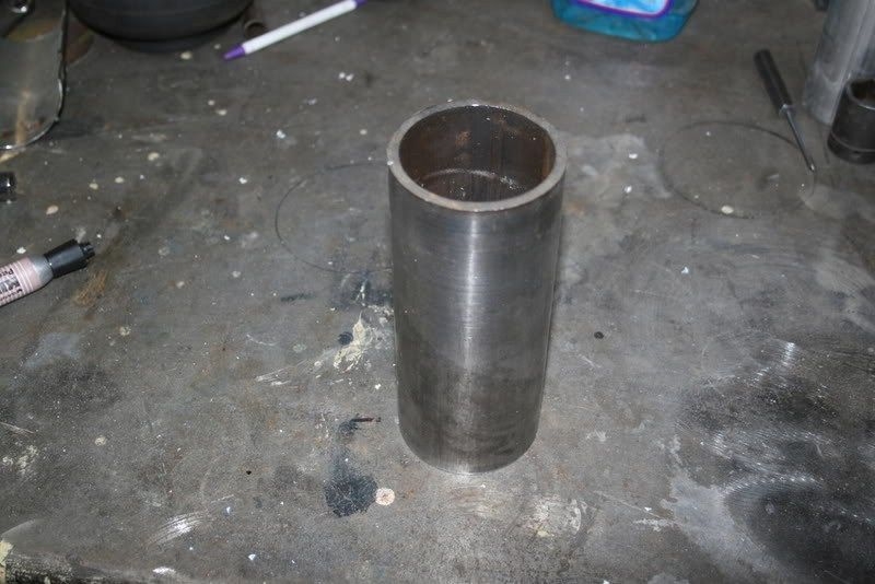

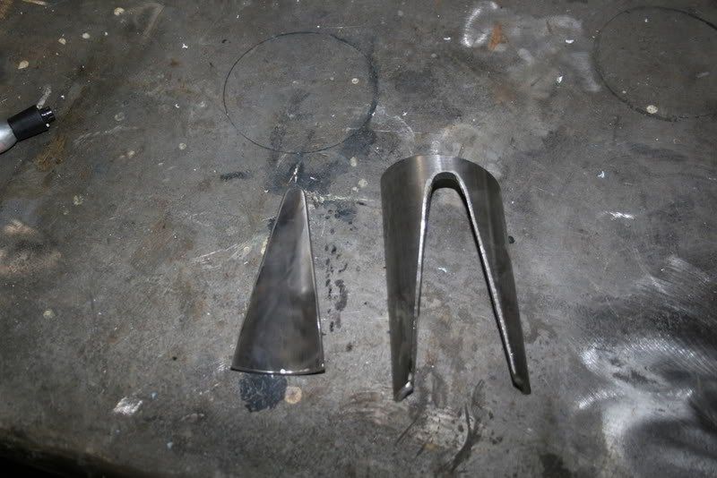

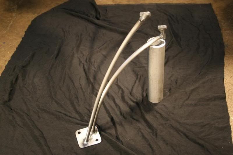

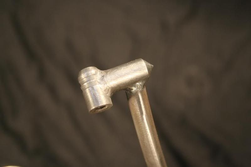

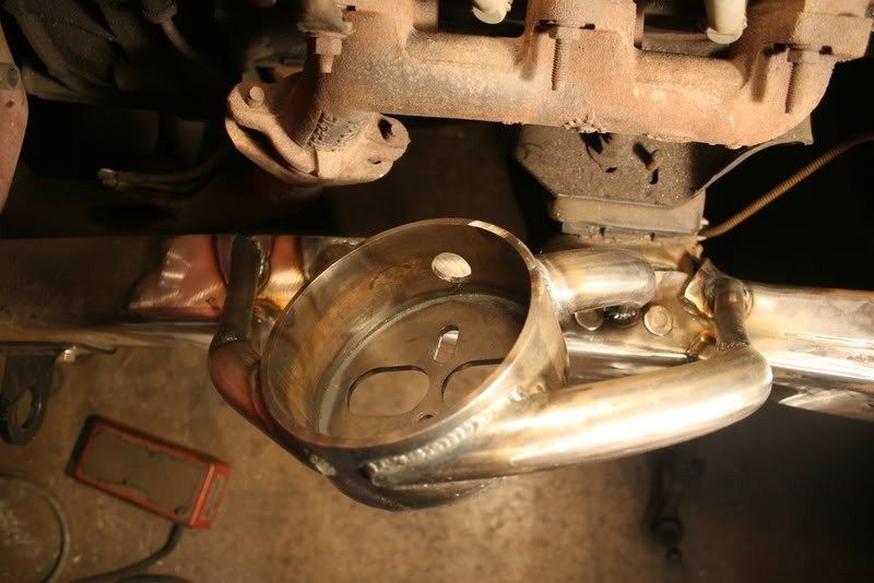

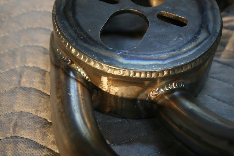

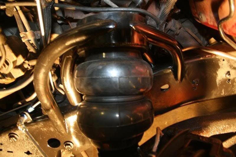

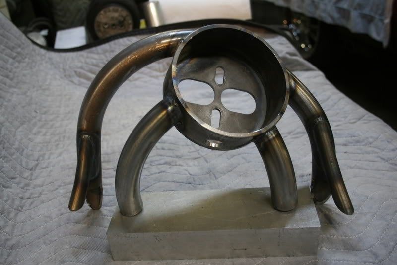

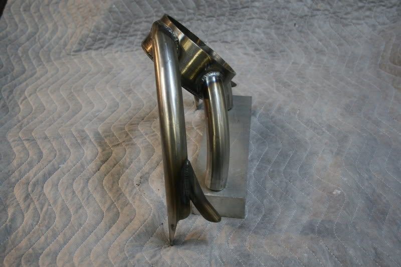

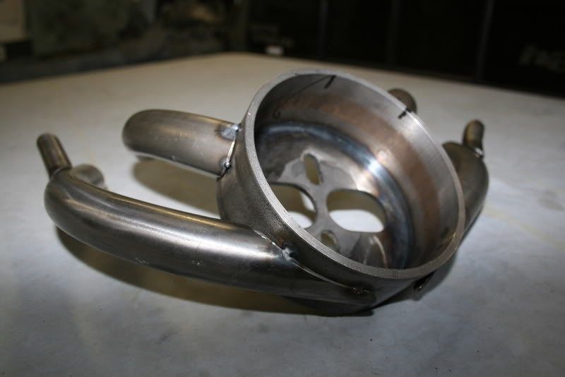

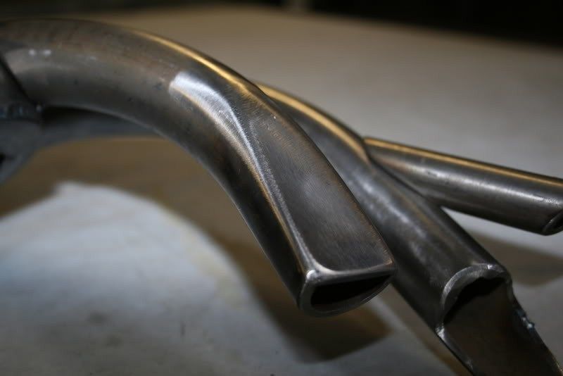

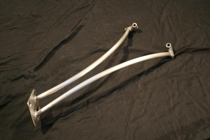

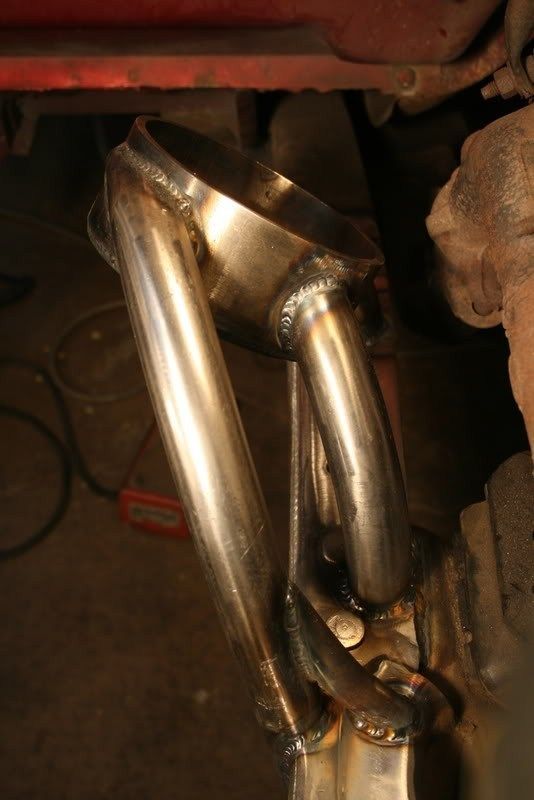

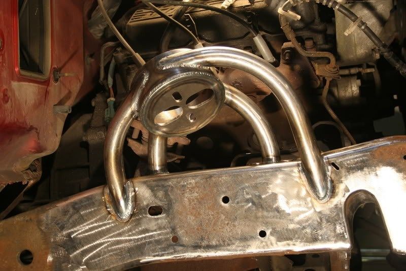

here are the lower bag mounts. JIMMYlower bag o mounts started as a tube
