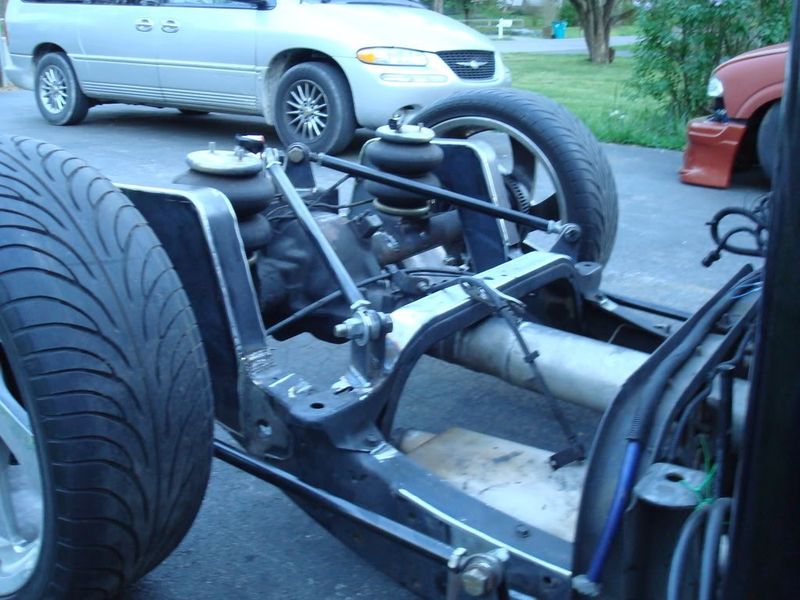

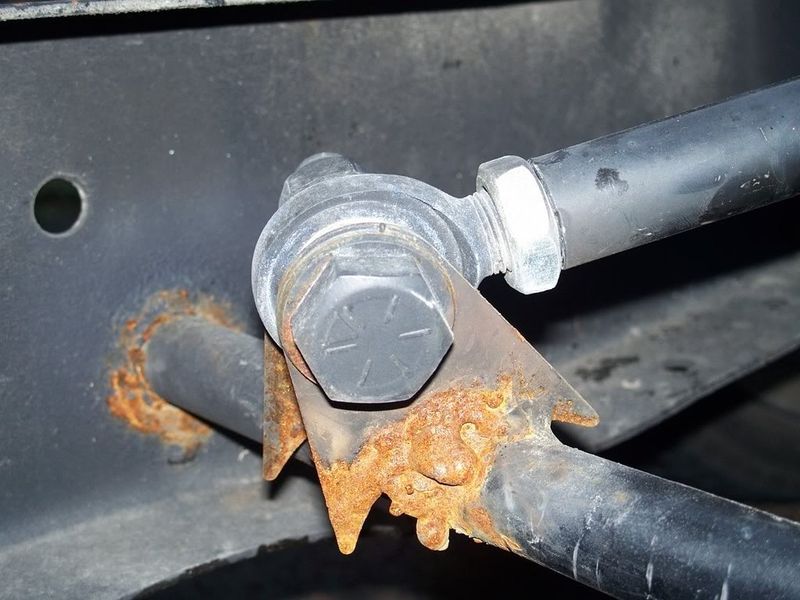

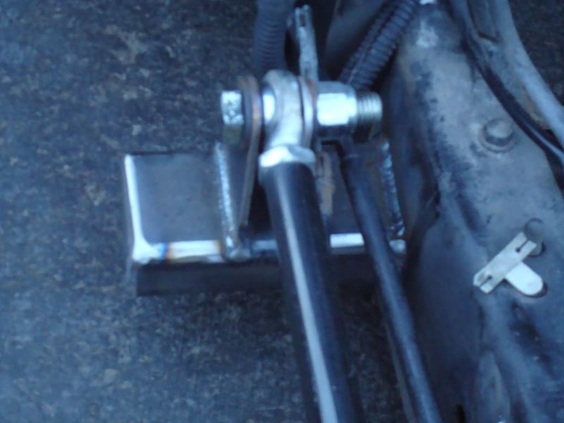

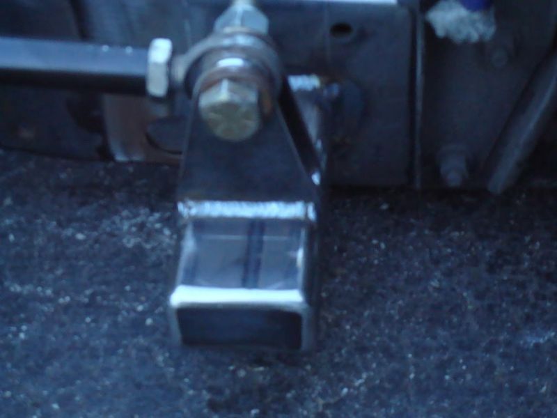

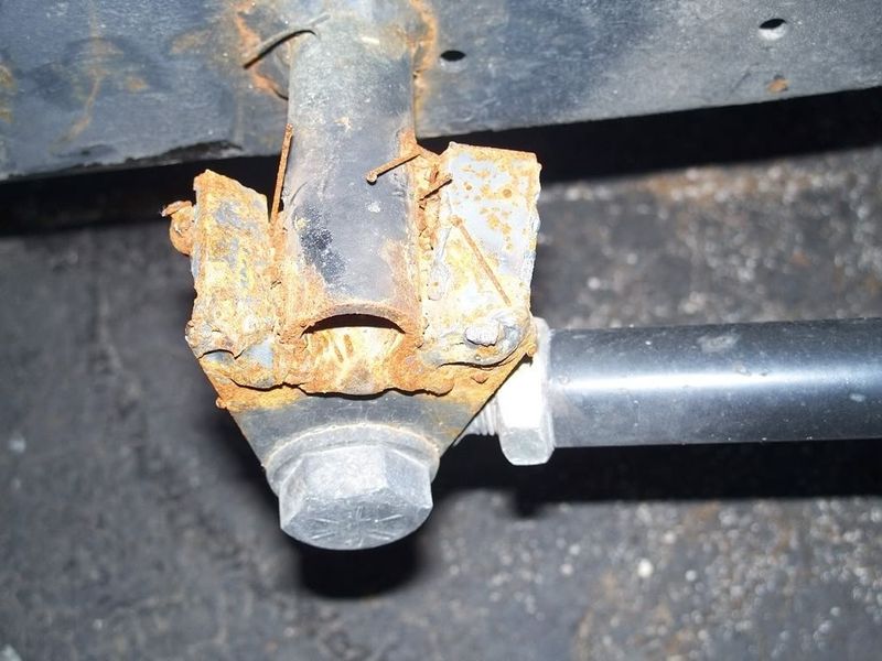

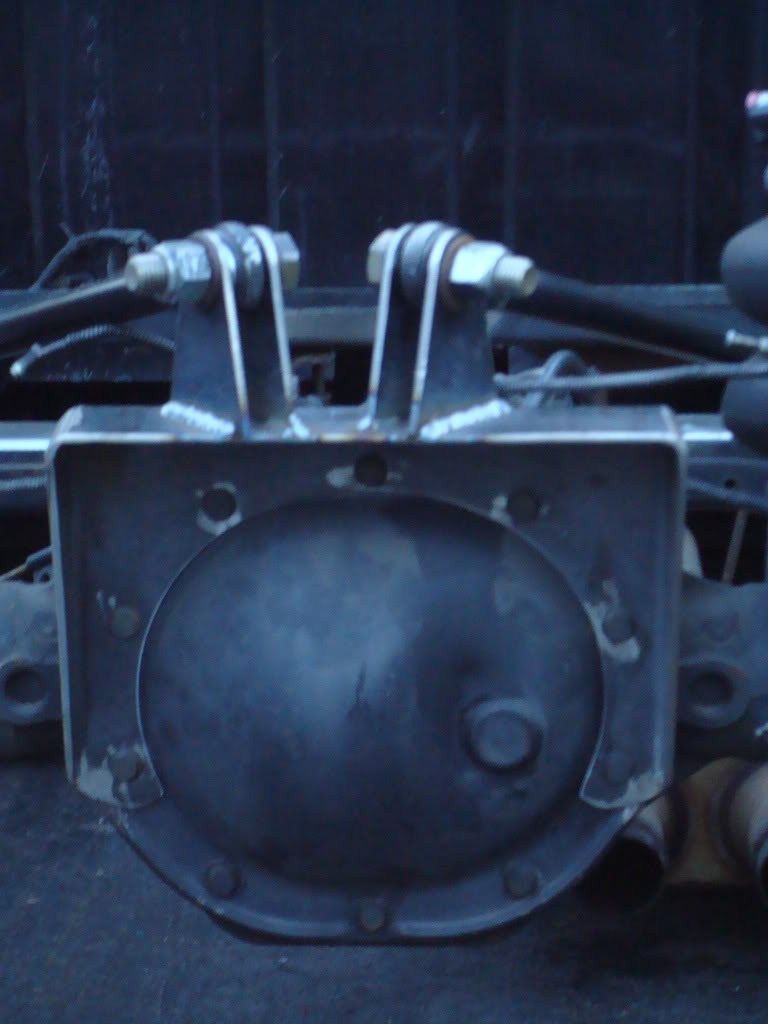

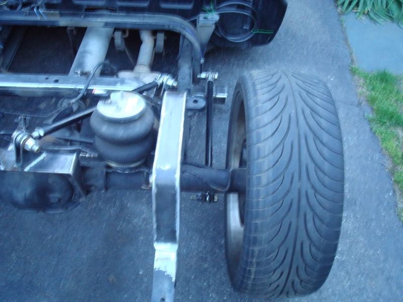

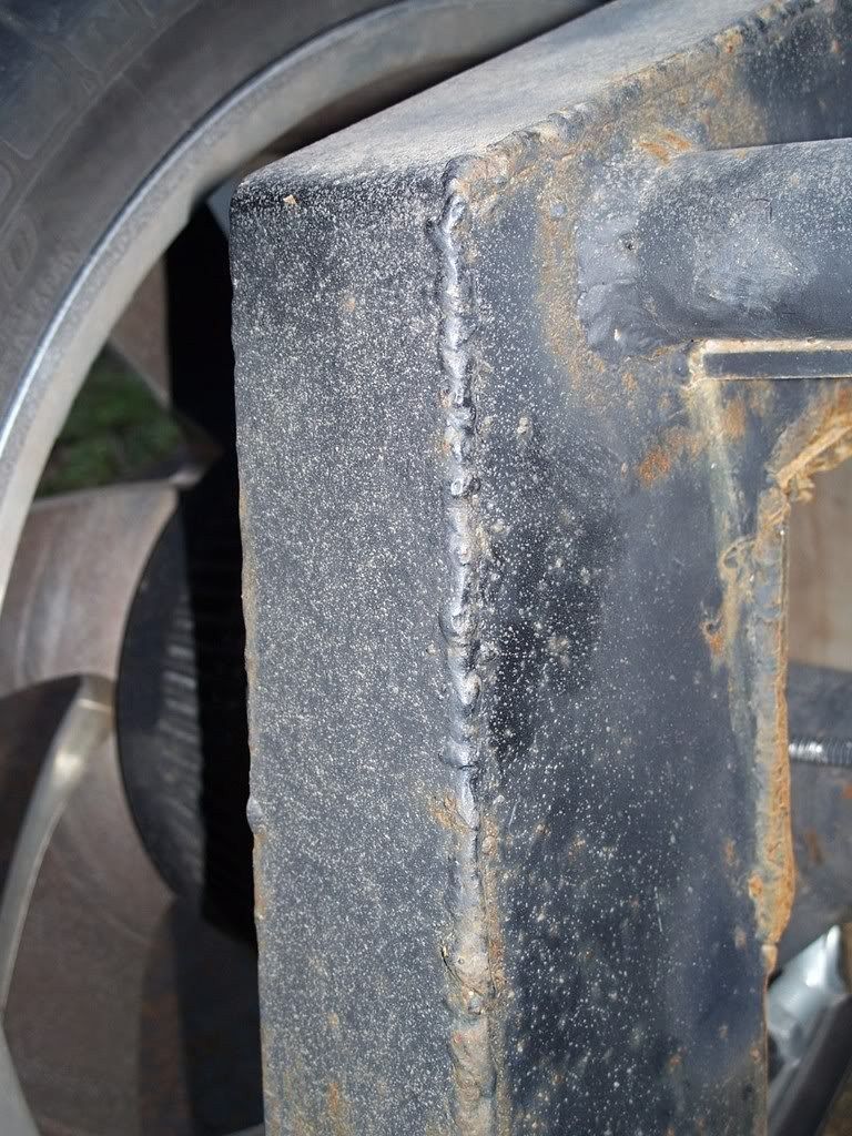

I don't know how most of you feel about calling someone out on their work but I'm going to do it anyway. If anyone knows Doug Poston in Bowling Green, Ky PLEASE tell him to STOP BUILDING TRUCKS before he kills someone. This guy calls me up Saturday and asks me if I can come weld a bracket back on his Dakota. I go over there and it's not a bracket, it's his 4-link that broke while running 65 mph. Doug no offence you would have been better off using JB Weld, you can not weld over paint and grease, and you should clean the slag from the parts you cut before welding. It was to dark last night when I got the truck home, so I will take pics and post them tomorrow. Sorry guys this kinda of stuff just pisses me off.

Alrighty then. I posted some of the pics to my profile. Tell me what you think

wow ummmm wow that looks like total poo and very unsafe...he must be one of those guys that thinks he can weld a bead by not using a shield and blind welds with his eyes closed
