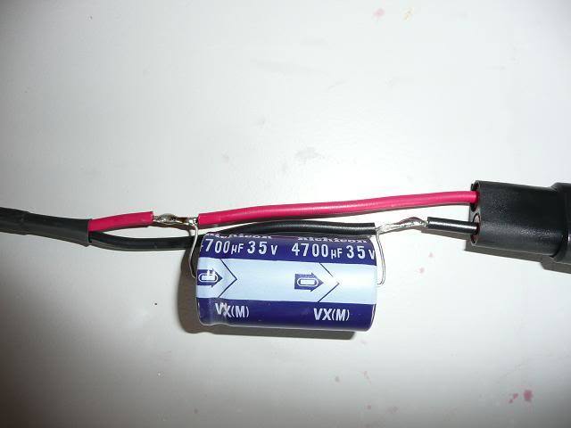

Yeah in my Chrysler, I installed some retro HIDs and found that when my car was running it was like a disco strobe light show... off it was fine. I did a little research and this is what I came up with, inline capacitor. They had been working great ever since.

The cap trick is cool just keep in mind it will not do the job I'm describing with the headlight harness. Without the harness you still have the heavy current load on the factory wiring/switches and they're not up to the job, on our trucks (and most other vehicles, too). The relay harness powers them straight off the battery and changes the factory harness to a very low-draw circuit just to operate the relays. It's pretty much a plug-and-play deal, even easier than the cap job you did on the car.
