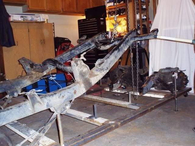

Ive been working on this truck little by little as I can over the past month, its getting a SFBD and the works to go with it.
The Day I Brought It Home
Pulling The Motor w/ Custom janke Hoist. lol
Finally A Clean Slate to Work With

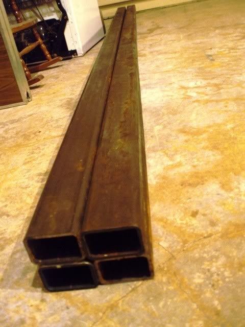

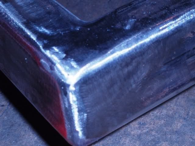

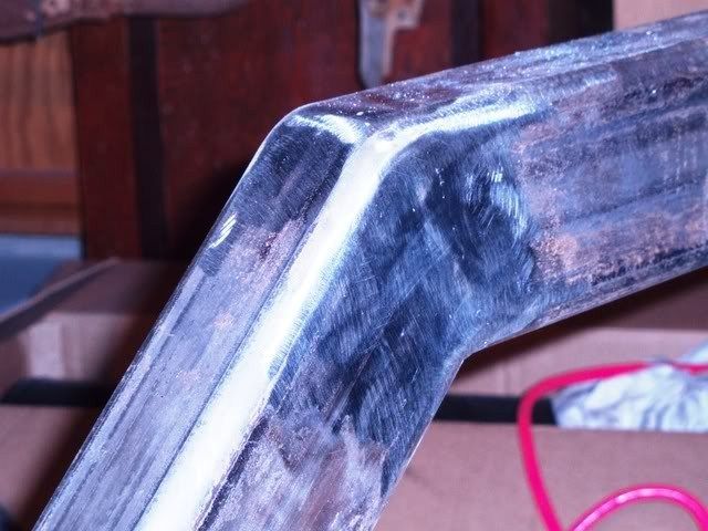

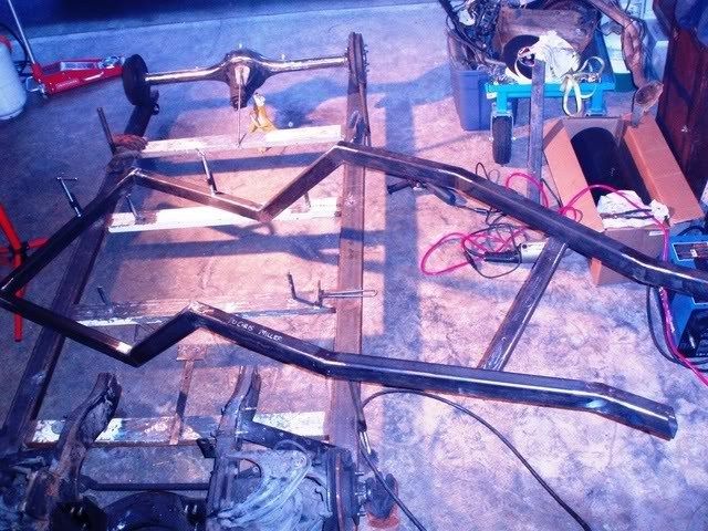

Got metal, 2 x 3 x 3/16

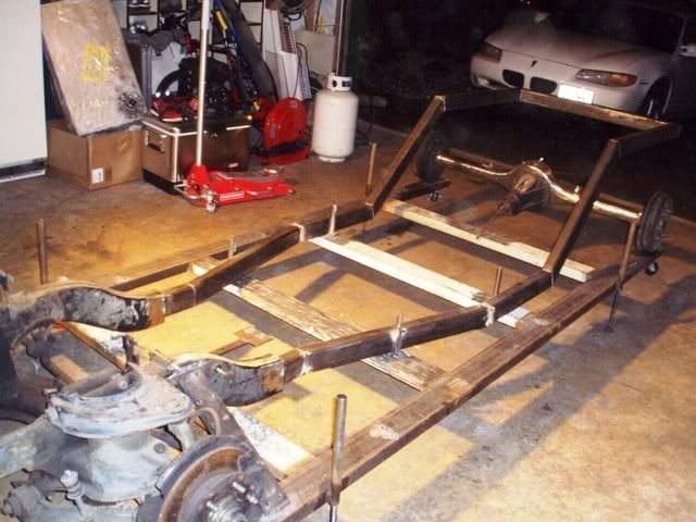

Cut out the new frame rails

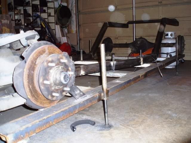

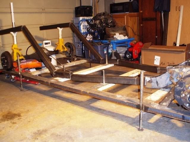

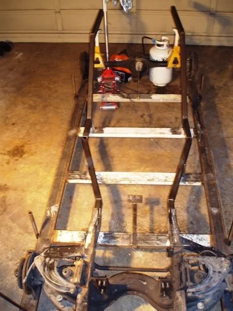

New rails tacked and mocked up

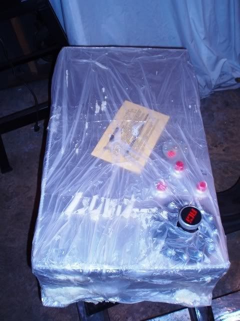

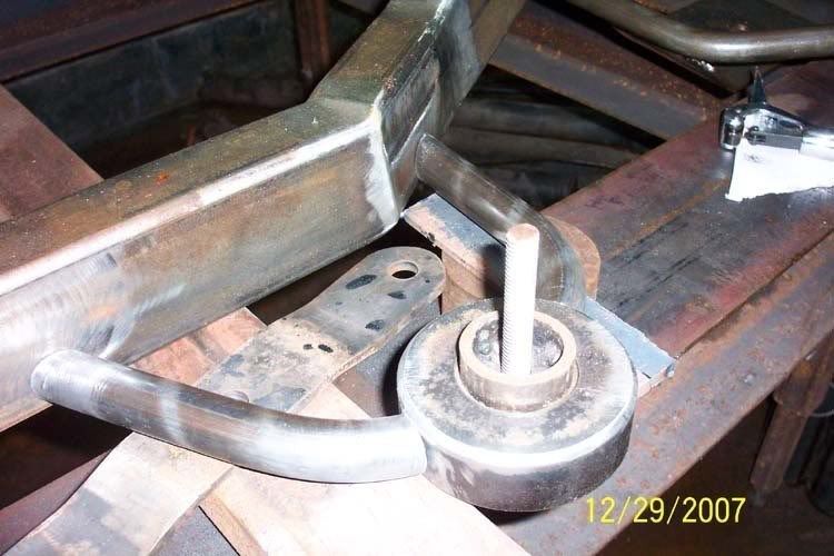

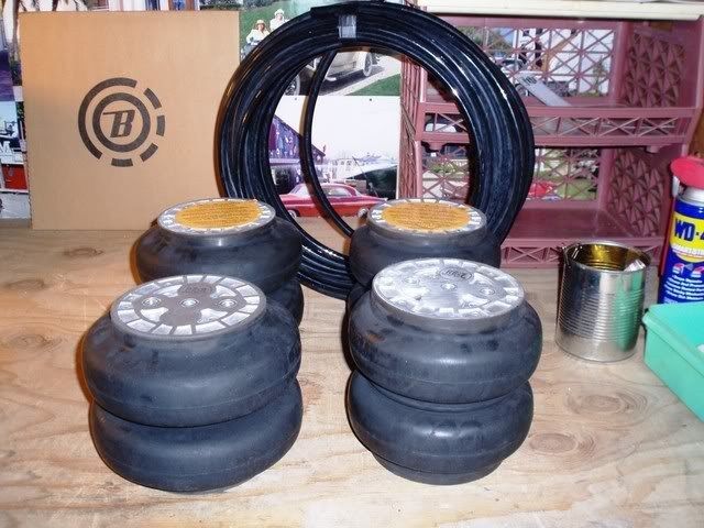

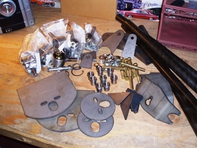

Parts Came In, All Courtesy Klean Kustoms
RE-7's up front, RE-8's in back, might go with hard lines, havent decided yet.

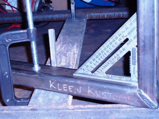

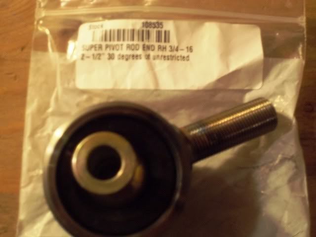

Triangulated 4-Link, All Super Pivot Rod Ends
30 Degrees of Unrestricted Motion

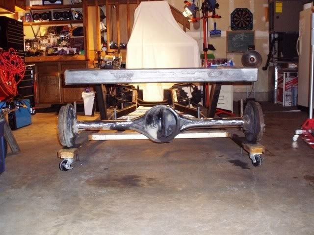

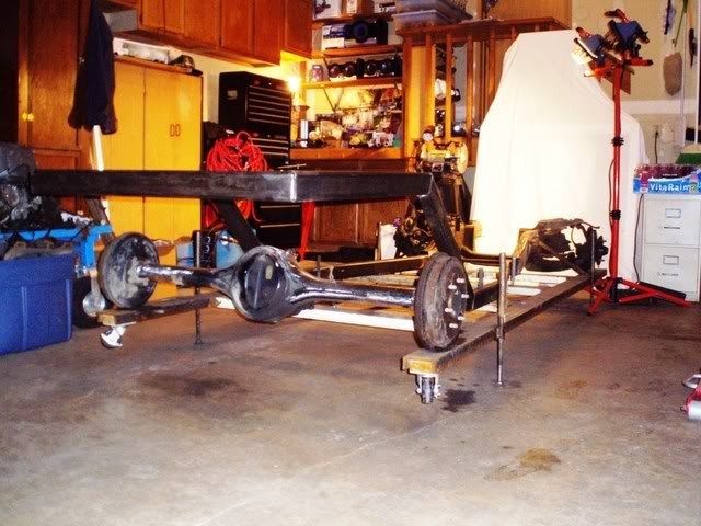

So I didnt like how the frame was coming out and how fuk*** huge the notch was so I tore the rails back apart and lengthed the lower section, chopped down the notch and shortened the upper rail. I got everything squared up and in place were I want it, now its onto the 4-Link this weekend.

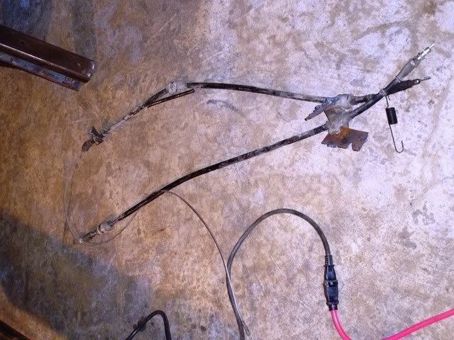

Who Needs an E-Brake

Lookin good bro. Why did you go with re-8's in the rear? And correct me if im wrong, but when runnin the bags on the bars (like it looks like your going to do)doesn't one end of the link have to have a poly bushing, so the bar doesn't roll? Just tryin to learn something here. Never the less badass, i was going to get an 84 Madzda like that for $400. But the dude never came through.
