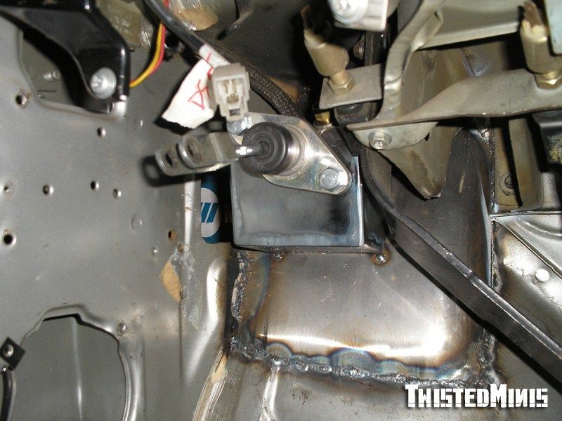

What are you guys doing to the clutch cylinder to make clearence for 20's on a 2002 nissan frontier? Does anyone know if a hardbody clutch cylinder will work? They bolt into the same location? Any help is appreciated!!

Put it under the dash.
DONTFRONT
Really? How does that work?
TwistedMinis's avatar
TwistedMinis
Clutch reservoir goes on the firewall.

Sweet pics thanks dude

the hardbody clutch master cylinder will work. u just have to adjust all the slack out of the pedal bc the cylinder rod is shorter than the factory one
