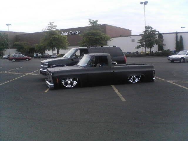

my friend jasons got 24s on his c-10not sure of the bs or width of rim but lays flat rocker stock hood

i would like to know about the process he went through in the front. if you dont mind would you see if he willing to give up what hes learned with the build.

when i lived in washington i got to see alot of this c10 its definatly one of the sickest out there def one of my favorites.
I DONT KNOW ABOUT THE SICKNESS BUT IT IS ONE OF MY FAVS ALSO!

Contact slamdblazer on here his name is josh He help do most of the work to that thing and he is usually very helpful!
