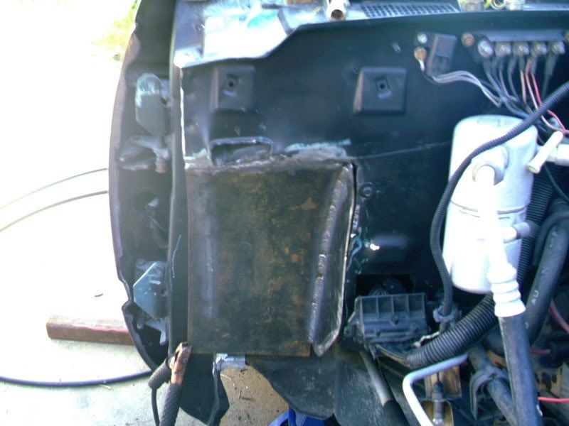

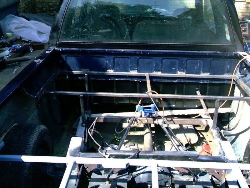

heres a 93 FSC me and my brother have been workin on. we have had it about 6 months and were finnalyy gettin some ok progress done. so far we have RE-body dropped the cab 3.5 inches,bagged the front to lasy out on 22s with a 265/35/22 tire,tubbed the firewall,relocated wire harness,dropped the core support,4 link the rear and bag it,new crossmembers in the rear part of the frame. now were workin on the bed,we are raisin the floor 7 inches to clear the notch and sheetmetallin it in the next few weeks.
this was how they body dropped it,which is why we re did it
i'll take some more pics here in a bit when i finish up the frame for the new bedfloor.

Now thats a quality body drop. shoulda used duct tape it would hold better. Good luck on the redo man hope it turns out good.
DougyFrisch's avatar
DougyFrisch
good luck... but i have to ask, why use a bunch of little pieces just to turn around and weld them to each other? get a large plate and start cuttin larger filler plates to weld in, it'll be cleaner and much safer
HarryBalls's avatar
HarryBalls
^^^ you didnt read the whole thing. Thats what they redid.

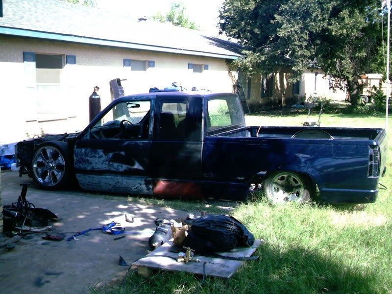

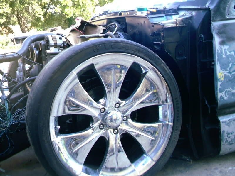

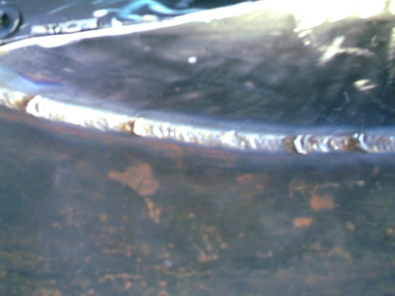

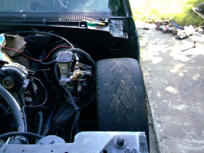

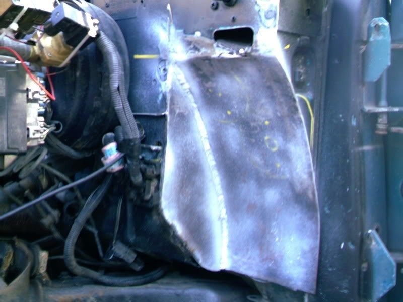

here we go. so far i have redone the body drop to the cab,lowered the core support down,relocated wire harnedd,tub the firewall for 22s,rebuilt the blower box,modded the LCA's to lay 22s,bagged the rear,4 link the rear,weld in a new crossmember.now im workin on body droppin the bed,raised it 7 inches so we could have compartments in it and have the fuel cell under it,i built the frame out of 1x1 box tubing and added some braces for support,still needs some more tho. bed frame all welded up and the bed is on the truck now(mocked up) i started on the bed mounts earlier,so hopefully bed will be bolted on tommorow. hers some pics
lo75lux's avatar
lo75lux
i also hand made the tubs cuz i dont like the ones suicide sells.out of 16ga sheetmetal
