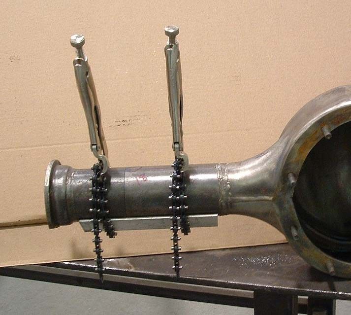

TwistedMinis's avatar
TwistedMinis
Then weld.
It works. I'd rather use a jig, but the materials for one are $$$. But that thing never had a problem.
TwistedGA
Seth's got it right if your trying to do it without building a jig. Welding this should be done extremely slow. Don't quinch it either..
dragginbagged's avatar
dragginbagged
Hey Seth, what was that housing cut with? It's perfect...
TwistedMinis
Band Saw. Water cooled one that was at a place I used to work at.
