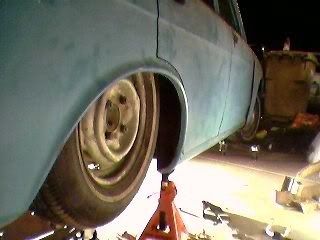

What we started with.

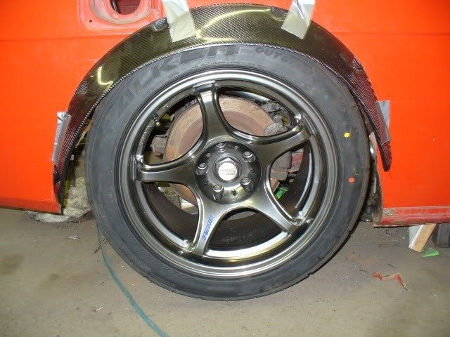

Stance before carbon flares. wheelwell is cut up 4". Also they are 17x10 BBS 3 piece meshies with some 285 tires
After flares

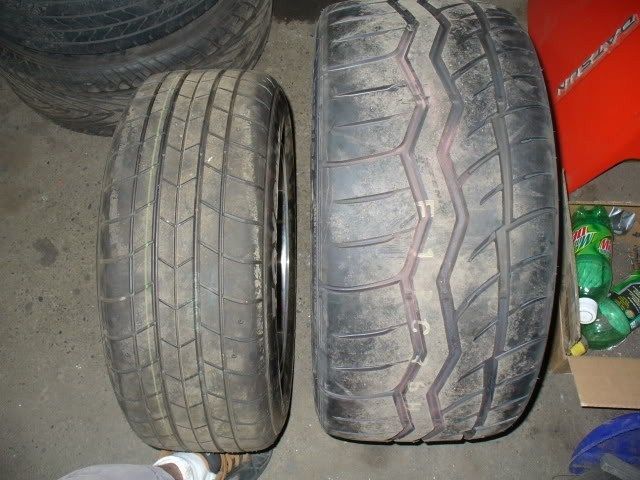

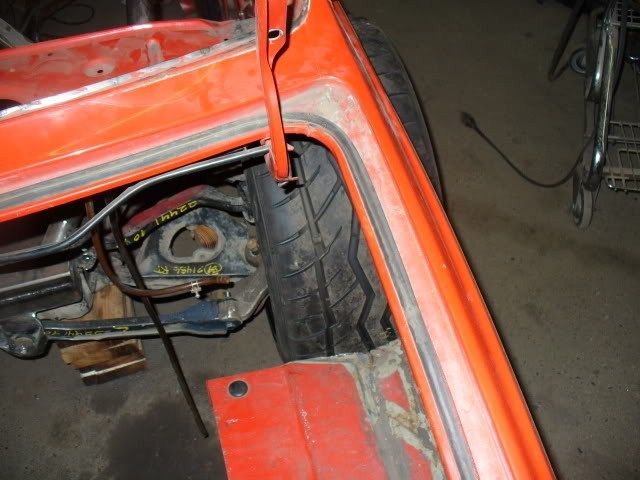

The rear wheels just showed up that were using. theyre 17x10 5zigen FN10R-C with 275/40zr17. ever seen a 40 series with that big of sidewall? had to cut almost 7" outta the quarterpanel.compared to the old wheels.started fitting in the parimeter front hoop, barely clears the top of the tire.
