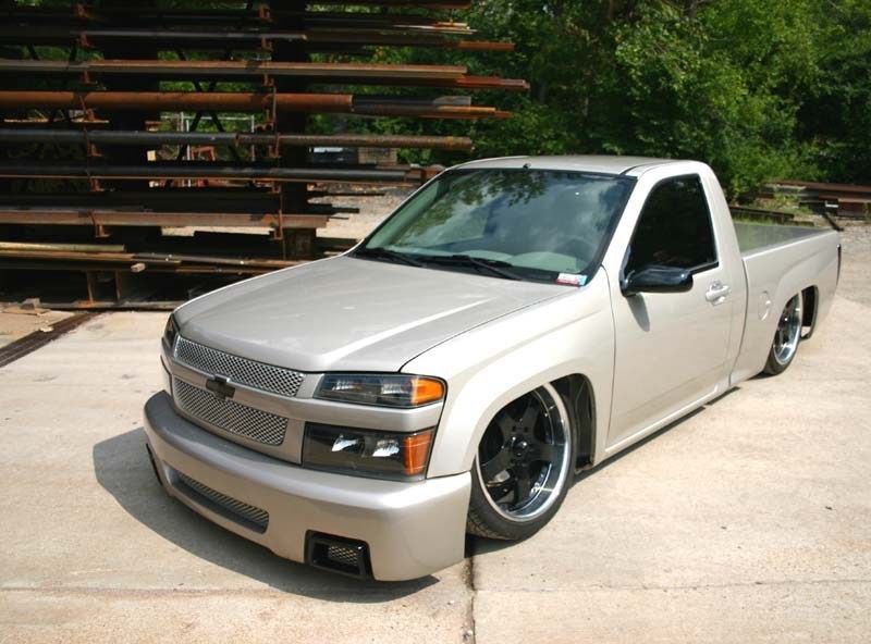

This truck is one our builds that has a +.25 20 x 8.5 and the rear axle was narrowed 4". It was a little tight in the front and I would like to see a +.30 on the next one we do.Go here :http://www.cleancutcreations.com/odarolocsyeroc.htmlFor the full build

On our black/red colorado the offset does not apply because we flared the bedsides because the parts were not available to narrow the rear when we built that one (dec'03) and the stock checy front suspension was swapped for a streetrod style mustang II (again because of parts availability and build time constraints).
