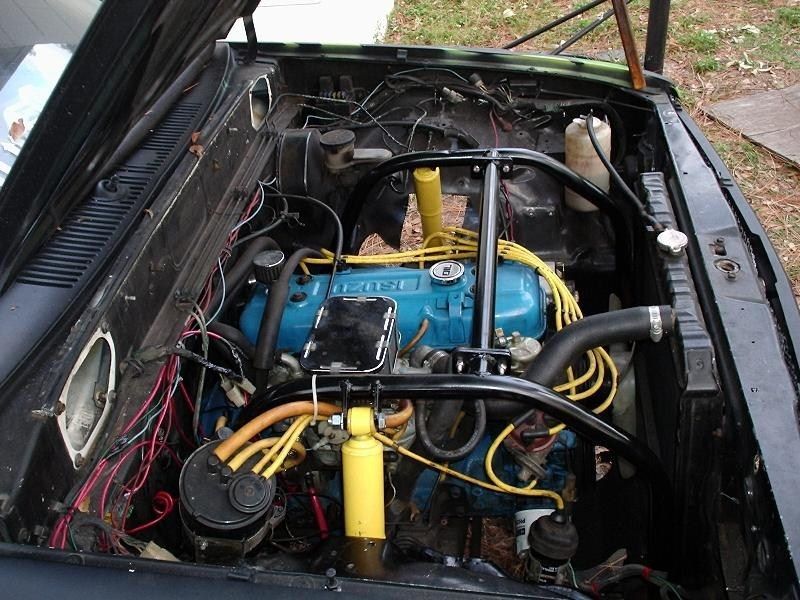

The way seth's is is how I'm going. Couldn't be any simpler and its clean

Originally posted by TwistedMinis
Sweet truck dude! Eventually I'll have to get some fab work done like you did on your truck but that wont be for a while Thanks for posting your pic
