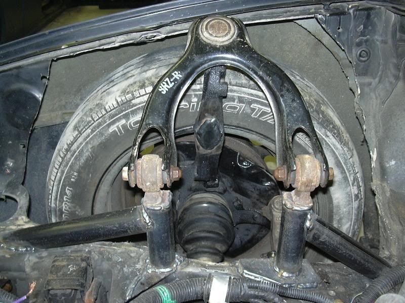

Does anybody know how he mounted his uppers cause the towers are gone, this is what im doing but with air bags
cuzican's avatar
cuzican
looks like they are mounted to under side of the support cage that they built.

flatnbaggedcivic's avatar
flatnbaggedcivic
i dont know how to post pics yet but i flipped the bushings around so the bolt was facing down and welded it to a peice of pipe and that to my frame. You'll be able to see it when they approve my pics

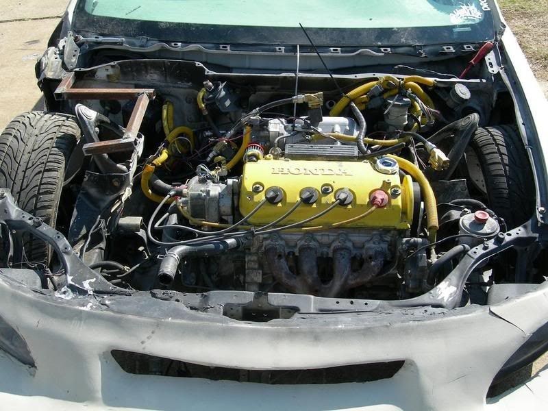

choppedcivic98's avatar
choppedcivic98
Originally posted by flatnbagged95
i hope my pics help i have a lil more work to do on the front but it's almost done... I wish i new how to post pics up here, just check my profile
This pic helped me out alot
