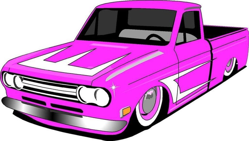

here is a 521 Just whipped up.....Cool Lil rendering...I just liked the way it looked
