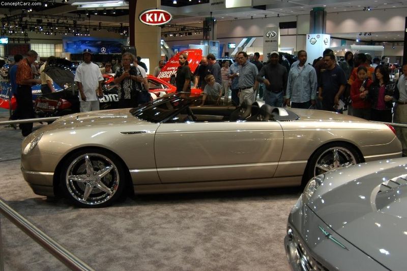

krazeryn
Here is an '03 built by Foose:
Psycopath's avatar
Psycopath
i looked into the speedbird rims already, foose (mht) only makes them in 20" which doesnt have enough tire for my dad, which is why he would like a 19 or 18.
not only that they want like $900 a rim or somethin?
