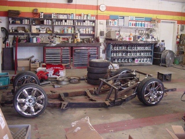

The truck is a datsun 521, im building one right now. They are fairly simple to bag, just a basic torsion bar setup. Same as a mazda, or toyota, or nissan just a little smaller. If you have any questions feel free to ask me. Heres a pic of mine in the current state its in, it should be done by next show season:

thanks for your post. your frame is lookin sweet thus far. what wheels are those and what size are they? i had a Ranger before, so i'm not real familiar with torsion bar setups. i've seen a couple with SBCs in them, is there a lot of work needed to stuff one of those in?

The wheels are 18x8 Infiniti QX56's. A small block wouldnt be to hard, just a lot of cutting on the firewall, and making a huge tranny hump. I would do a small block, but i totally screws the handling and the weight distibution of the truck. Im going to do a SR20DET or a CA18DET turbo motor to stay inside the nissan family.
