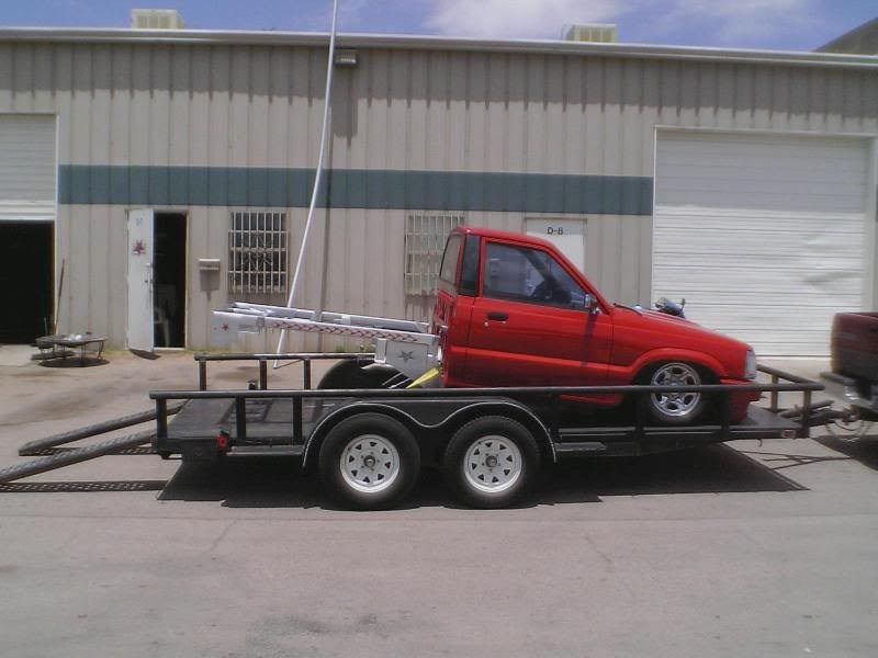

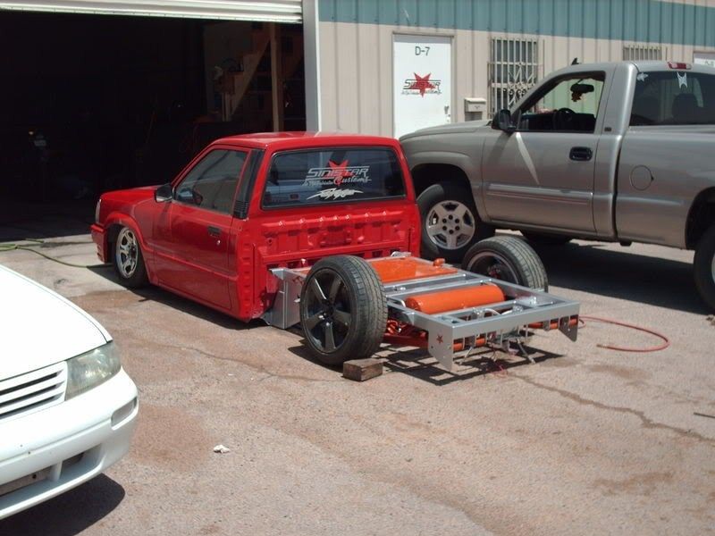

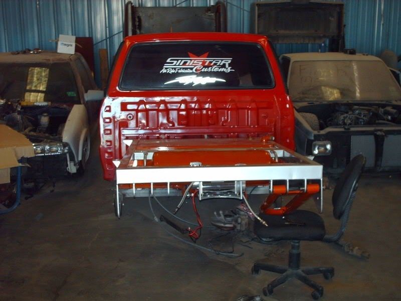

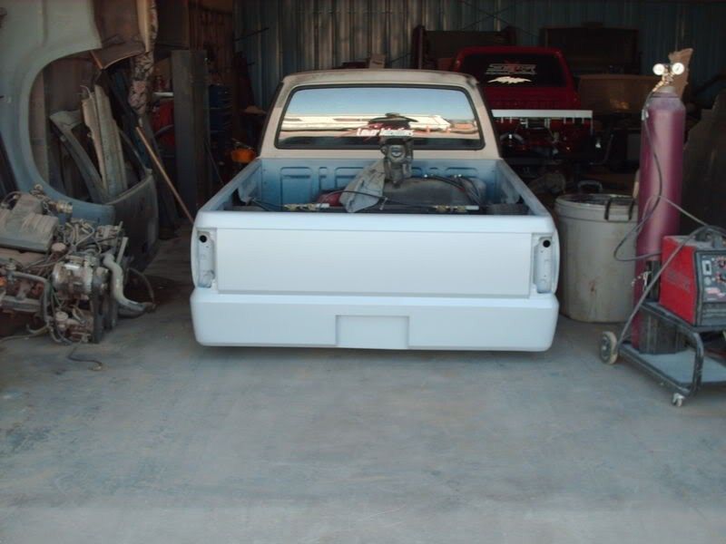

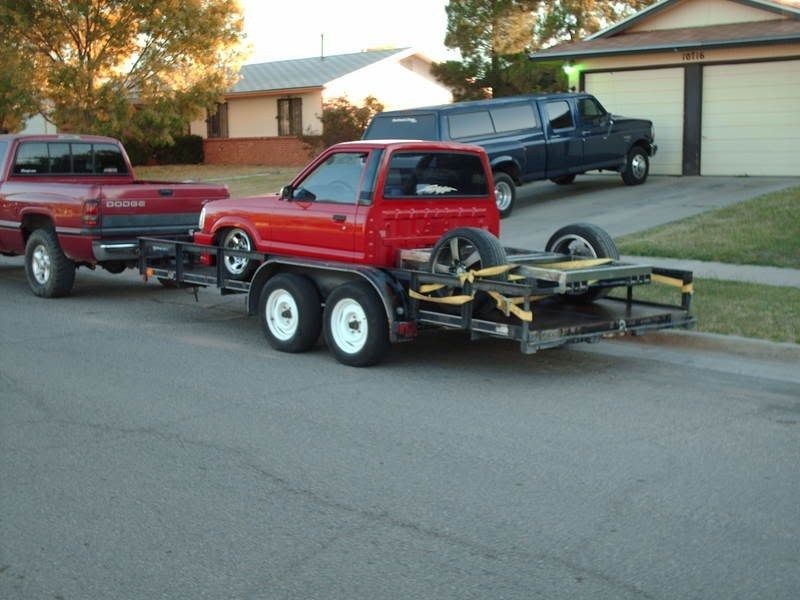

Me and a couple of the guys in the club went in on a shop so hopefully now we can all finish something. Heres some pics of our projects, Ill post some more pics as we get stuff done.
TwistedMinis's avatar
TwistedMinis
That Mazda is sick.

i want to see more of that mazda i want to do a 240 rear end

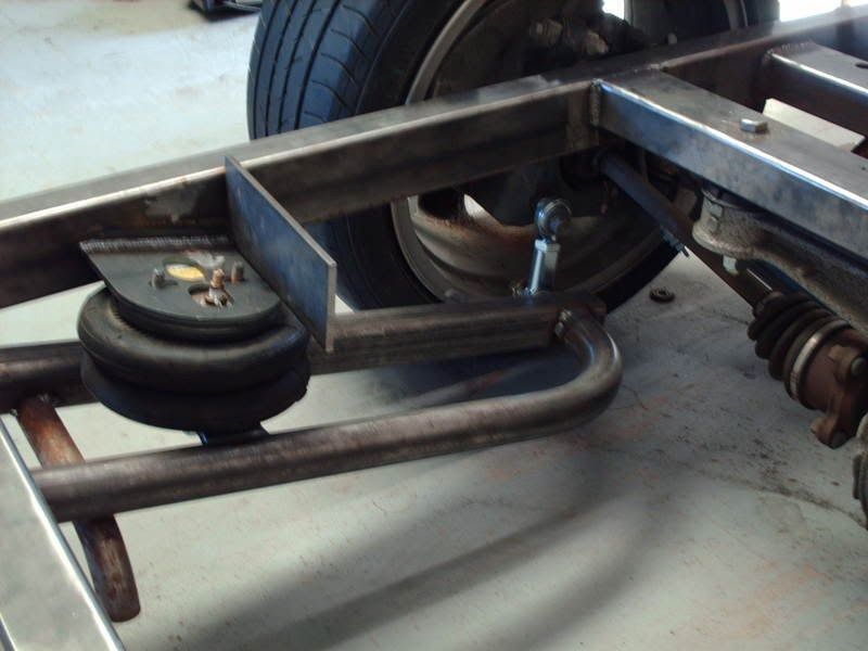

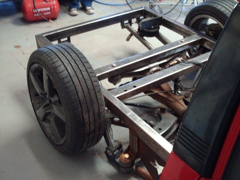

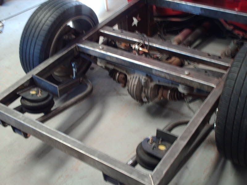

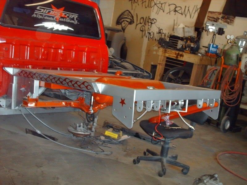

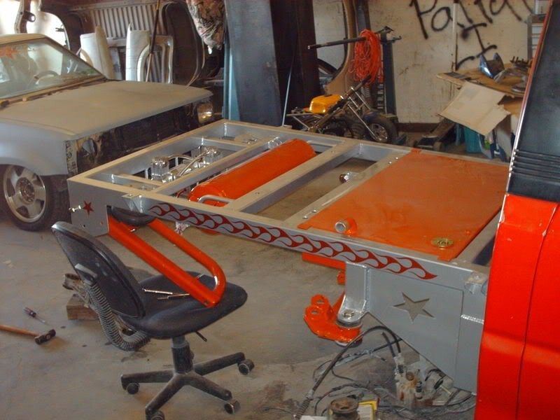

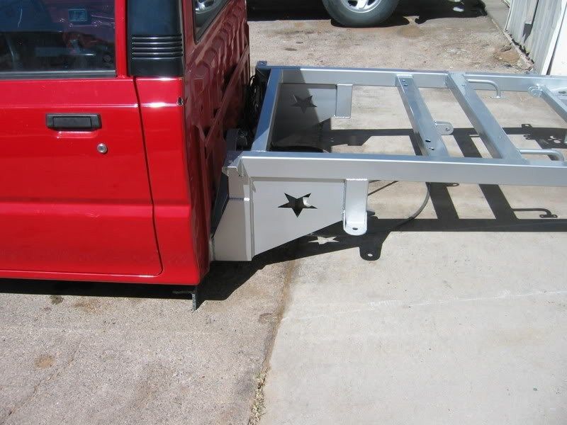

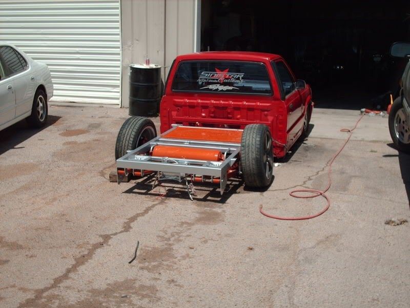

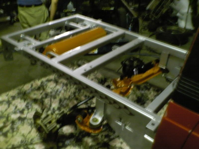

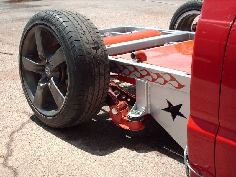

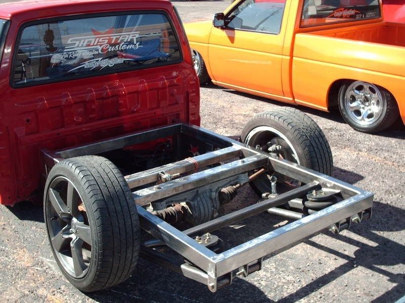

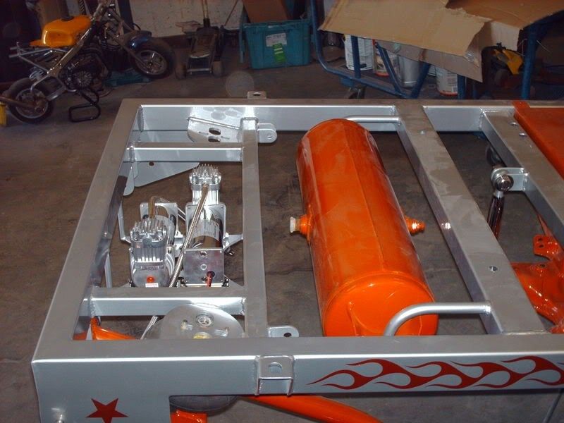

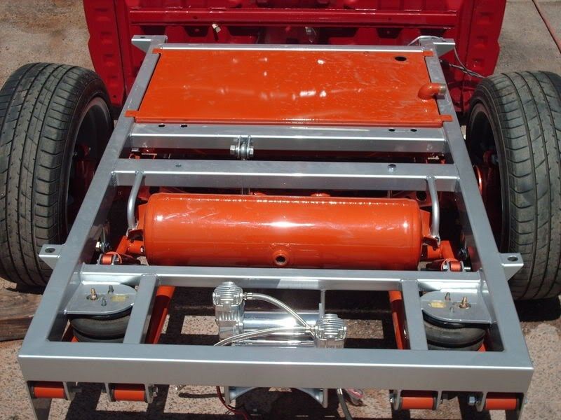

Finally got a little more done to my Mazda this weekend. The original bag mounts wouldnt work so I built some arms with heims on the ends so they dont bind.Kinda like a 6Link. Got some temporary gussets and stuff in there just to make sure it lifted and didnt bind up.

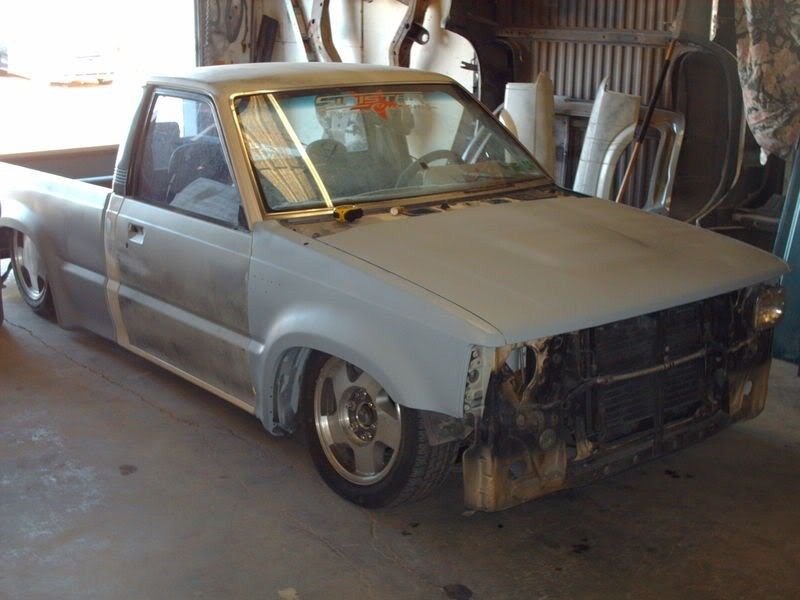

I like the mazda, looks like it will be a great ride. On the s10 though, it looks like the body drop is welded to where the trim is, how yall going to put the interior back in?
