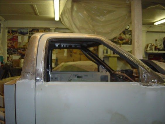

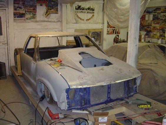

bdydrp18's avatar
bdydrp18
i like the layed back windshield. made my truck look very proportional, but that is because of the 8" bodydrop
Wow!! 2 1/4" chop mixed with an 8" traditional body drop to the doors...Are you sure you are gonna be able to drive this? Are you a Midgit? LOL!!!The work looks great so far and I can't wait to see this done!
