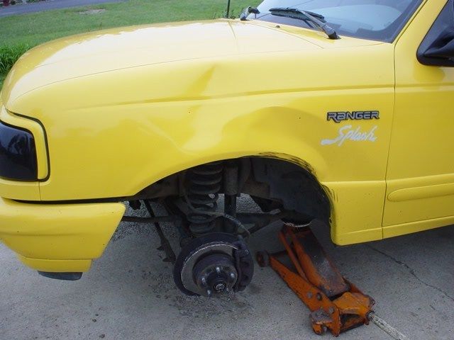

hey guys im trying to sell me stock 17's off my 05 GT and someone emailed me asking what would need to be done for them to fit on there ranger, i remember hearing you had to do something on the 04- mustang wheels for them to work on a ranger but what if anything would we run into putting the 05 mustang wheels on a ranger?

05-06 mustangs are high positive offset, different than the 04's which were low positive offset, so you will likely need a big spacer to have those wheels fit a ranger.
Likely the 04's didnt fit over the ranger front hub because it is huge, so they would have used a spacer there too. But you'll need a much bigger one for the 05's, at least an inch.

only thing i recommend is make sure the centerbore of the wheels are big enough and that they seat well on the hubs.
