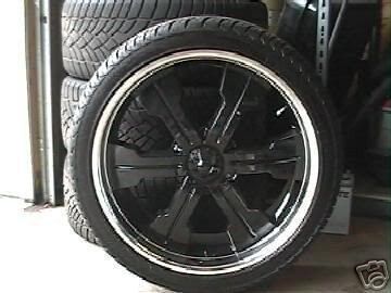

i have some black 1s old ebay link... shoot me an offer
