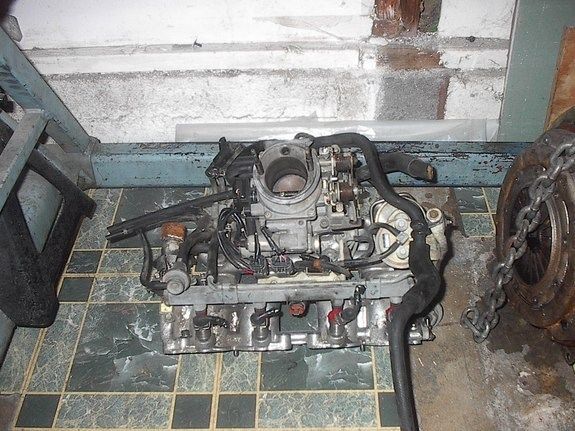

Here's a pic of the truck KA intake..... For sale if anyone needs it.
