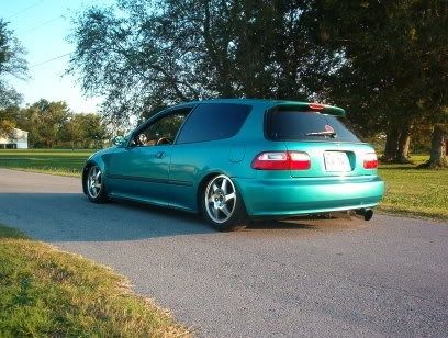

its the upper control arm hitting the strut tower. this is how mine sat on coilovers after i cut a small hole in the strut tower just big enough for the outer edge of the control arn to come through maybe 3 inched in diameter.
