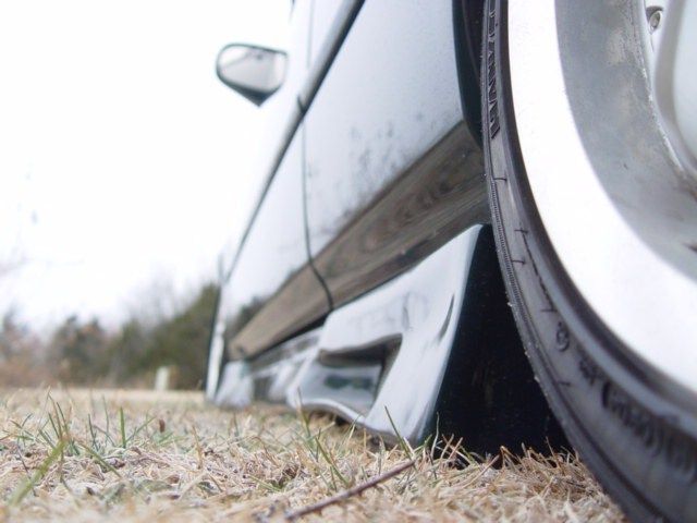

i got cylinders on mine and it ride nice,but i had to do alot of work to get it as low as i go t it right now,it lays in the front,on 14'z,it about 1 higher when i got my 18'z on ,check my profile
