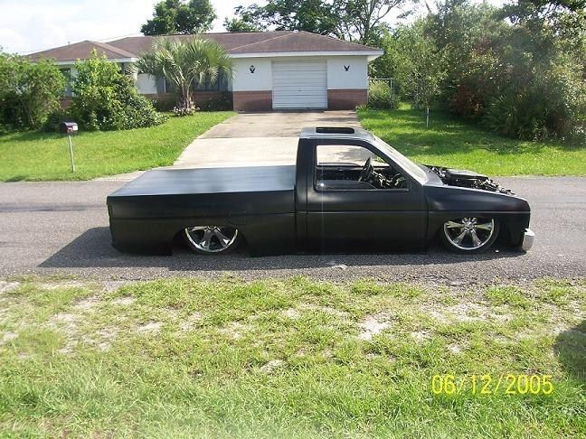

Hello everyone. I now have 17's on my 95 HB. I will be adding more Cnotch and redoing the front end. I have 4x4 front fenders. What I was wondering is want size wheels and tires will work so I can still Layout on 20's

94nissanlay'sdoor is cool I got a 2 3/4'' BD and layout on 17's. Not too sure is I want to SFBD it also. 8'' is a whole hella lot of BD.
Now I know his is a 94 and mines a 95 but do he channel the truck to get the doors so dang close to the ground.
And heres mine

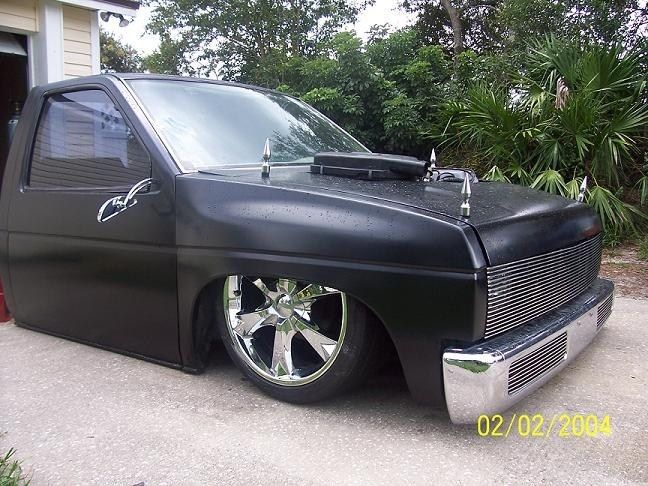

Just look at 94nissanlay'sdoor truck. Look at the pic where he has the hood open. Looks like he still has 2-4" to the hood if he didnt have the fenders in there. Just find out his tire size, then put that into a tire calculator and then put in some 20" tire sizes and im sure you can figure out if it'll fit. If you got his tire size I'll even do it.
