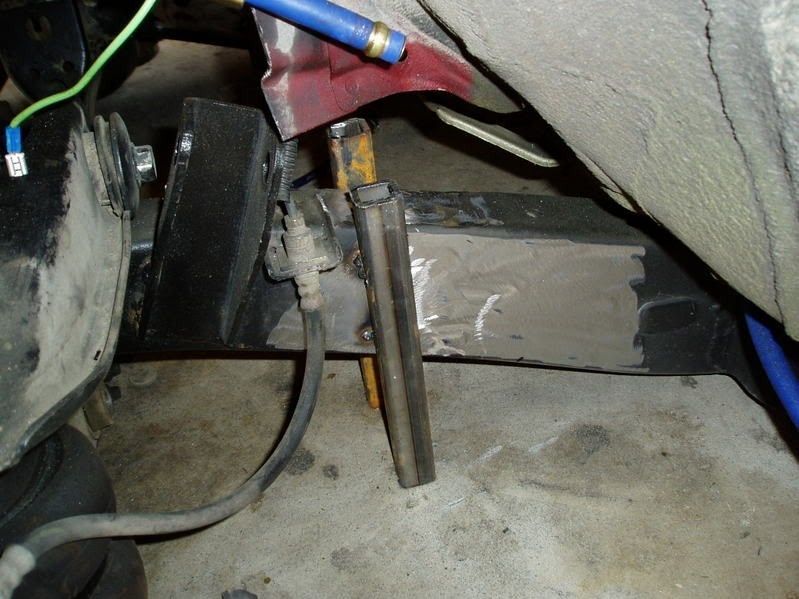

shortrodeo
Heres a pic for reference. 2" Z

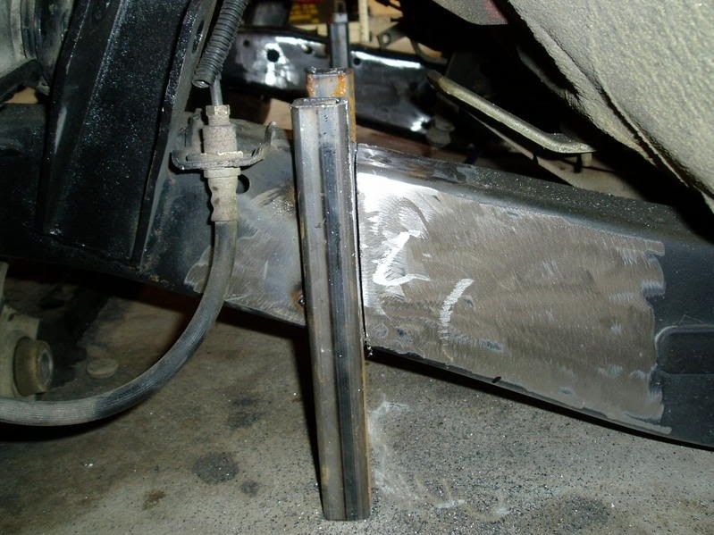

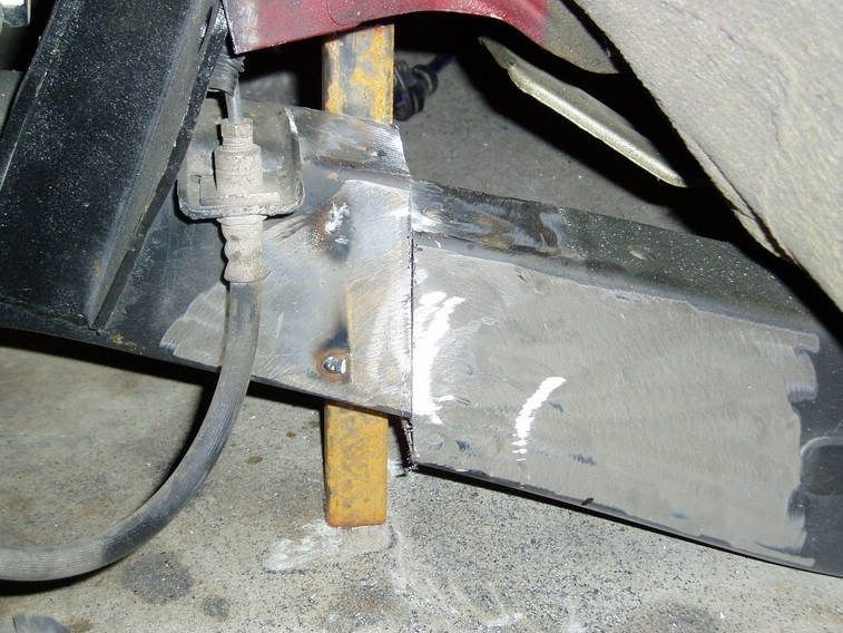

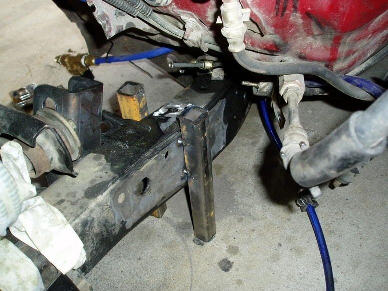

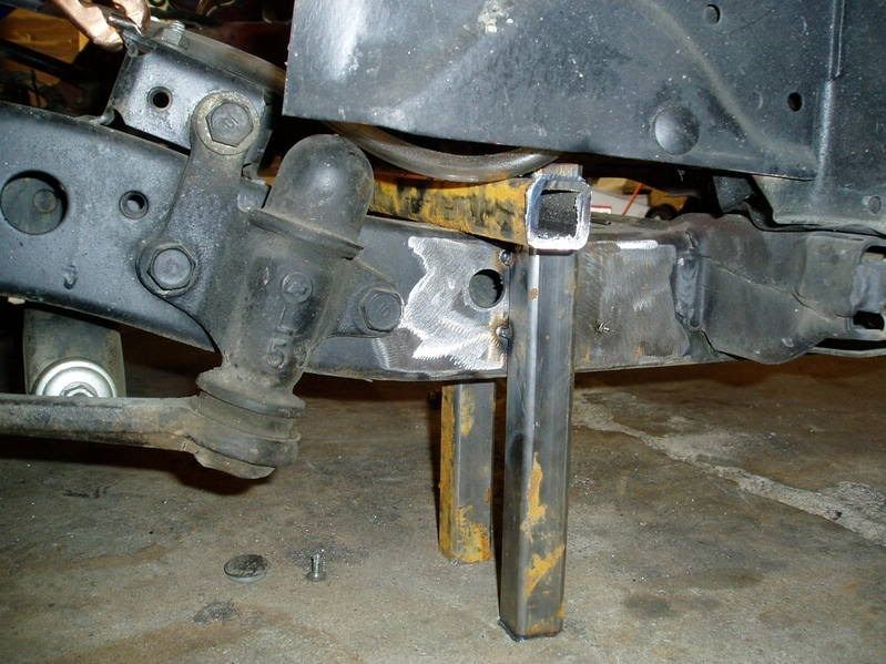

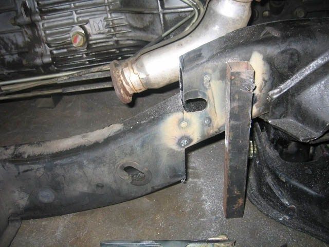

time1's avatar
time1
heres those pics hope they help!
